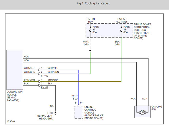

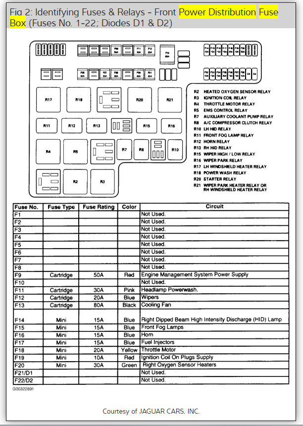

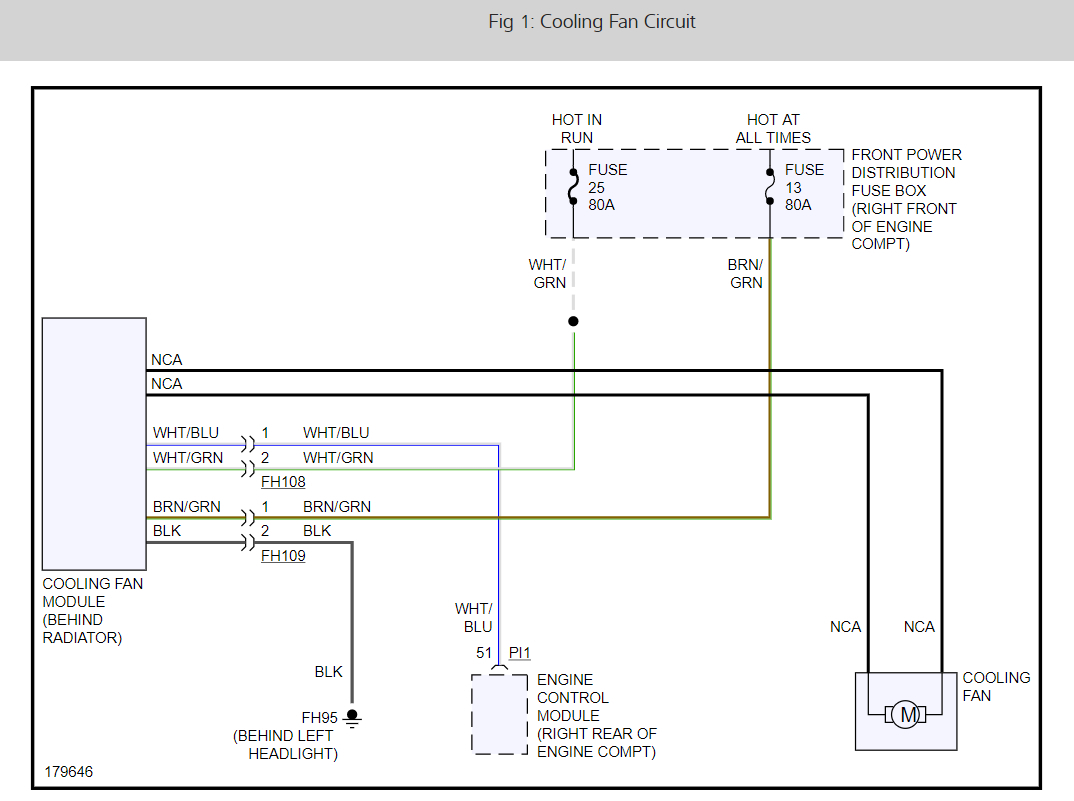

my 2003 S type seems to run hot at idle. I took it for a 2 hour drive on the highway and the temp guage was at the halfway mark the whole ride. When I finally stopped and let it idle the tempature rose and the engine temp warning came on. I do not see any leaks. I don't notice any change in performance and the oil is not milky. The water pump and thermostat were replaced 6 months ago. I cant see or hear if the cooling fan is coming on or not because of it's location. The fuses look ok and the relay and fuse for the cooling fan appear to be ok but I have not tested them. (replaced the fuses). Outside tempature is roughly 65 degrees.
Any suggestions/diagnosis?
