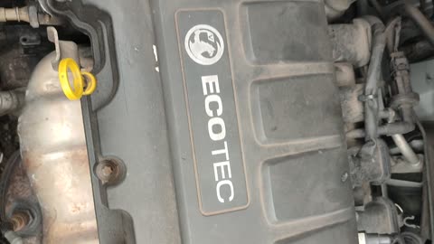

I checked that the engine oil is okay.
To open the sparkplugs I didn't have tools .
I feel like from when I changed the thermostat the temperature is staying very high before when I was driving smooth the temperature was going down and when stuck in traffic it was high like now.
From some time there is a whistling sound coming from the engine as well.
My mechanic already changed the belt and belt tensioner but I realized it now that the whistling sound comes from the engine because I tested it today with a water pipe to hear exactly where the noise is coming from.

Can you please shoot a quick video with your phone so I can hear the noise? That way I can tell for sure what's going on.. You can upload it here with your response.

I am uploading the video you asked for.
May 25, 2023 at 11:33 AM
I noticed it has been three days since we heard from you. Have you been able to make any progress? I'm not sure if Ken listened to the video yet, but I'm not hearing a whistling.

So, what's the weird sound is coming from the engine?
May 29, 2023 at 1:04 AM
I'm not hearing a strange noise. I did notice a tick, but that was it. By chance, do you hear the sound in the video? I may be missing it.
