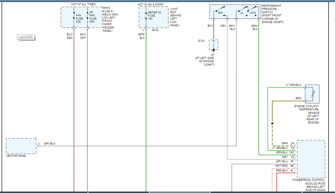

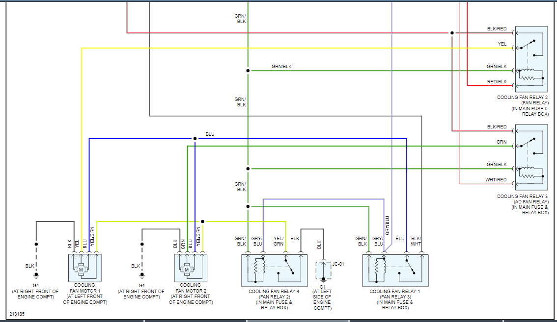

it only comes on when I switch on the A/C. I replaced the temperature sensor, relay and fuse but still has come on. I checked all necessary wiring and connections and all good. what is the problem here?
