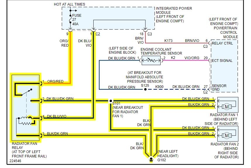

I attached a wiring diagram for you. We need to check the relay for power from the fuse block and the module.

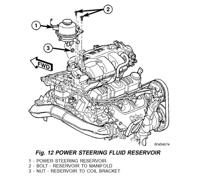

Fig. 12 POWER STEERING FLUID RESERVOIR
2. Remove power steering reservoir and relocate (Fig. 12). Do not disconnect hoses.

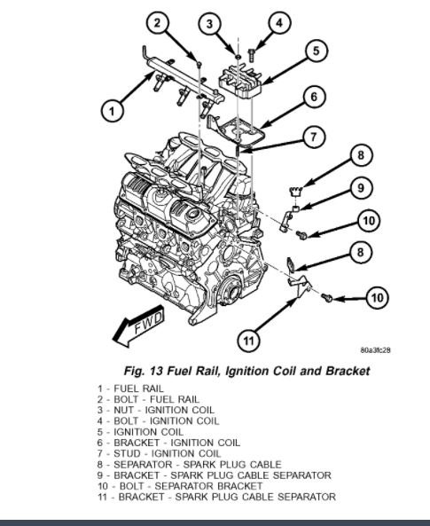

Fig. 13 Fuel Rail, Ignition Coil and Bracket
3. Remove ignition coil and bracket (Fig. 13).

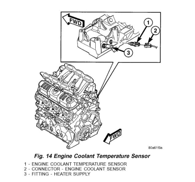

Fig. 14 Engine Coolant Temperature Sensor
4. Disconnect coolant sensor electrical connector (Fig. 14).
5. Remove coolant sensor (Fig. 14).
