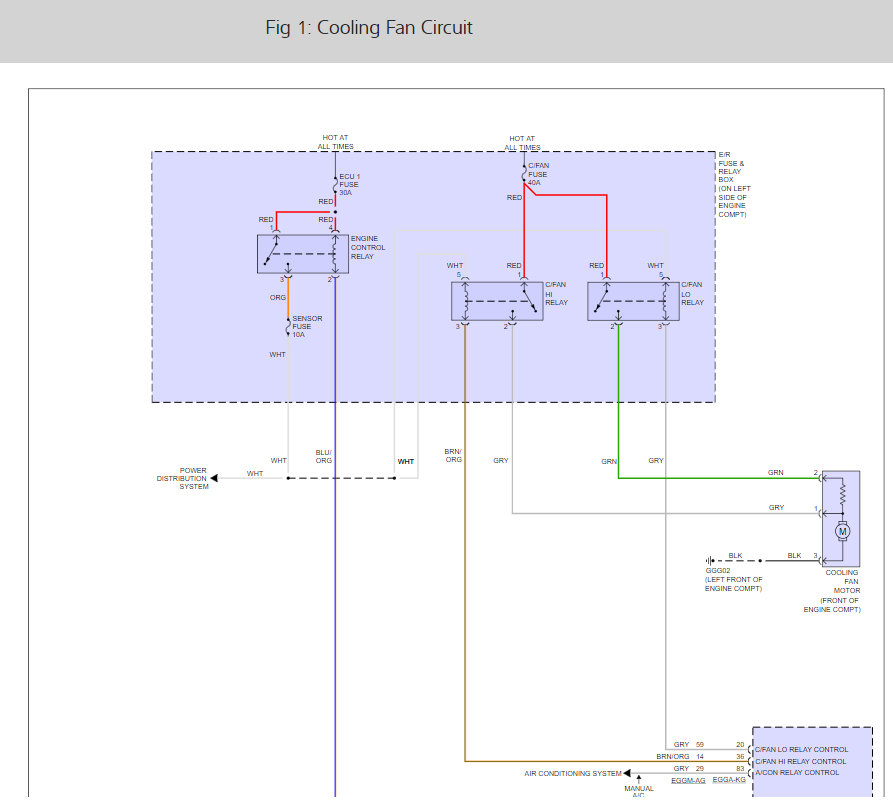

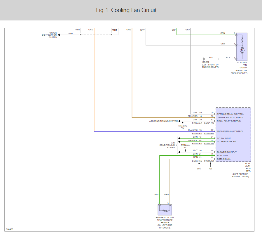

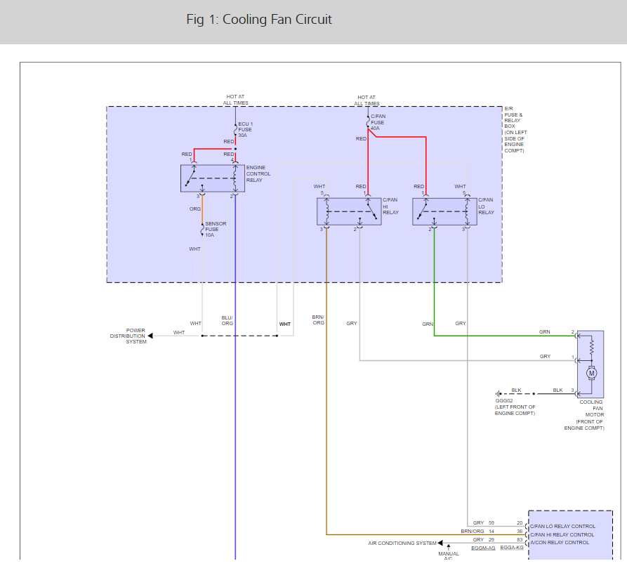

There are two relays that run the system you should test both. Here is a guide to help and the wiring diagrams to help you see how the system works. There is the fan motor, temperature sensor, relays and PCM.

It sounds like sensor fuse 10 is out. Can you check it? Also, if you checked the wiring and everything is good I would say the PCM driver that runs the fans is out which happens. Here is the location of the PCM you will need to have it programmed at a shop which should run about $130.00 US.
