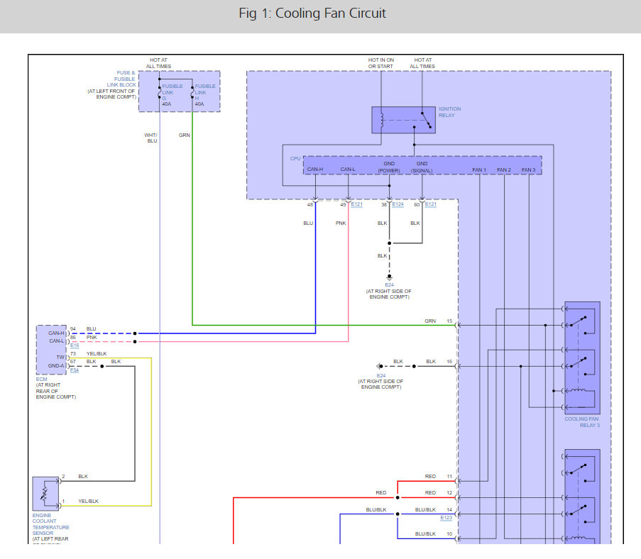

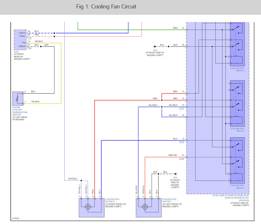

Well, even after adding the coolant, the engine temperature fluctuates between the middle and hot. I have shown a mechanic, he says there is a problem in the radiator fan, and it needs to be replaced. According to him, the fan turns on and off only when a/c is turned on, otherwise it does not work. Is it a wiring problem or does the fan need to be replaced?
Jul 7, 2022 at 7:00 PM
Is there more than one fan motor? Here is a wiring diagram I found for the cooling fans and it shows two fan motors?
