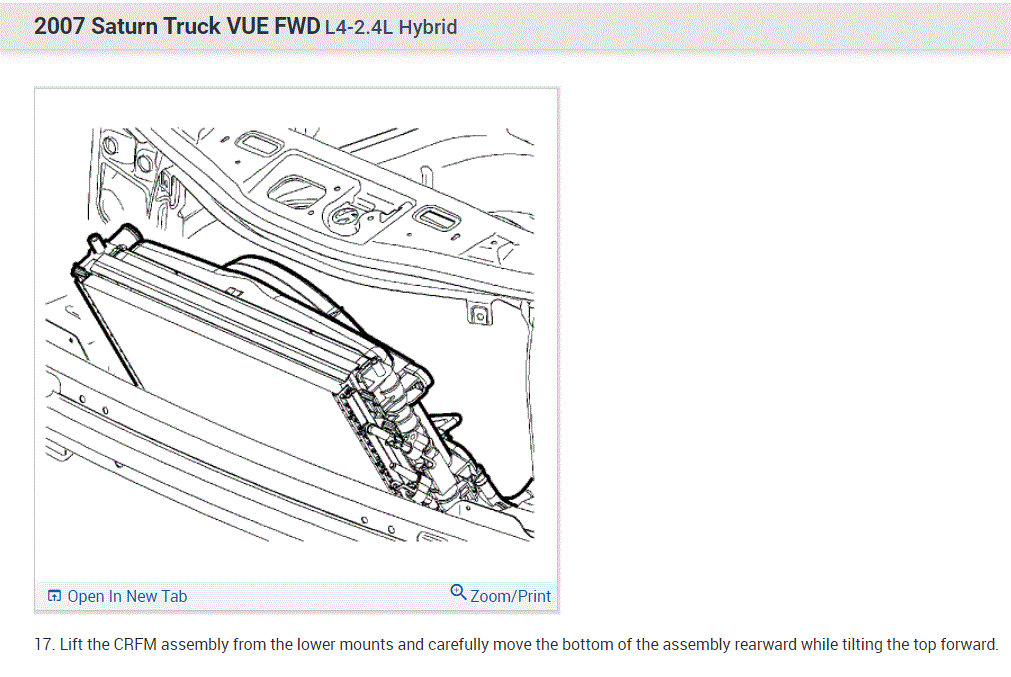

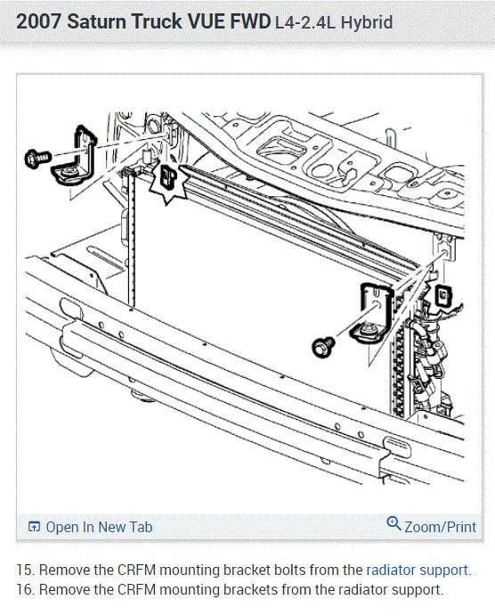

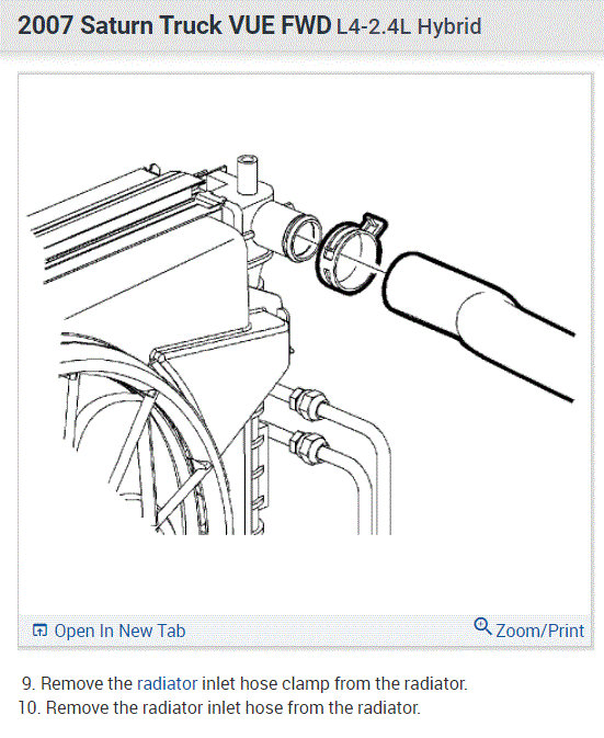

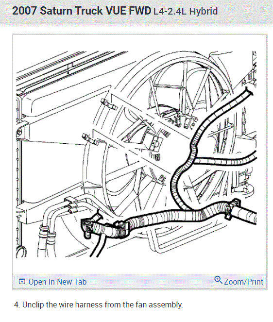

My cooling fan is making a horrible noise and needs to be replaced. How do you get that fan assembly out? from the top or the bottom? I can't find a video that shows the remove and replacement procedure. Anybody changed one of these?.
Jun 7, 2021 at 8:57 PM

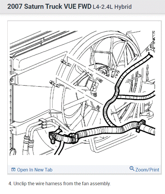

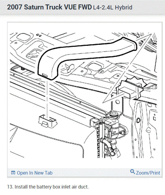

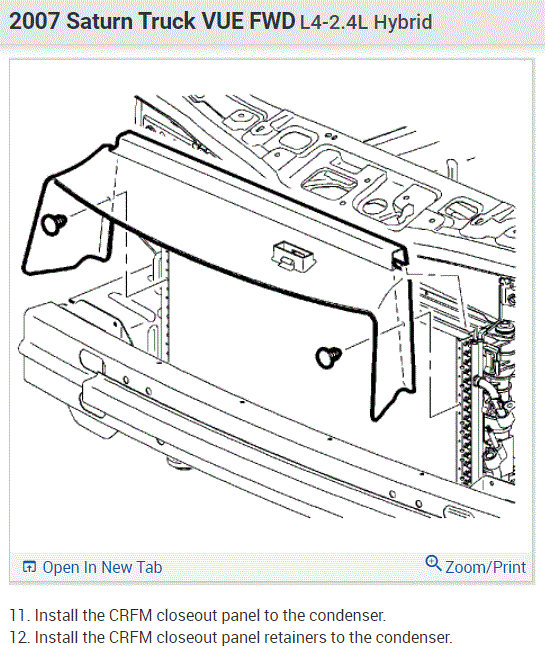

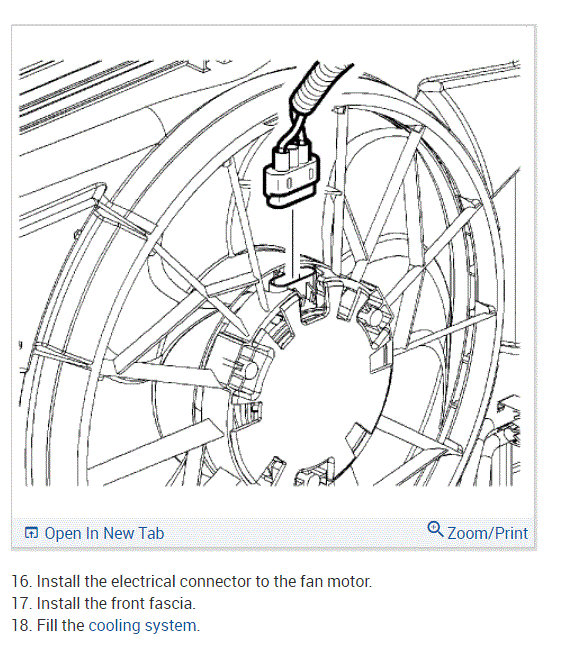

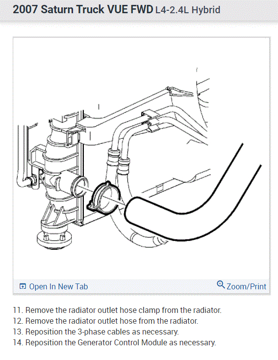

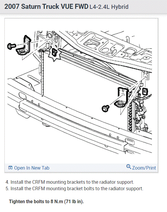

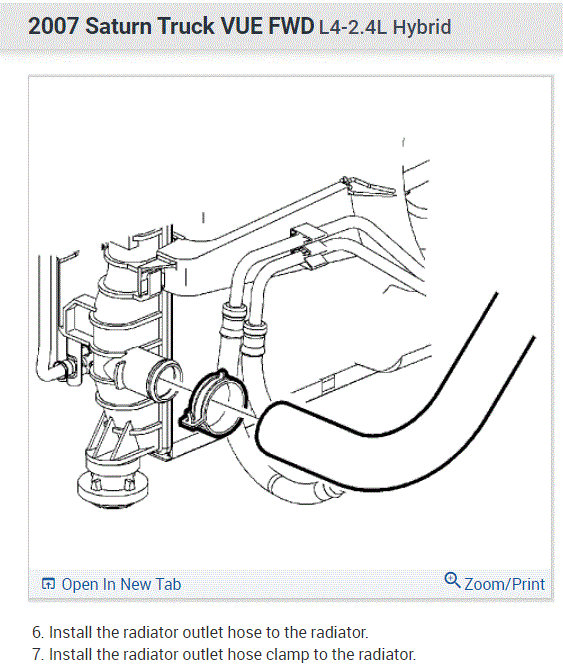

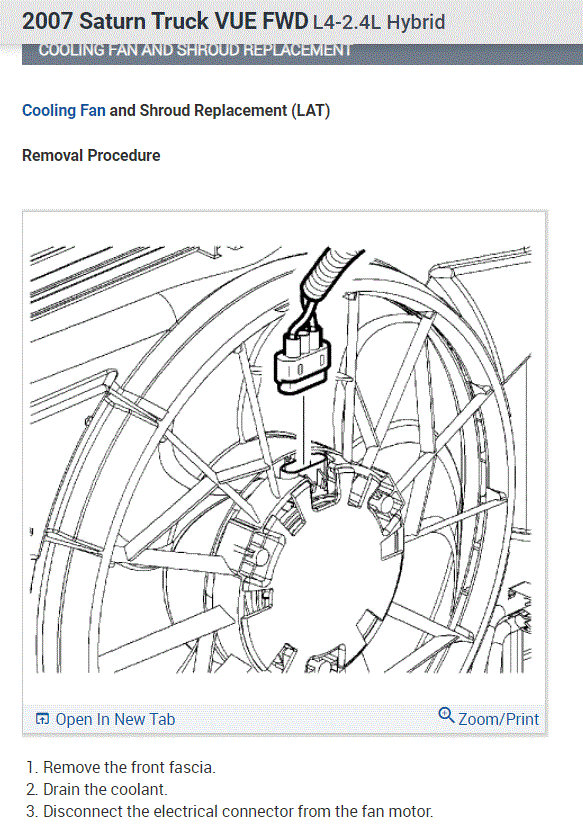

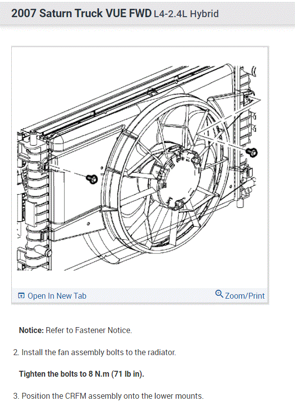

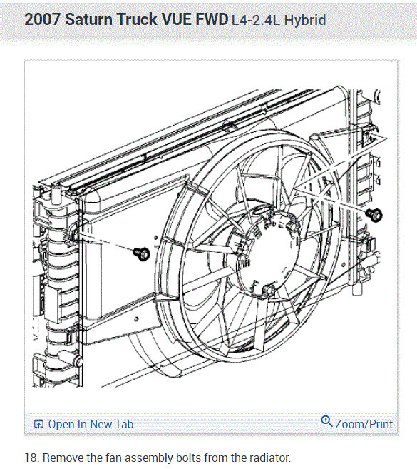

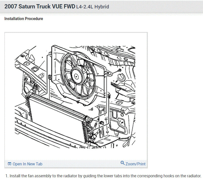

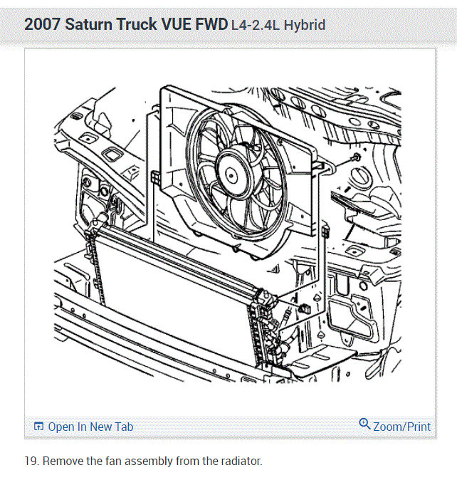

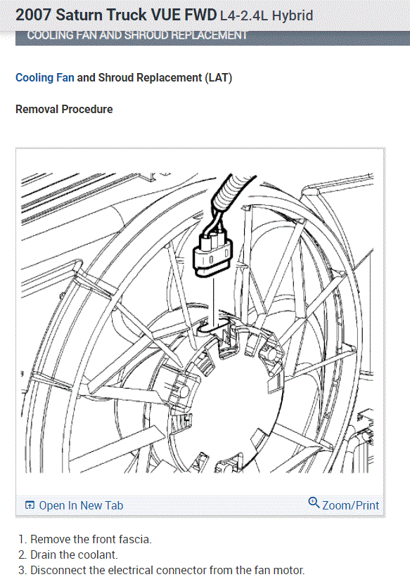

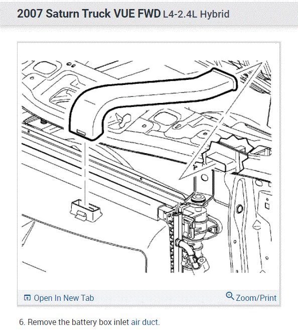

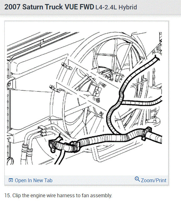

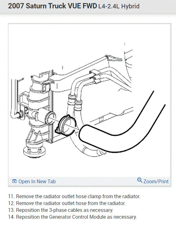

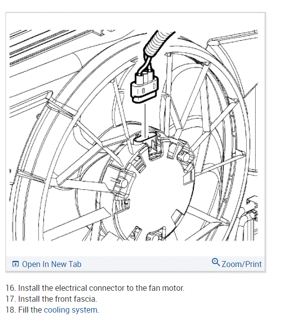

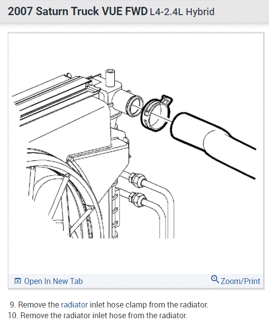

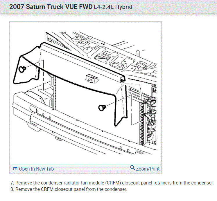

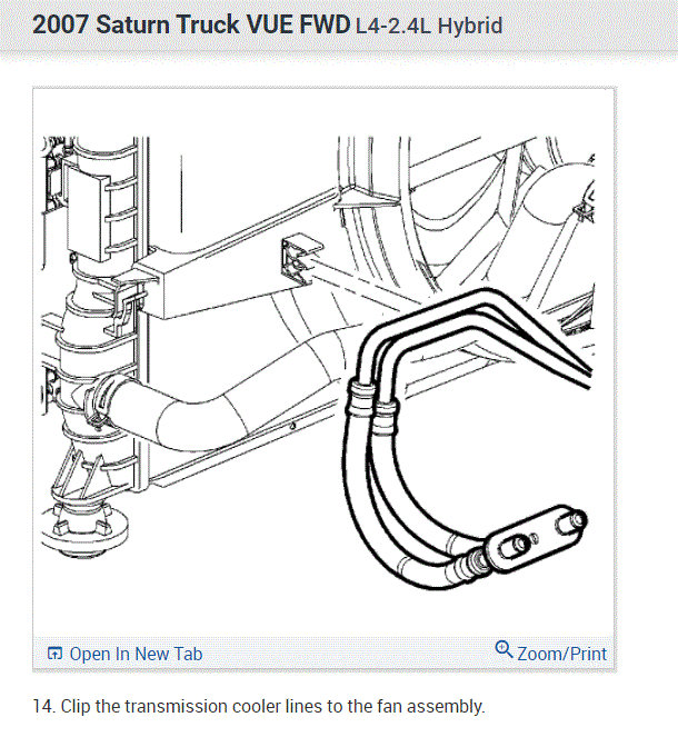

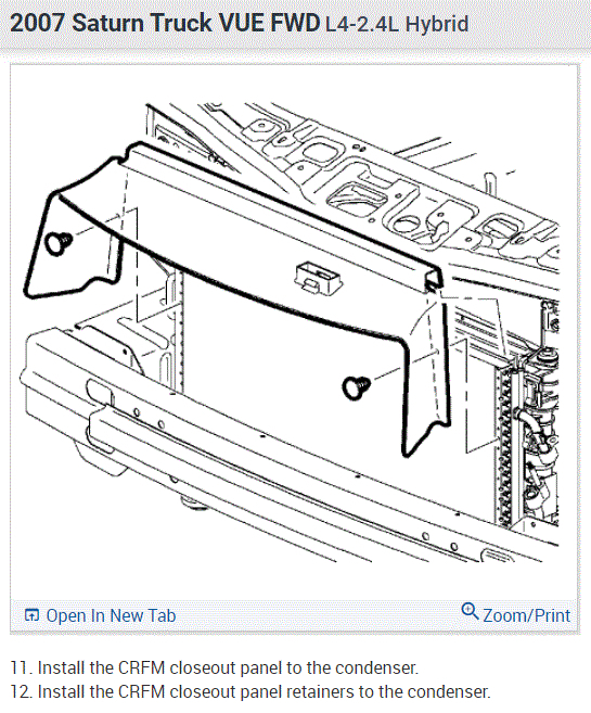

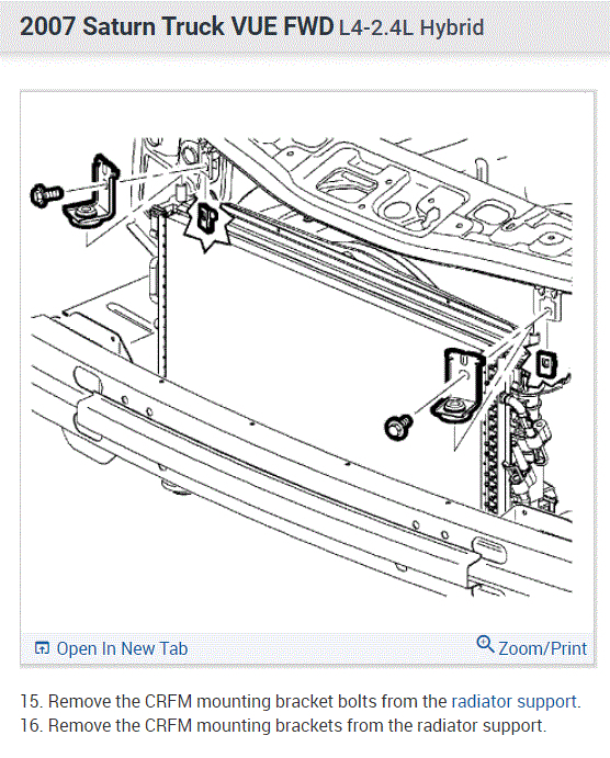

The fan assembly will be removed through the top of the vehicle. I attached the directions specific to your vehicle for the fan motor and shroud replacement.
The process is somewhat more than I expected. Do me a favor. Before you remove everything they suggest, see if you can access the bolts holding just the fan motor in place. If you can just remove it, you shouldn't have to remove everything listed.
See pics below.
