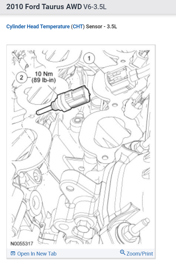

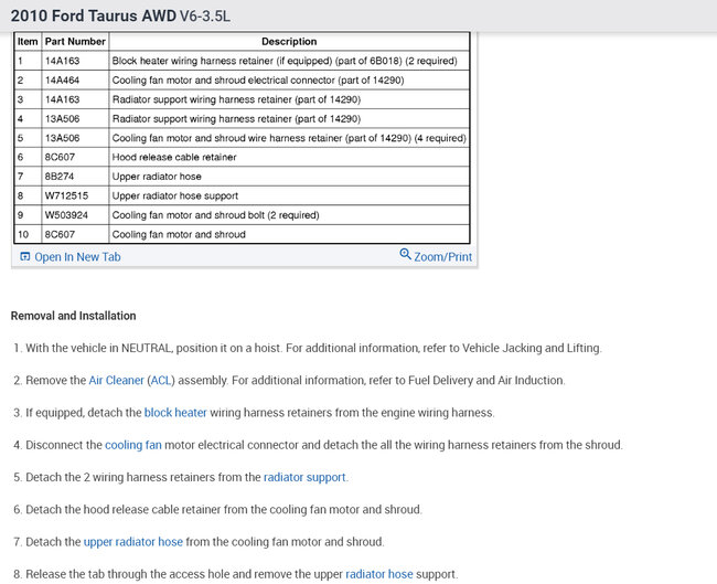

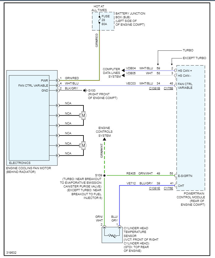

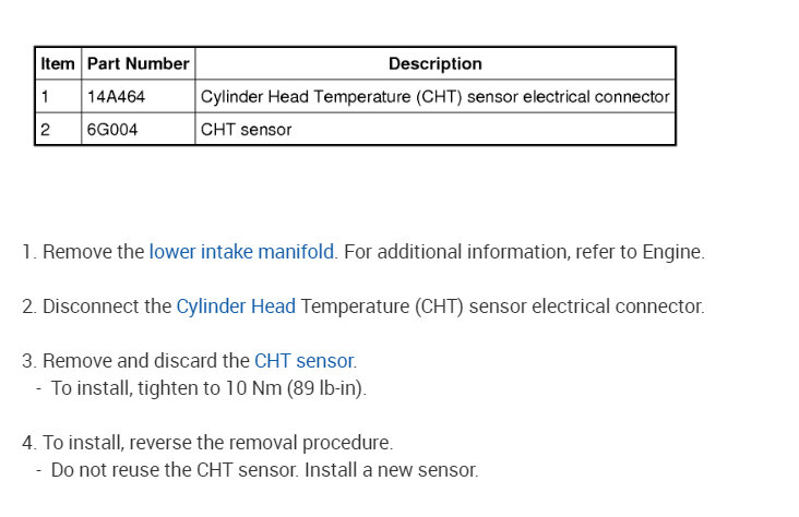

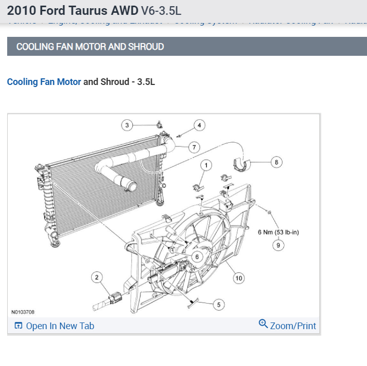

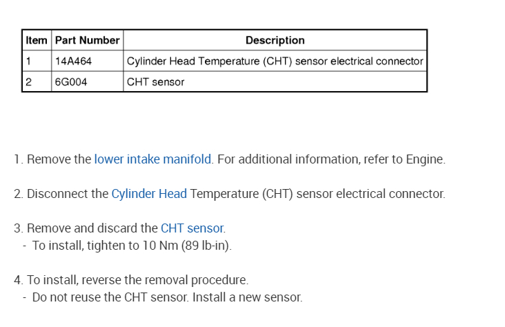

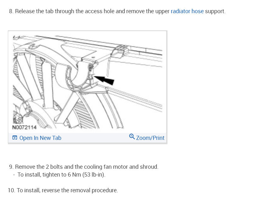

The first thing I would do is change out the cooling fan motor-module, and if that is not helping the engine coolant temperature sensor. Here are the cooling fan wiring diagrams so you can see how the system works and the sensor location and how to change out the fan module as well. Check out the images (below). Let us know what happens and please upload pictures or videos of the problem so we can see what's going on.
