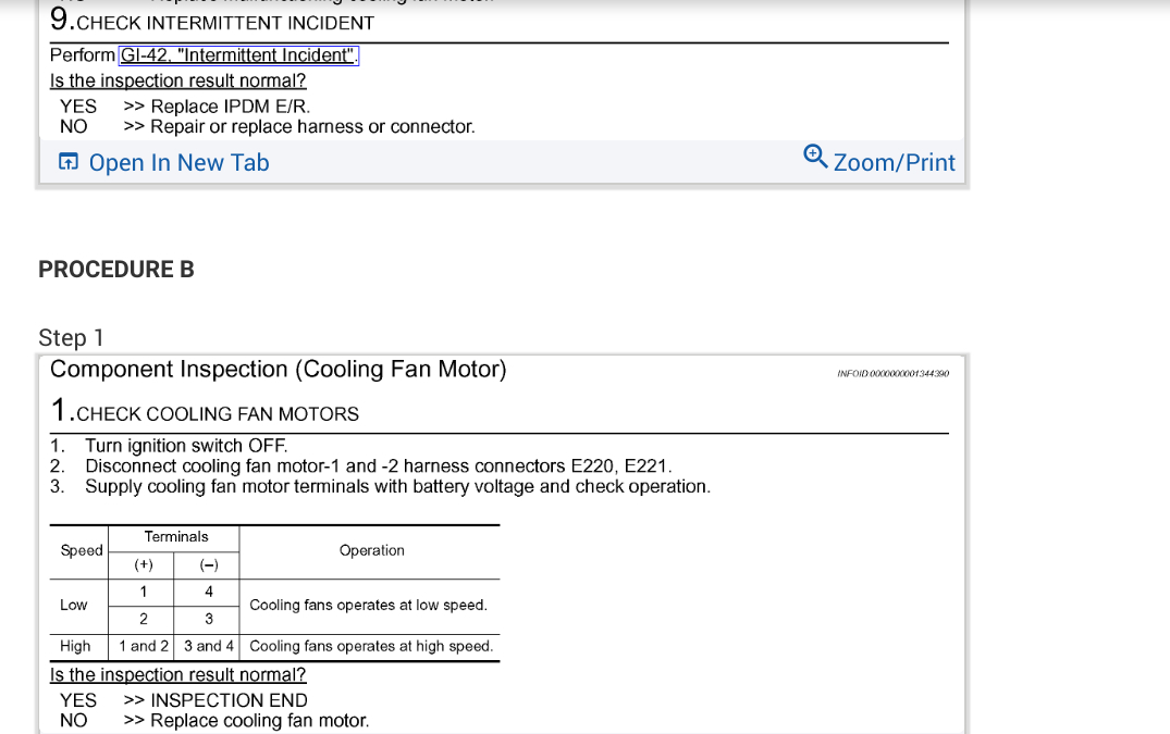

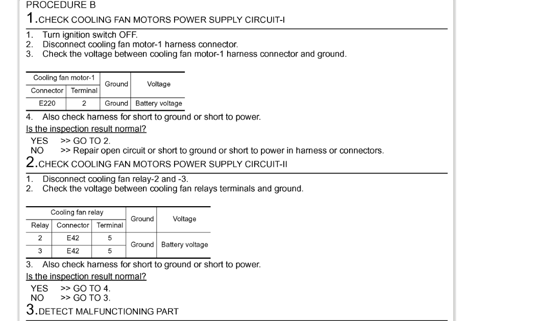

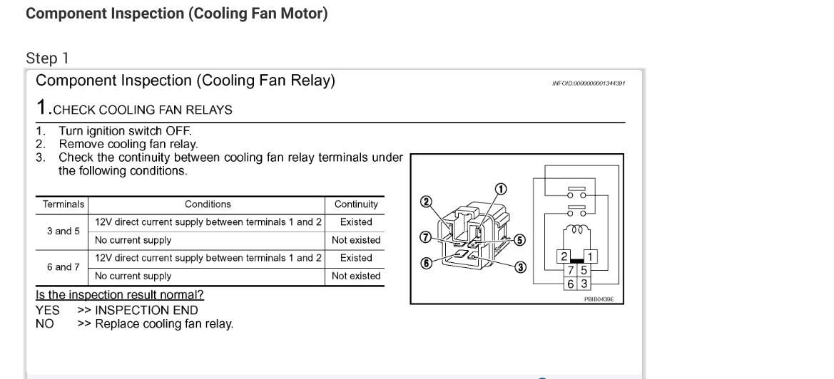

Hello Alex,
I hope you are doing great. I had solved the problem of oil leaking thank God! But now I am experiencing another issue. My car temperature gauge deflects a lot. When I turn A/C it gets low when I turn it off it goes up. One day it also burst my radiator. I changed it with a new one but the fluctuations are not solved. One day when the gauge was trying to rise I opened the hood and saw the both of the fans not working. But once I turned the A/C on the both fans got activated pulling the gauge down. I don't know if this is by company or what? I also don't know what to do. Please help?
