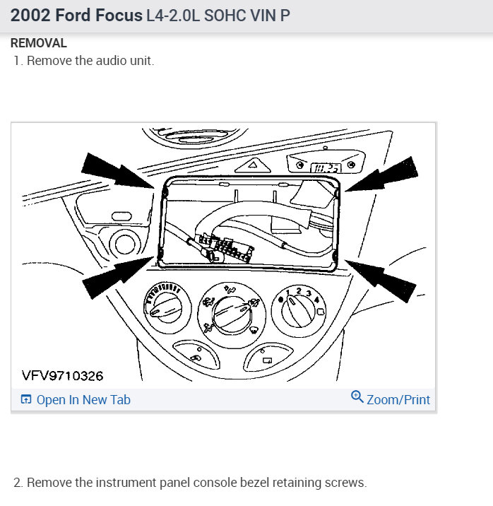

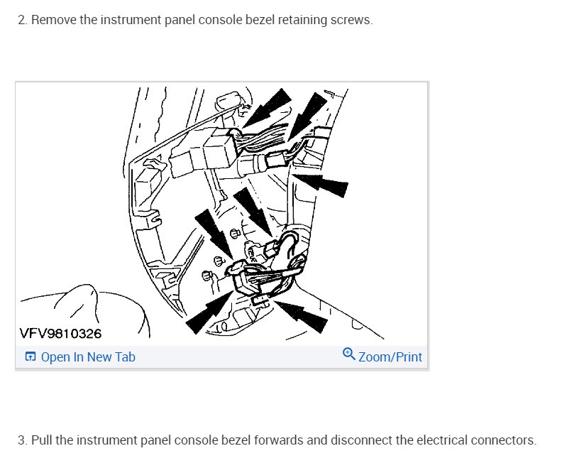

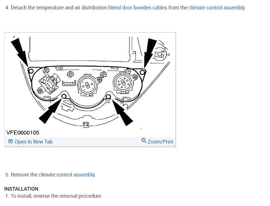

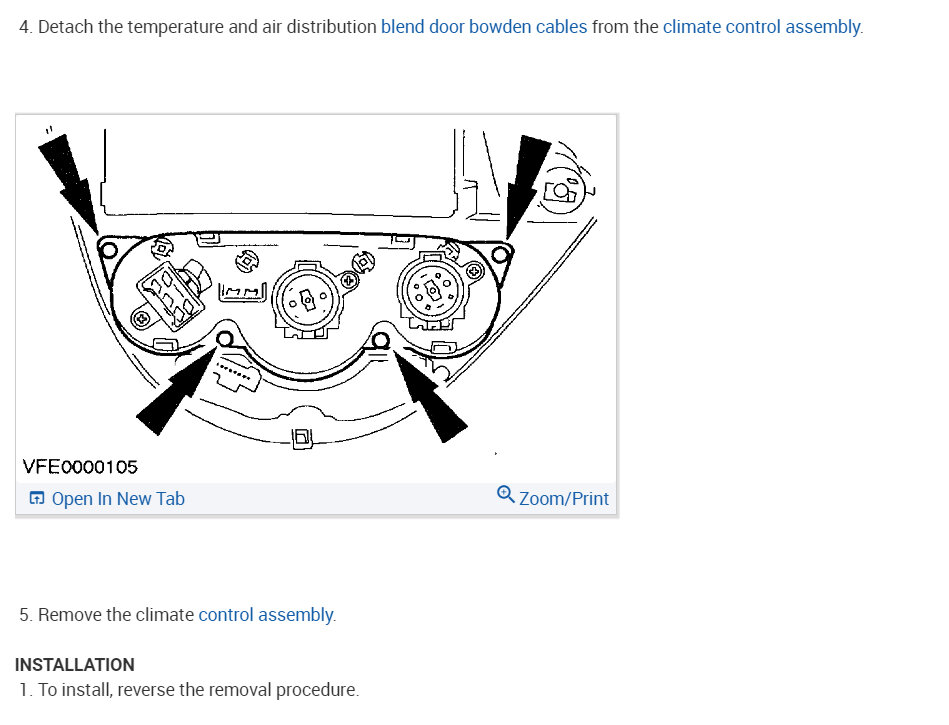

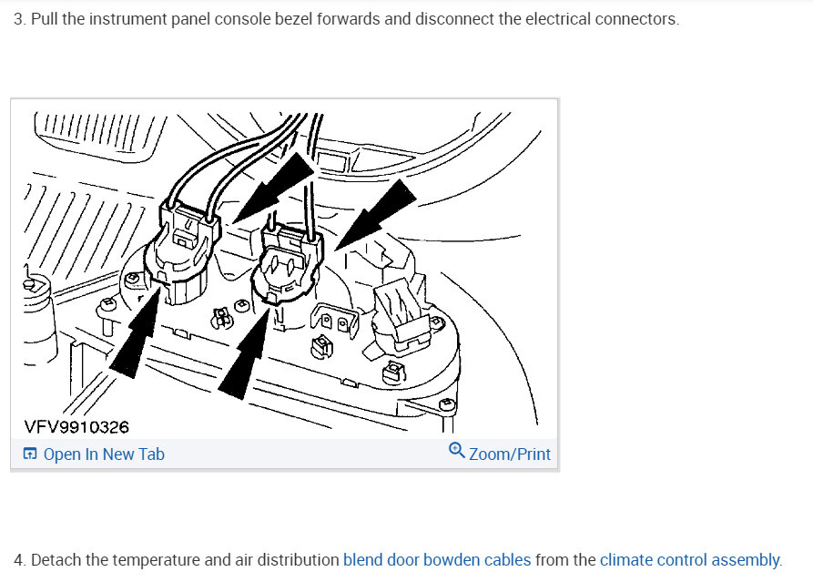

Here is how to change the HVAC controller out if a code comes up for it. Check out the images (below). Please let us know what happens.

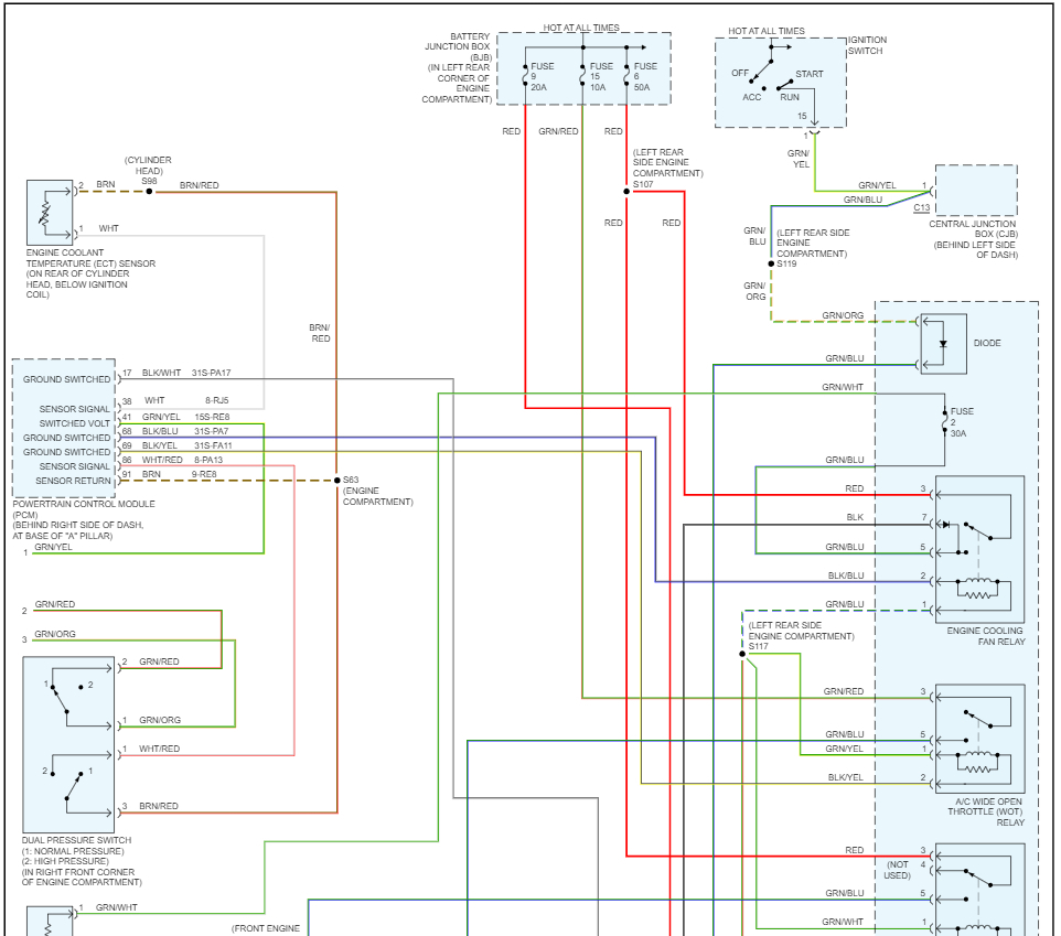

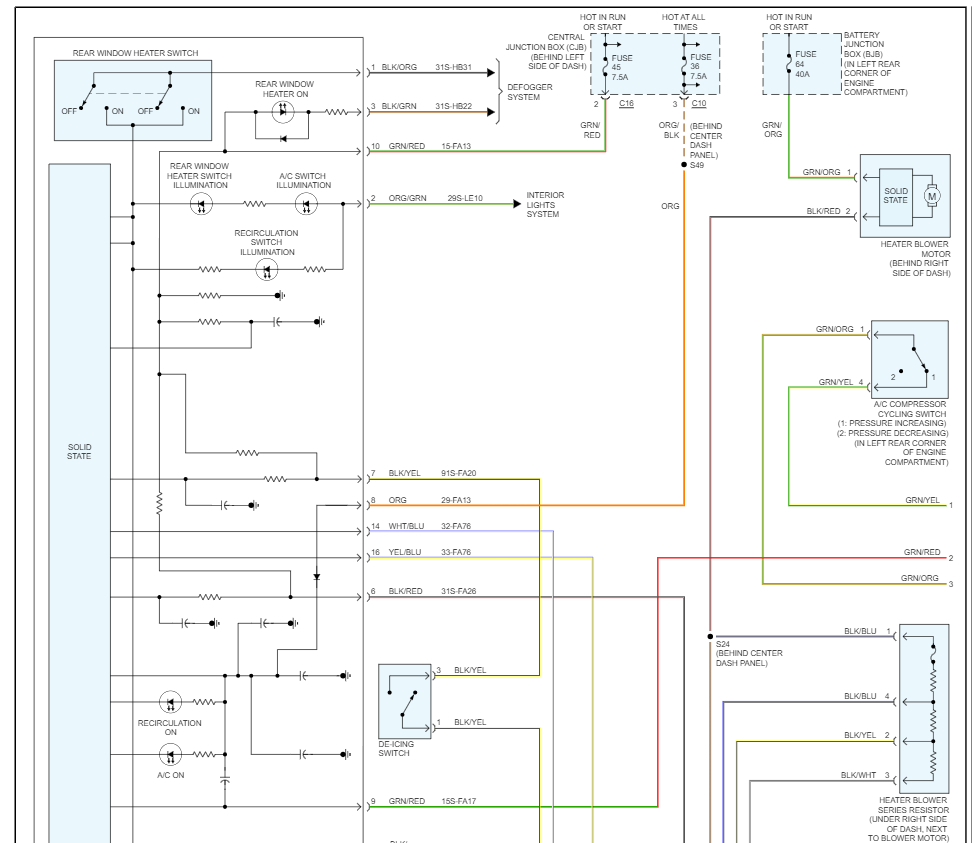

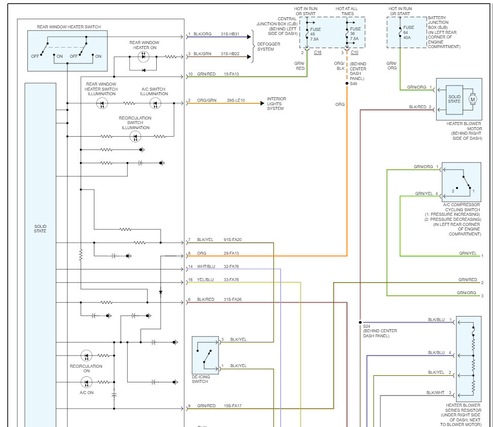

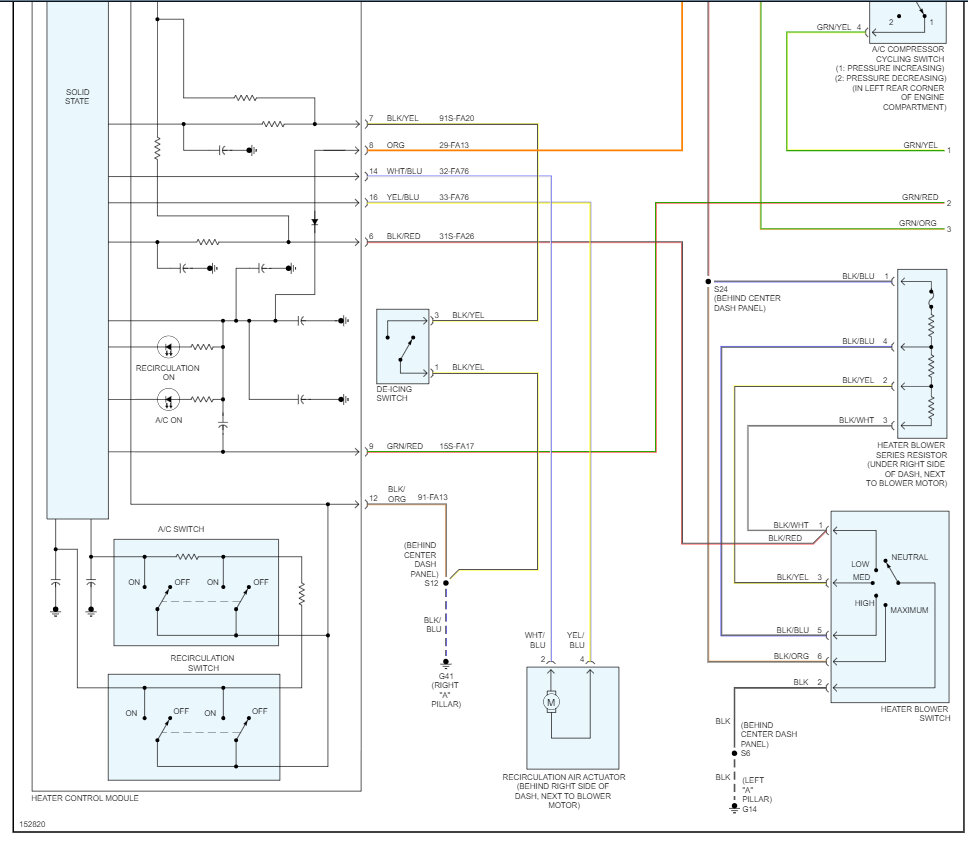

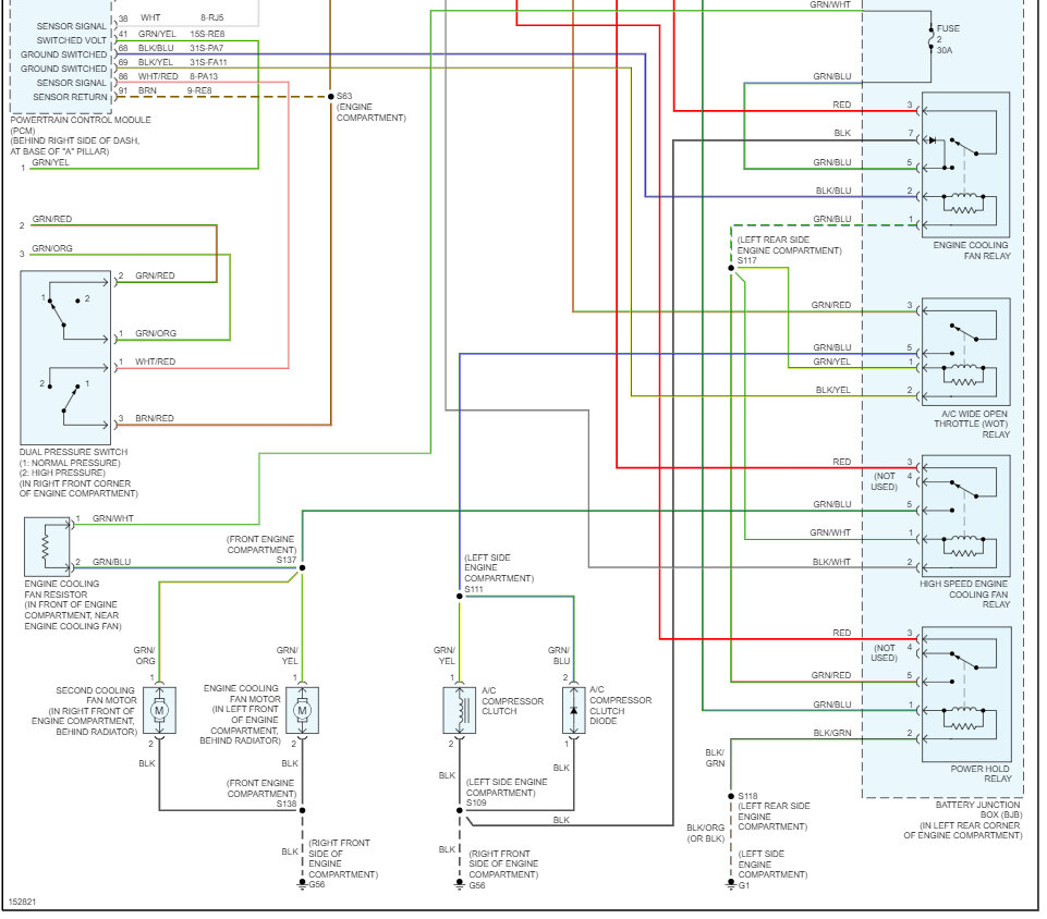

Does the Forscan check the CAN? It sounds like you may have a bad ground to the HVAC controller. here are the wiring diagrams and a guide to help you check the wiring and grounds. Also, I have seen the control cable for the vent doors fail.
