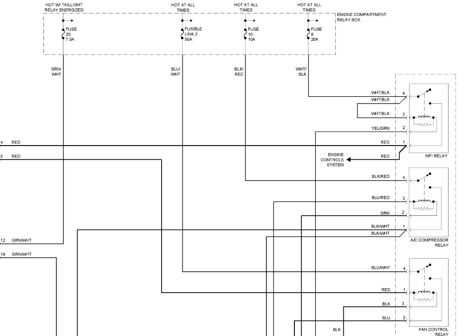

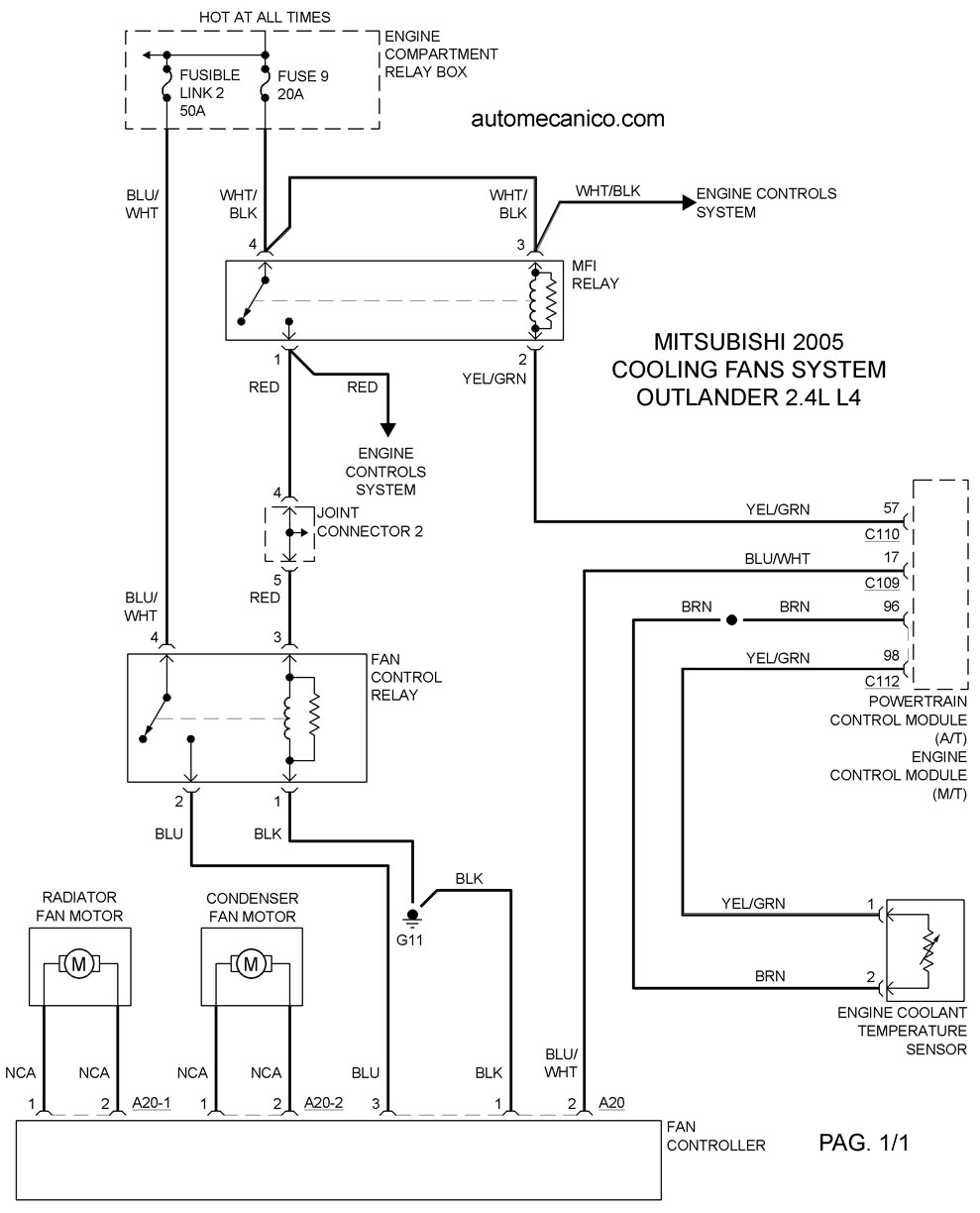

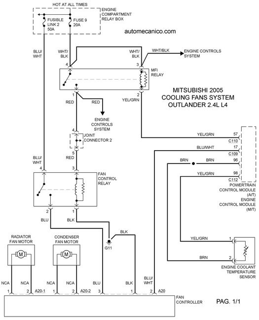

Hi, well if you share your phone number for sure I will call you, I am using the following wiring diagram. The diagram that I have is for Outlander 2003 and I have another one for 2005, although my car is 2004, the diagrams between 2003 and 2005 are almost the same there is a little difference. Well on these diagrams shows me that the temperature sensor sends the signal to the ECU, I checked made a test to the sensor and it is okay, I measure the resistance and it changes when I put some heat or cold.
The MFI relay is working good because I removed it then I applied 12 VDC with an independient power source I have and it works when the solenoid is energized, the same with the fan control relay. So, when I started to check the fan controller, I measured 12 VDC on the main connector.

Sorry, my hearing is no good. I have trouble on the phone. I will not use the phone except in an emergency. That blue wire should not be hot with everything off.
