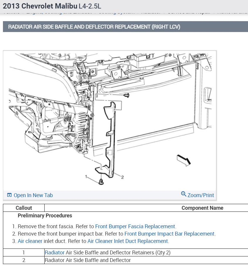

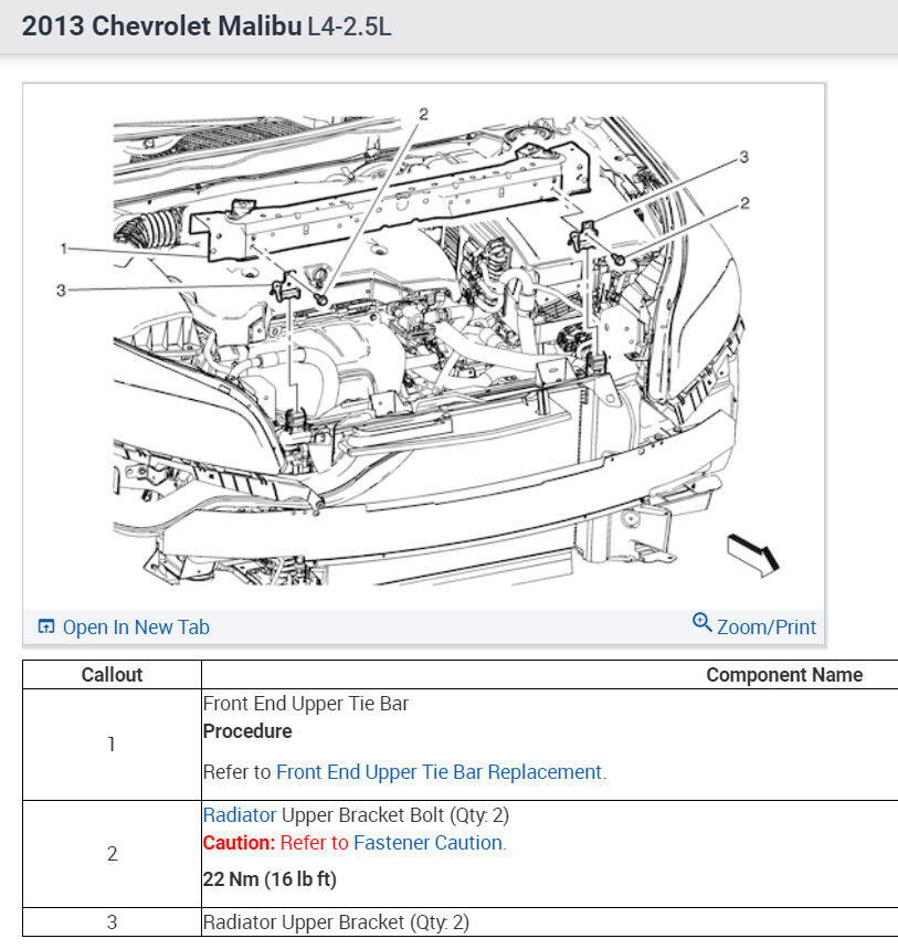

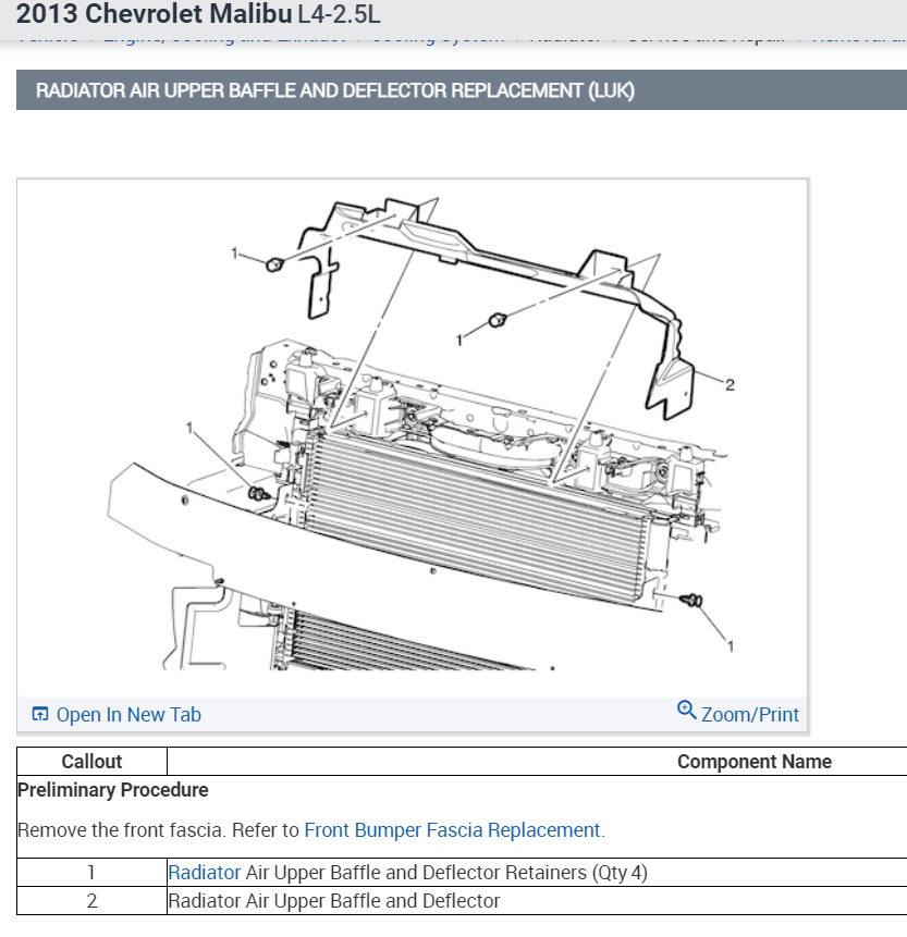

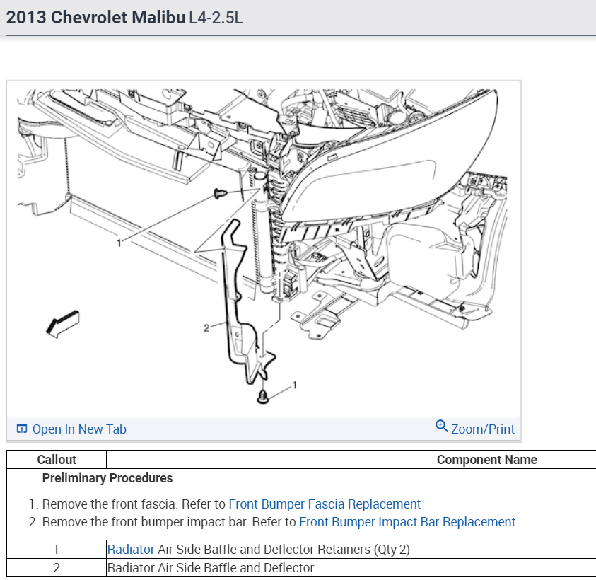

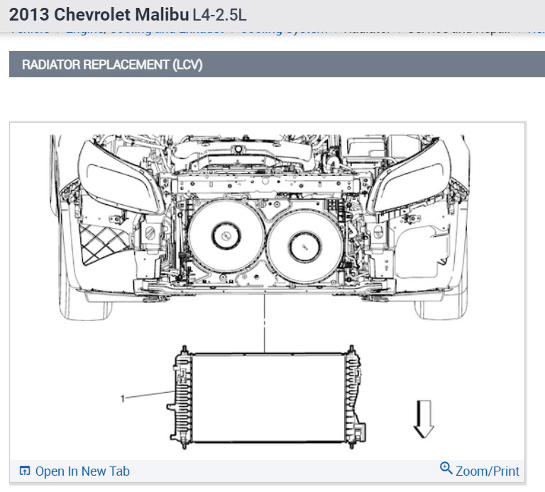

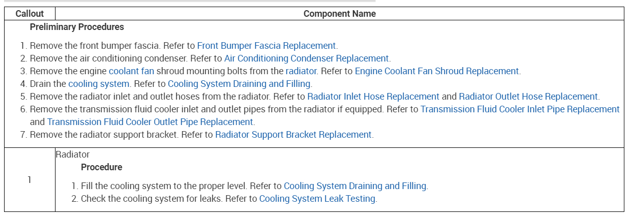

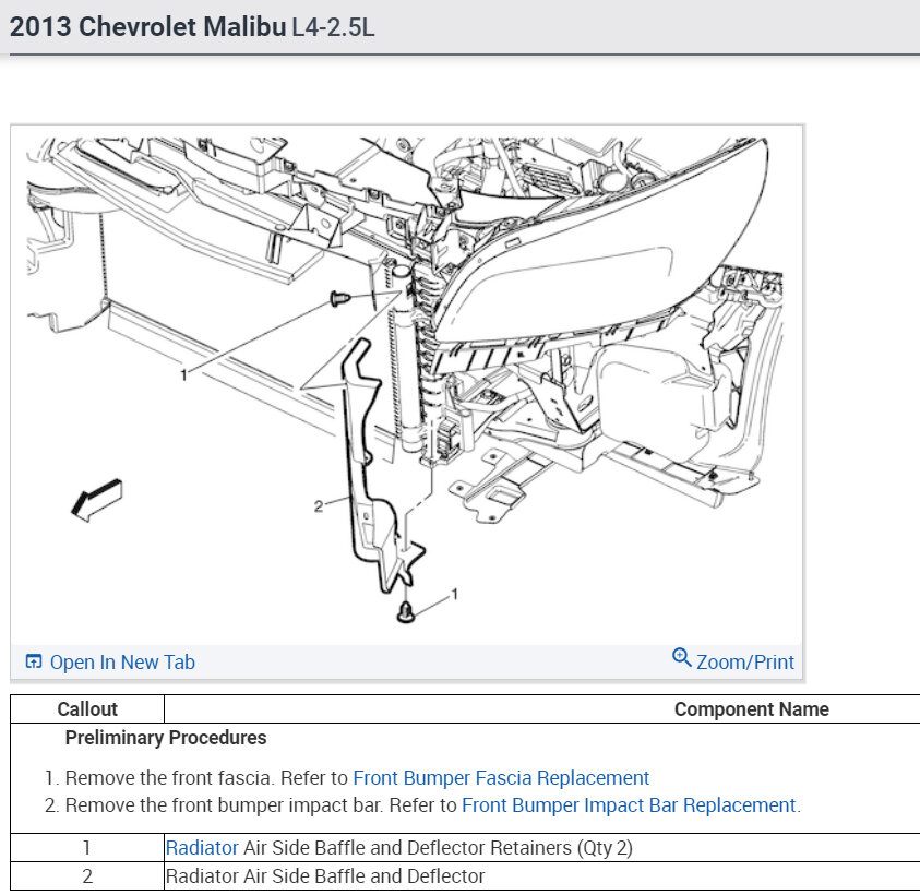

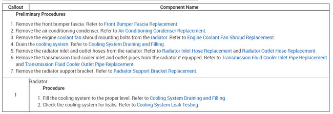

Replacing the radiator in this car takes longer than some cars:
Radiator, R&R-- 3.8 hrs@ shop rate. This is because most of the front body/bumpers must be removed first. Check out the images (below). Please let us know if you need anything else to get the problem fixed.
