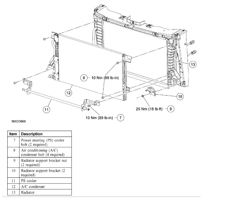

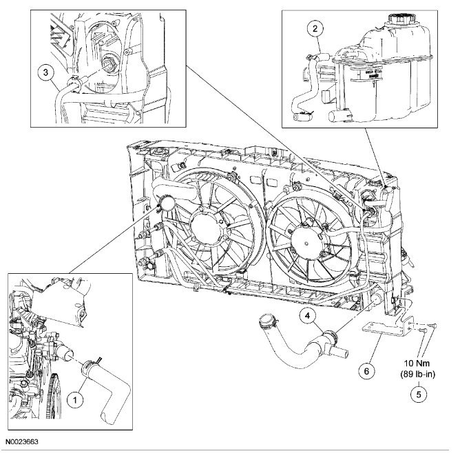

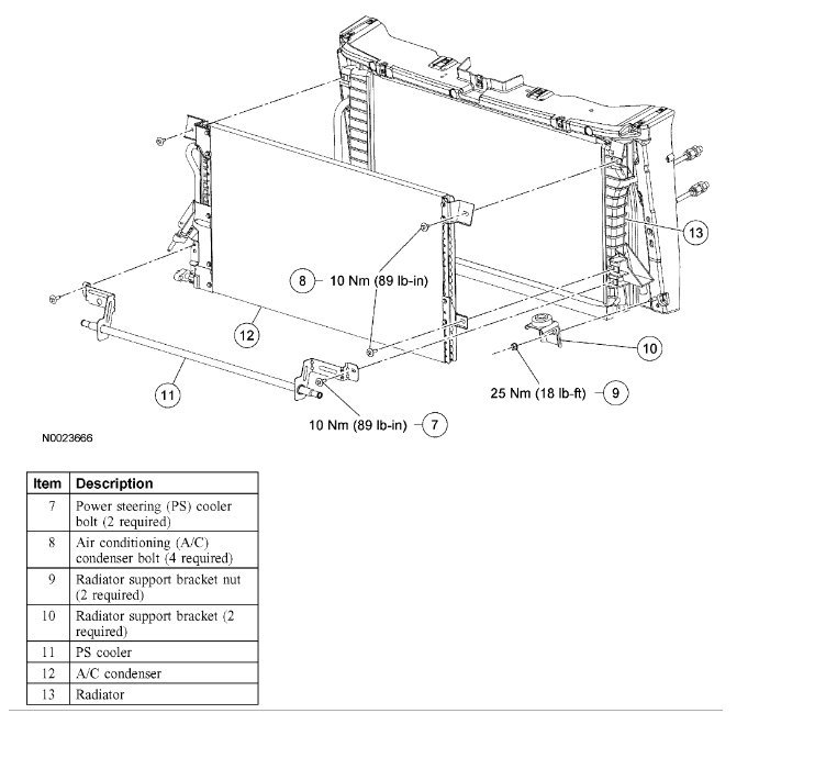

How to replace the radiator in a 2006 ford Taurus 3.0. Does it come out the top or the bottom? I got everything off the top and disconnected all lines but it still won't come out. I'm very confused. I've never changed a radiator where you had to remove the whole front end accessories just to get to the fan shroud.
