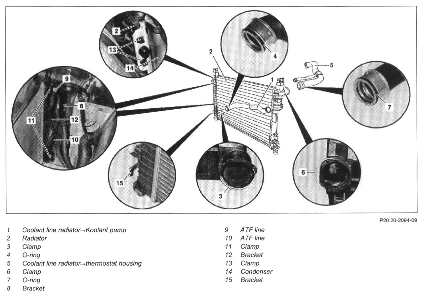

At the bottom of the radiator those two tubes or hoses I should say, do I take those off in order to get the radiator off? Because I have everything can disconnect, but it will not let me pick it up because there are two metal hoses in the front that are connected to the hoses to the back to a reverent hose. How do I get the radiator to come out? Do I have to take off or in disconnect those hoses and then re attaching to the new one? Please help

Here are the directions for removing and installing the radiator. The attached picture correlates with these directions.

Removing and Installing Radiator
1 Remove electric fan
DANGER:
- Risk of injury to skin and eyes suffering scalding from contact with hot coolant spray. Risk of poisoning from swallowing coolant.
- Do not open cooling system unless coolant temperature is below 90 degrees C. Open cap slowly and release the pressure. Do not pour coolant into beverage bottles.
- Wear protective gloves, protective clothing and eye protection.
2 Drain coolant
3 Take off coolant line radiator -> Coolant pump (1) at radiator (2)
- Use a screwdriver to push back clamp (3) until it locks in place.
NOTE: Installation: Replace O-ring (4) of coolant line radiator-> Coolant pump (1).
4 Take off coolant line radiator -> thermostat housing (5) at radiator (2)
- Use a screwdriver to push back clamp (6) until it locks in place.
NOTE: Installation: Replace O-ring (7) of coolant line radiator -> thermostat housing (5)
5 Detach bracket (8) of ATF lines (9, 10)
- Only on models fitted with transmission 722.6.
6 Detach ATF lines (9, 10) at radiator (2)
NOTE: Installation: Check clamps (11), replace if necessary. Replace O-rings of ATF lines (9, 10).
7 Press ATF line (10) out of bracket (12)
8 Push back clamps (13) at radiator (2) on right and left
- Pull up condenser (14) forward at the top for this step and release at the bottom.
NOTE: Installation: Ensure that the condenser (14) is located at the bottom in the brackets (15) on the right and left; at the same time the clamps (13) must be locked in place.
9 Lift radiator (2) up and out
NOTE: Installation: When installing, ensure that the studs of the radiator at the bottom are located in the rubber mounts.
10 Install in the reverse order
