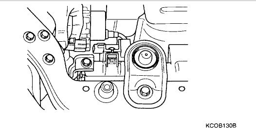

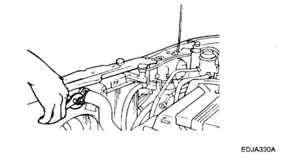

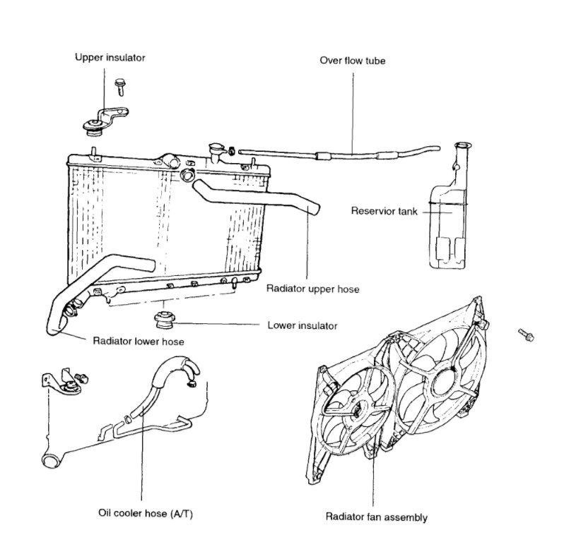

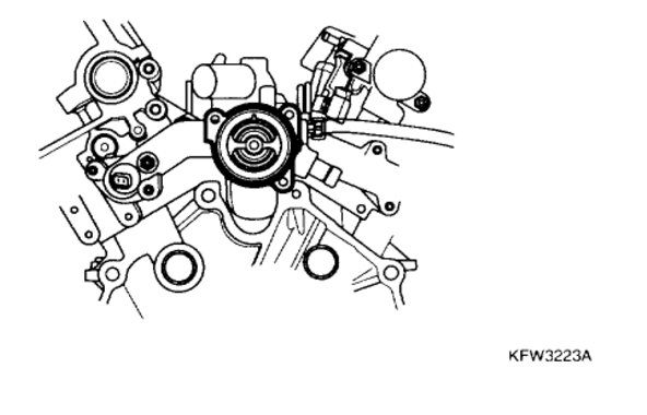

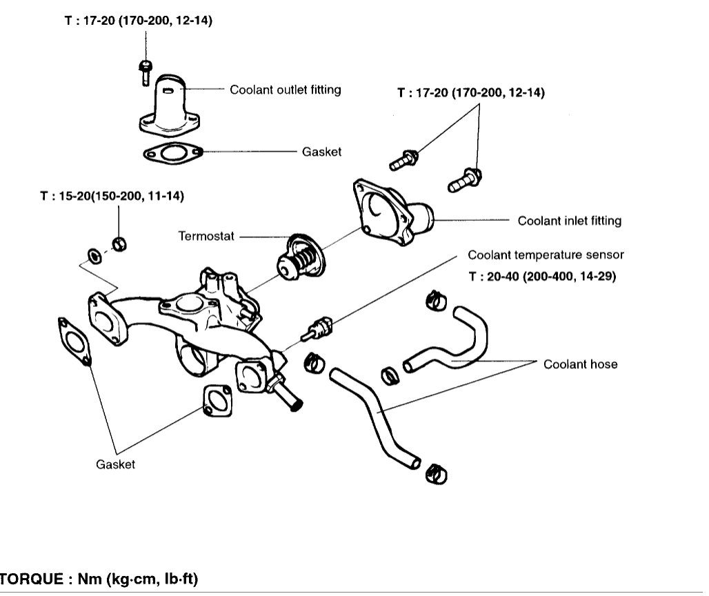

This kind of problem happens all the time to older radiators and the engine can be just fine. I would replace the radiator and thermostat to be safe, though here are some guides and diagrams (below) to help you get the problem fixed and get back on the road.
