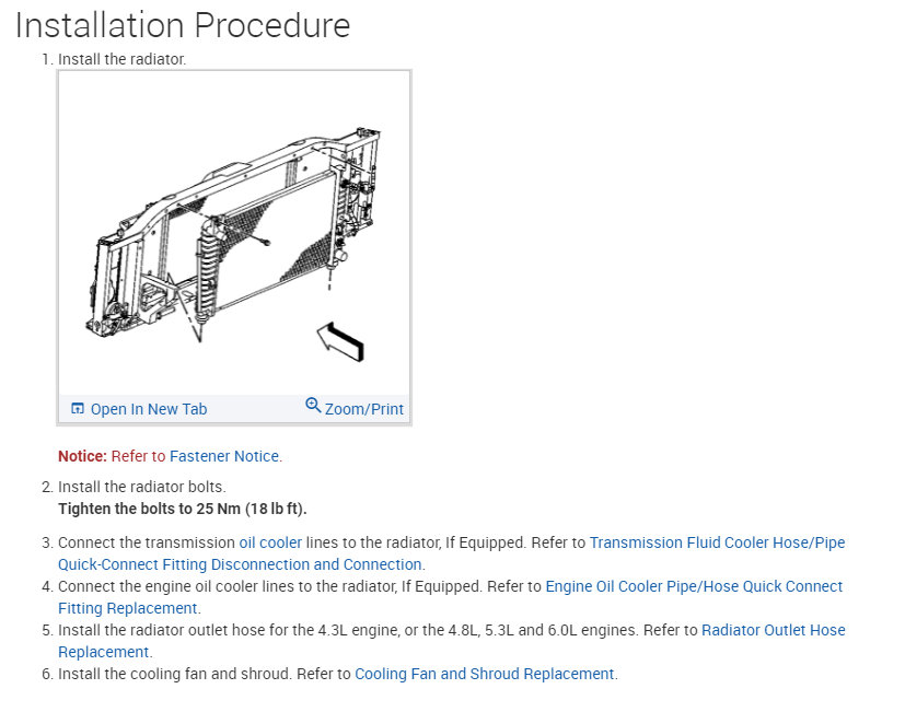

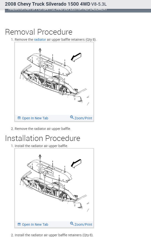

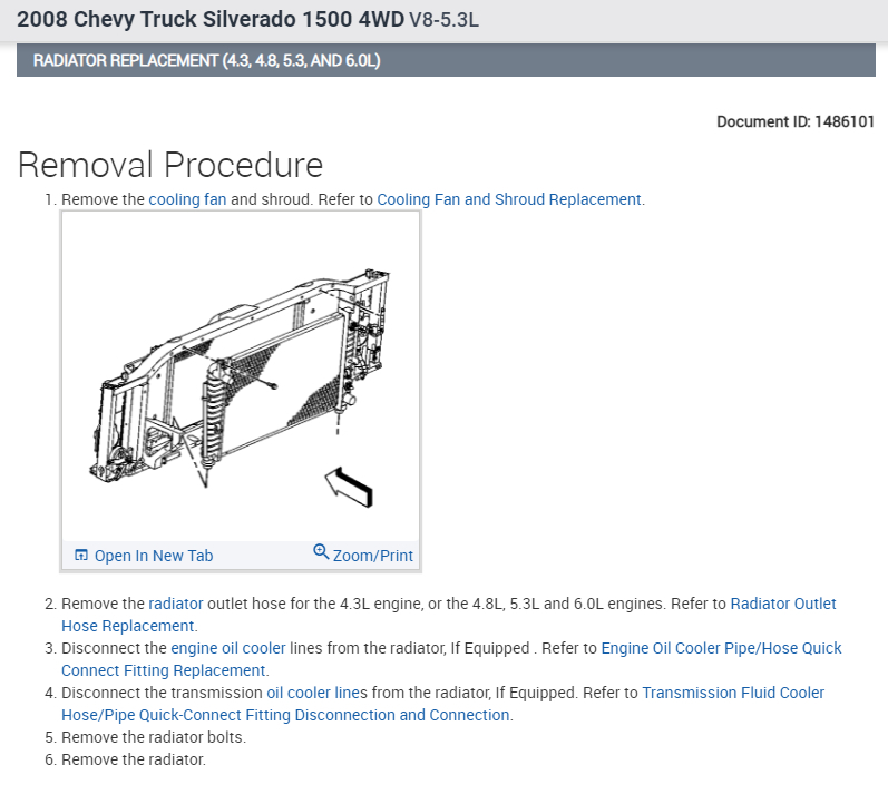

Ideally you want to have the same fittings and style on the replacement radiator. Otherwise, you will have to change the existing line connectors.
So yes, getting a radiator that has the correct style fitting would be the best option.
https://www.2carpros.com/articles/how-to-replace-a-car-radiator
