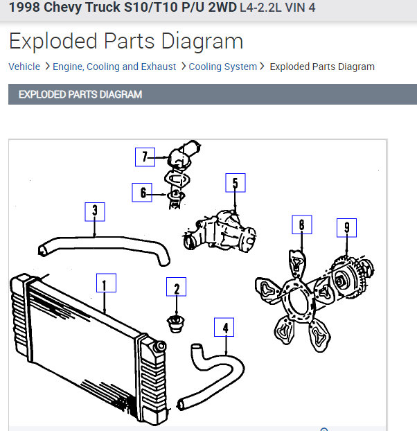

radiator replaced leaking coolant and making bubbling sound.
Sep 22, 2021 at 1:14 PM
SQM
  • 6,383 POSTS
Typically you will hear gurgling/bubbling noise when there is air in the cooling system.
Some times the engine can make that noise when it overheats.
https://www.2carpros.com/articles/vehicle-bubbling-noise
Can you see where the leak is coming from?
You can have a leak from the radiator, hoses, water pump etc.
https://www.2carpros.com/articles/car-is-leaking-coolant
Is the Engine overheating?
Please let me know what you are observing.
