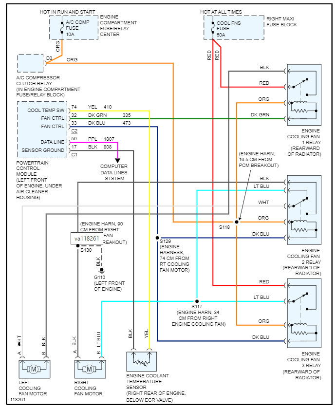

so, I have an aftermarket wiring system set up to the radiator fans that came on the car when I bought it and the fans have never worked but once or twice, so the fans aren't bad, but I don't know how the wiring is set up. Does anyone have any suggestions on how to either revert the wiring back to the factory or fix it? and another thing is the guy said the mechanics at the shop he put it in to get the thermostat replaced had to do the aftermarket wiring because it wasn't working being connected to the factory stuff and I'm trying not to ruin my engine with just barely 119,000 miles.
