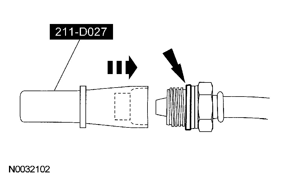

If the issue is with the Teflon o-ring, those can be replaced. Here is a picture of the procedure, you don't necessarily need the special tool,as long as you are careful with stretching it into place.

Not sure. I just did the power steering pump so I know what you're talking about. I could remove the line and check, but it looks like the issue is with the fitting/line itself. Thanks.
Sep 23, 2019 at 12:47 PM
That could be sometimes the port in the rack is damaged and will never seal so please look at that as well. Can you please shoot a quick video with your phone so we can see what's going on? that would be great. You can upload it here with your response.
