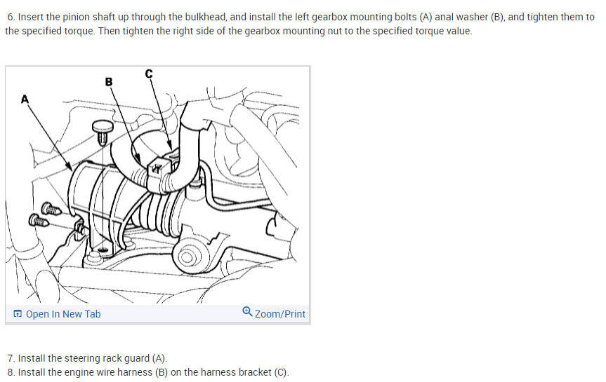

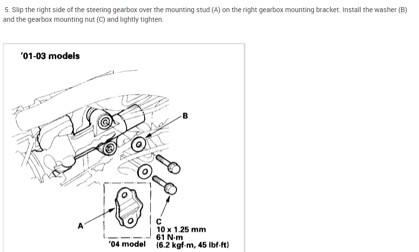

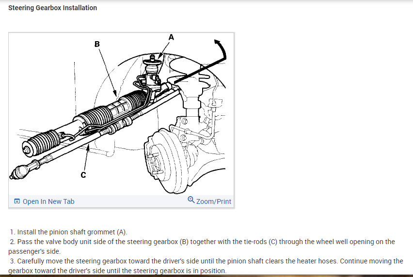

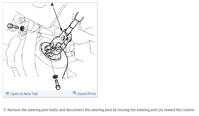

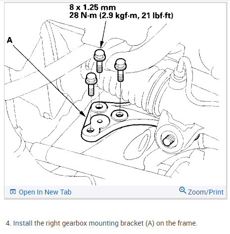

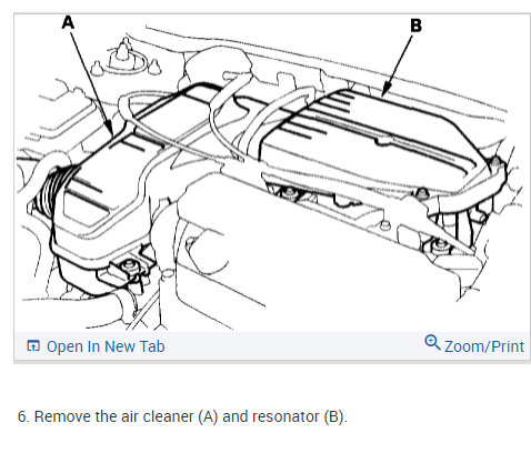

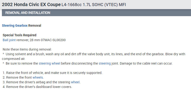

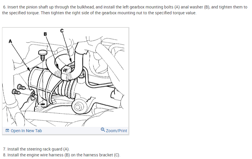

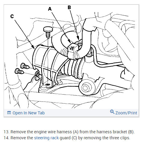

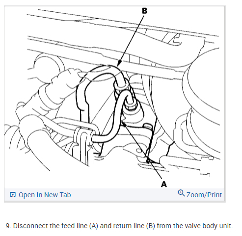

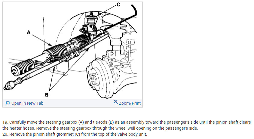

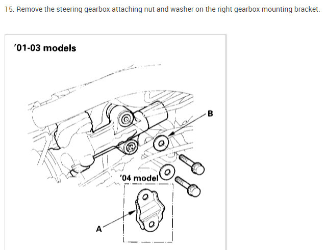

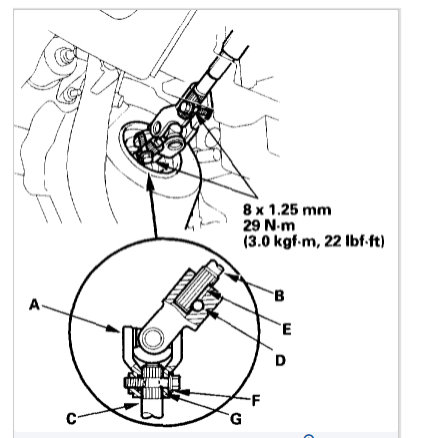

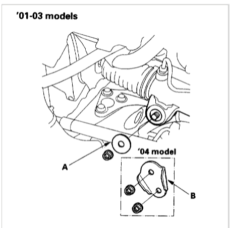

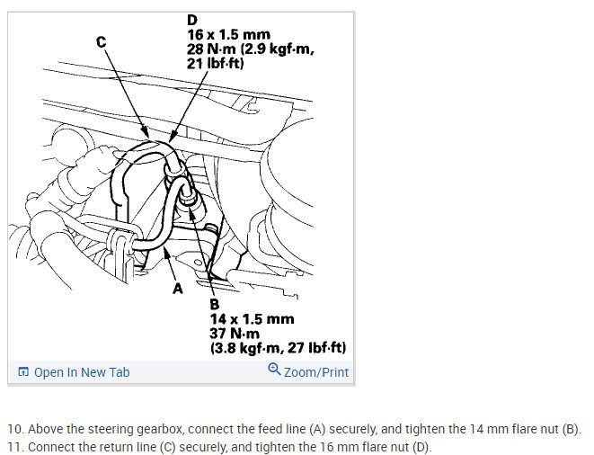

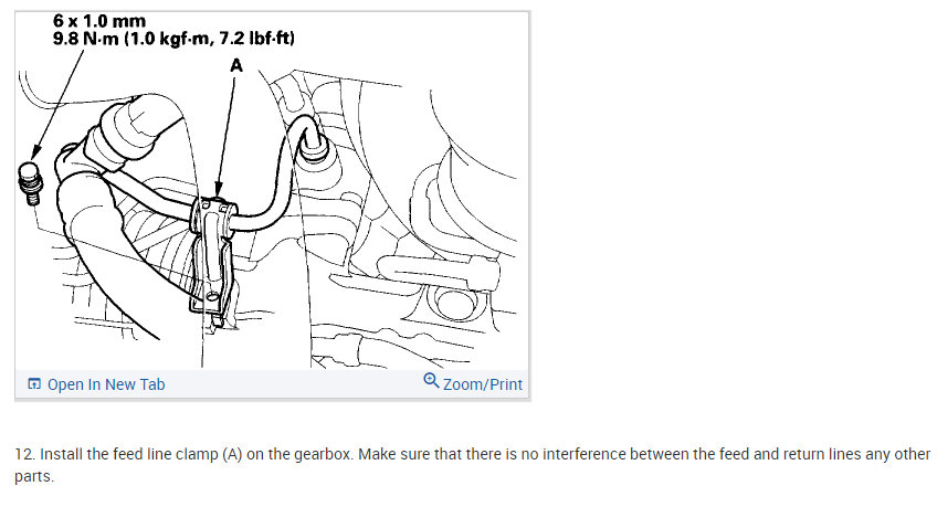

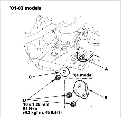

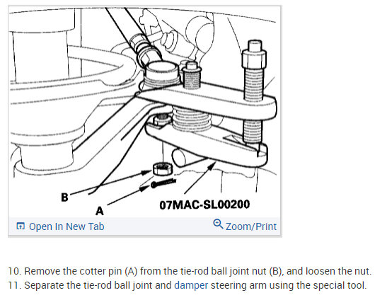

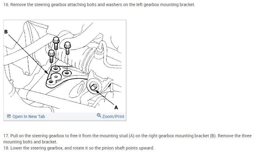

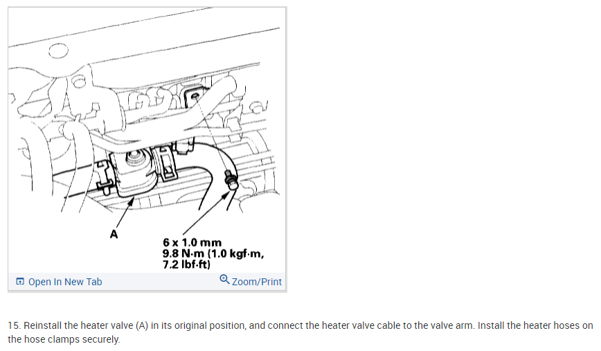

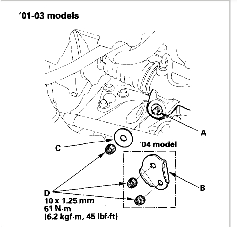

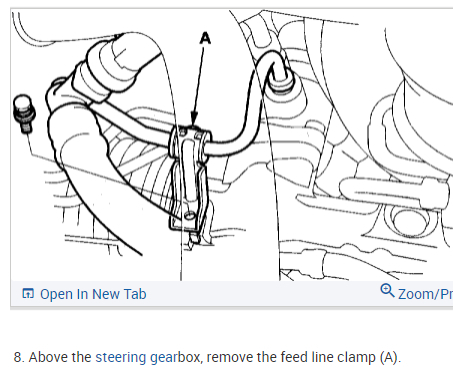

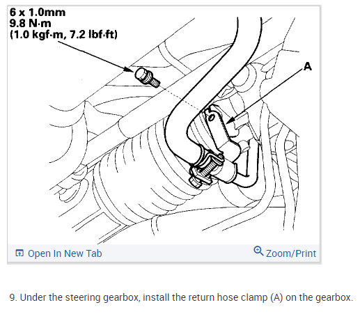

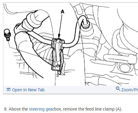

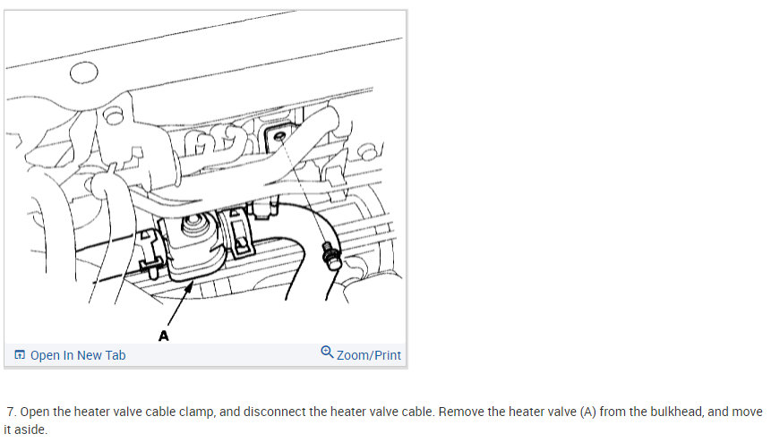

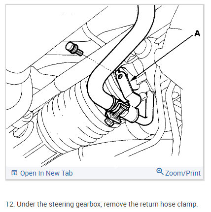

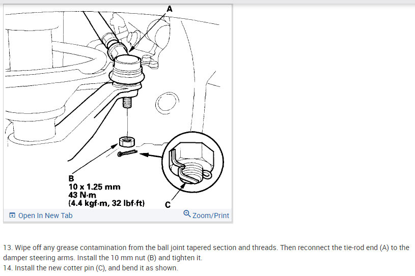

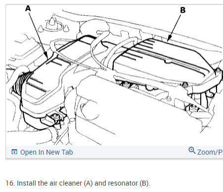

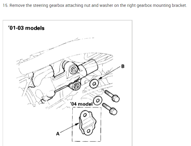

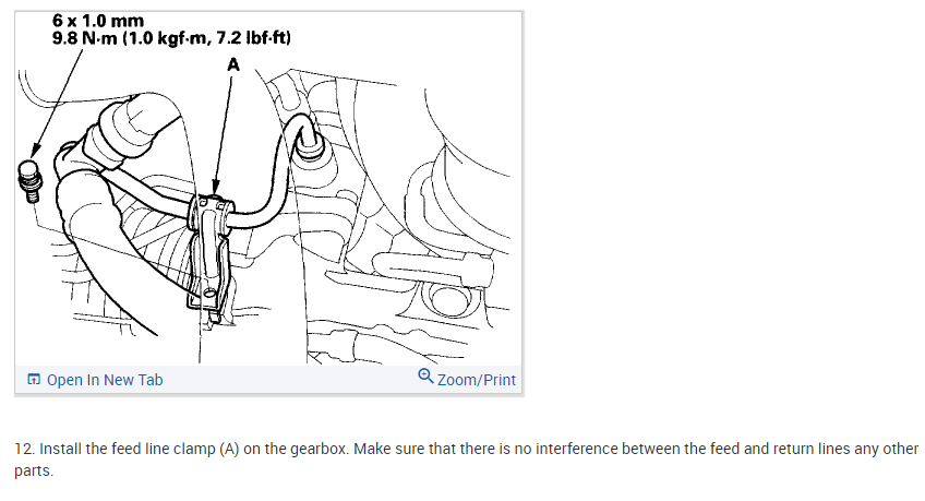

I can't find anywhere how to replace the rack in pinion on the car listed above (EX model). How do you replace it?
Aug 25, 2021 at 10:03 PM
DANNY L
  • 5,648 POSTS

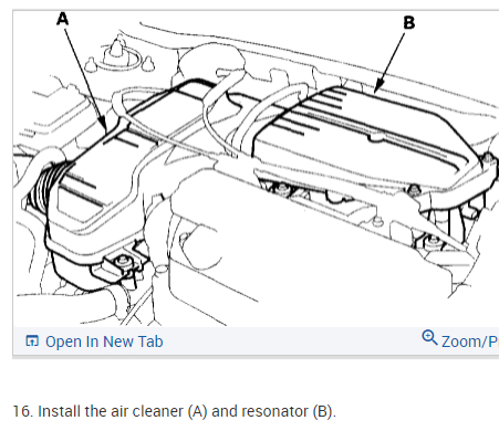

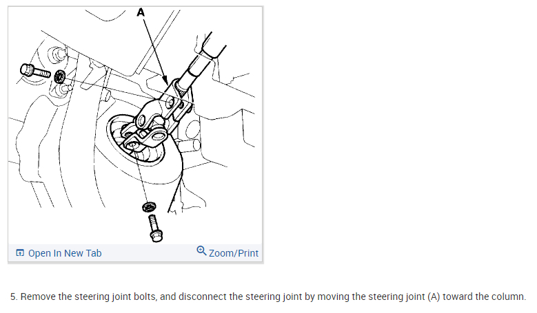

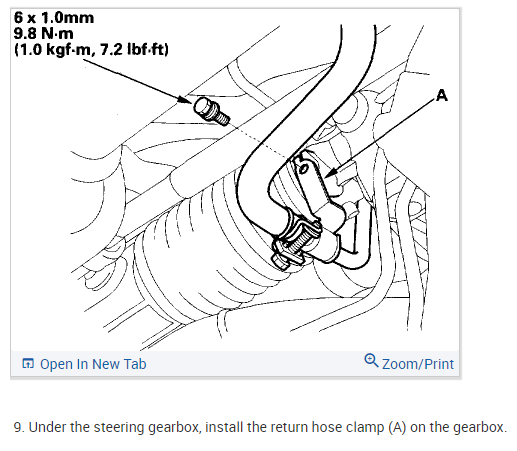

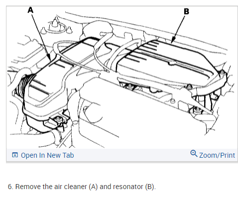

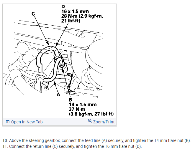

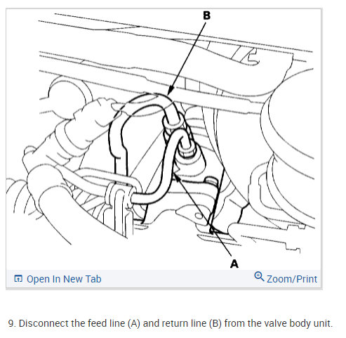

Hello, I'm Danny
Here is the information you requested. I've attached picture steps below on how to remove and replace the power rack and pinion steering component on your Honda. After performing the repair just be sure to cycle the steering wheel side to side full lock after adding power steering fluid to get rid of any air from the system. This may take a few minutes. Be sure to use Honda brand power steering fluid and do not use ATF-automatic transmission fluid. Hope this helps and let us know if you have any further questions on this issue. Thanks for using 2CarPros.
