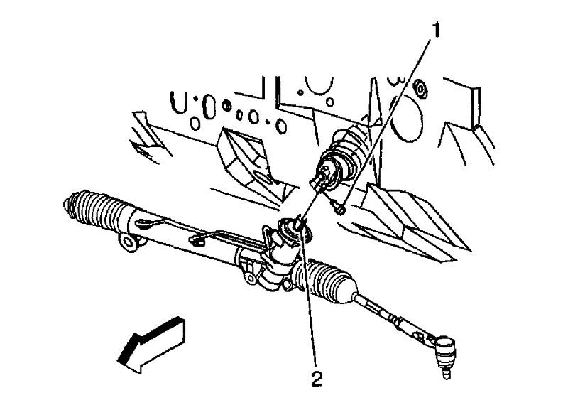

3. Remove the stabilizer shaft links from the control arms.
4. Remove the tie rod ends from the steering knuckle.
5. Remove the intermediate shaft lower pinch bolt (1) from the power steering gear (2).

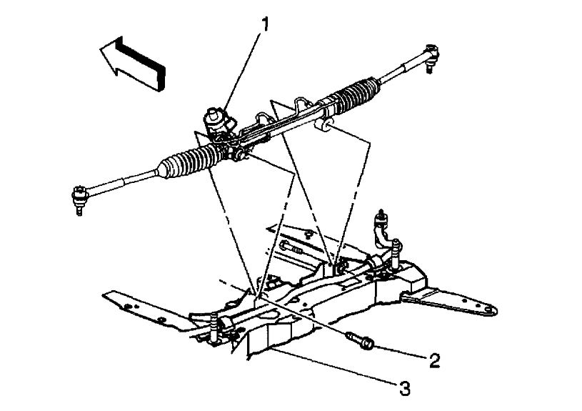

8. Remove the power steering gear bolts (2) from the frame (3).
9. Remove the power steering gear (1) through the left wheel opening.
