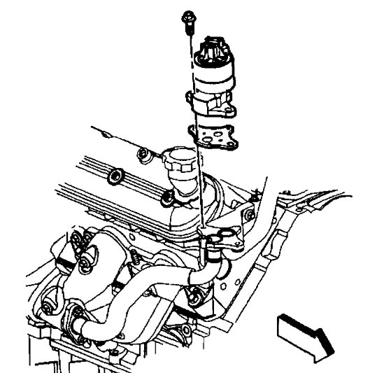

Yep, it sounds like there is a vacuum leak or the GR valve is stuck open. Also are there any codes? here is a video on how to check for vacuum leaks and how to test the EGR valve.
https://www.youtube.com/watch?v=LRKWV4Are5c
The smoke machine is about 64.00 on ebay
https://www.youtube.com/watch?v=DqUCbbKdWf4
and the EGR test is below.
Here is he location of the valve. Check out the images (below). Please let us know what happens.

Yes!!!!! There was carbon pebbles blocking the plunger from closing all the way. No codes were given, thank you!!!
