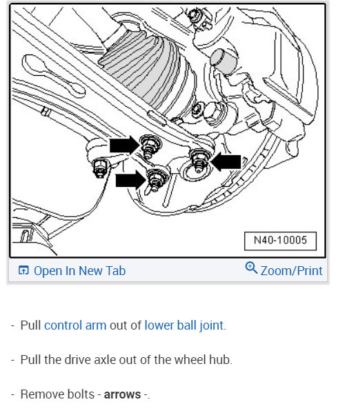

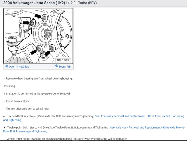

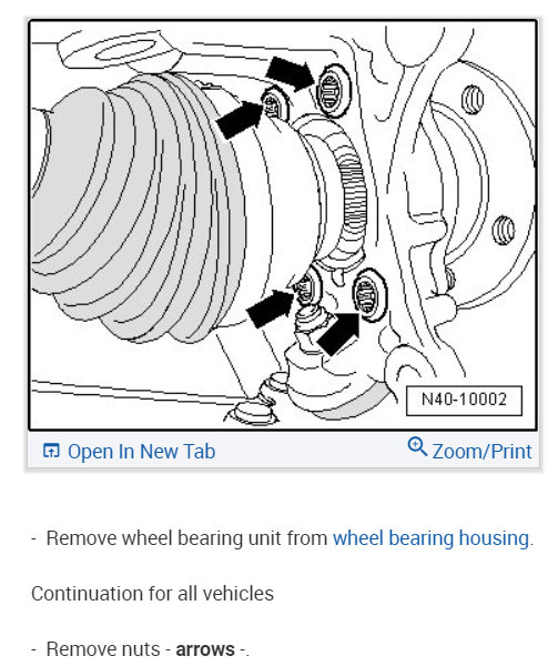

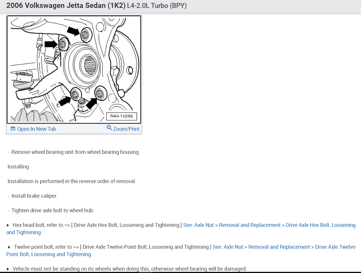

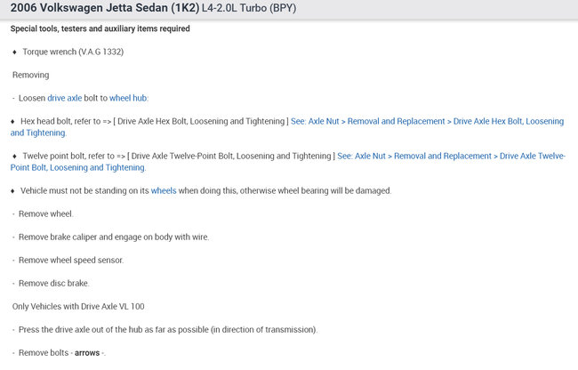

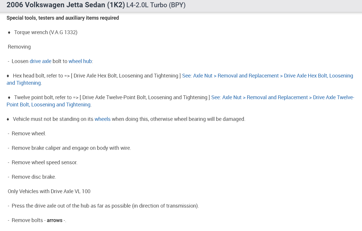

This sounds like a front bearing hub needs to be replaced. Here is a guide that will walk you through the repair with diagrams below to show you how its done on your car:
https://www.2carpros.com/articles/bearing-hub-replacement
I would do both sides. Check out the diagrams (below). Please let us know what happens.
