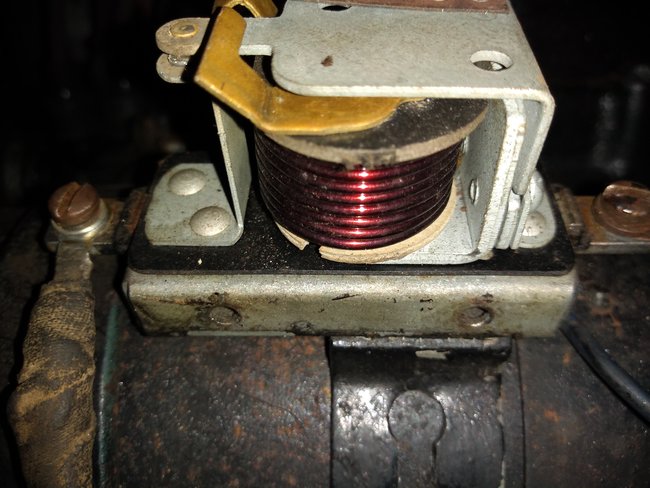

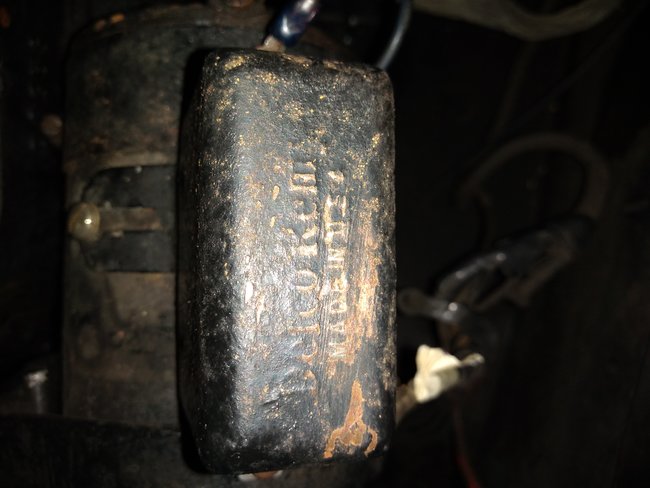

I think the issue is with the voltage regulator. Are you familiar regulators?This one has two connections, and one set of points. It looks like the points are closed when car is running, are they supposed to be always closed, or supposed to constantly open and close. I'm attaching pictures of the voltage regulator.

The "AC generator", developed by Chrysler for 1960, which they called an "alternator" is physically incapable of developing more current that it is designed to produce, therefore, it is self-regulating in that aspect. The previous DC generator design needs to have its maximum current regulated to what the brushes and wiring can handle. That is done with the relay in your first photo. That is identified by the really fat wire wound around the relay's core. All generator output current flows through that coil.
As long as current stays below the maximum allowed, the electromagnetic field created by that coil isn't strong enough to pull the movable contact down. When current rises too high, the magnetic field becomes strong enough to move that arm, then the contacts break apart to affect current flow. That relay is probably not going to trip very often.
