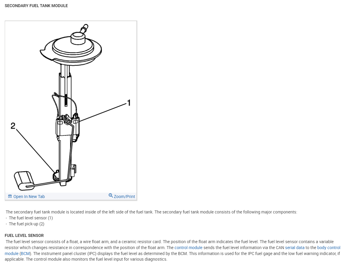

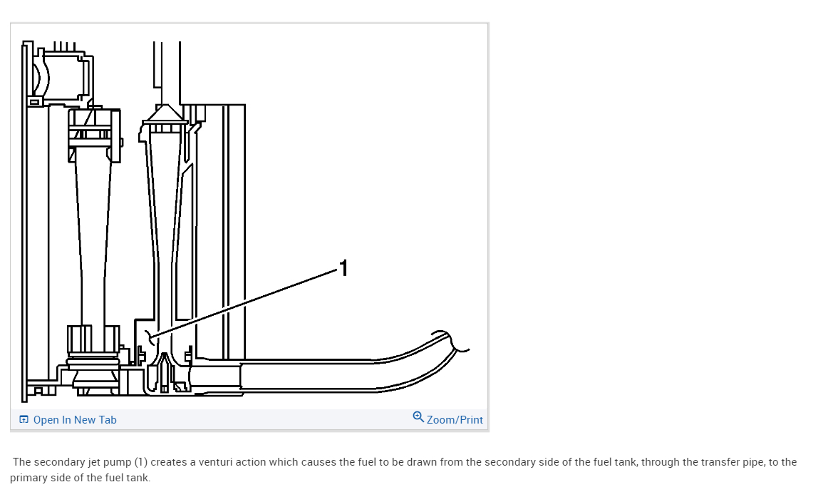

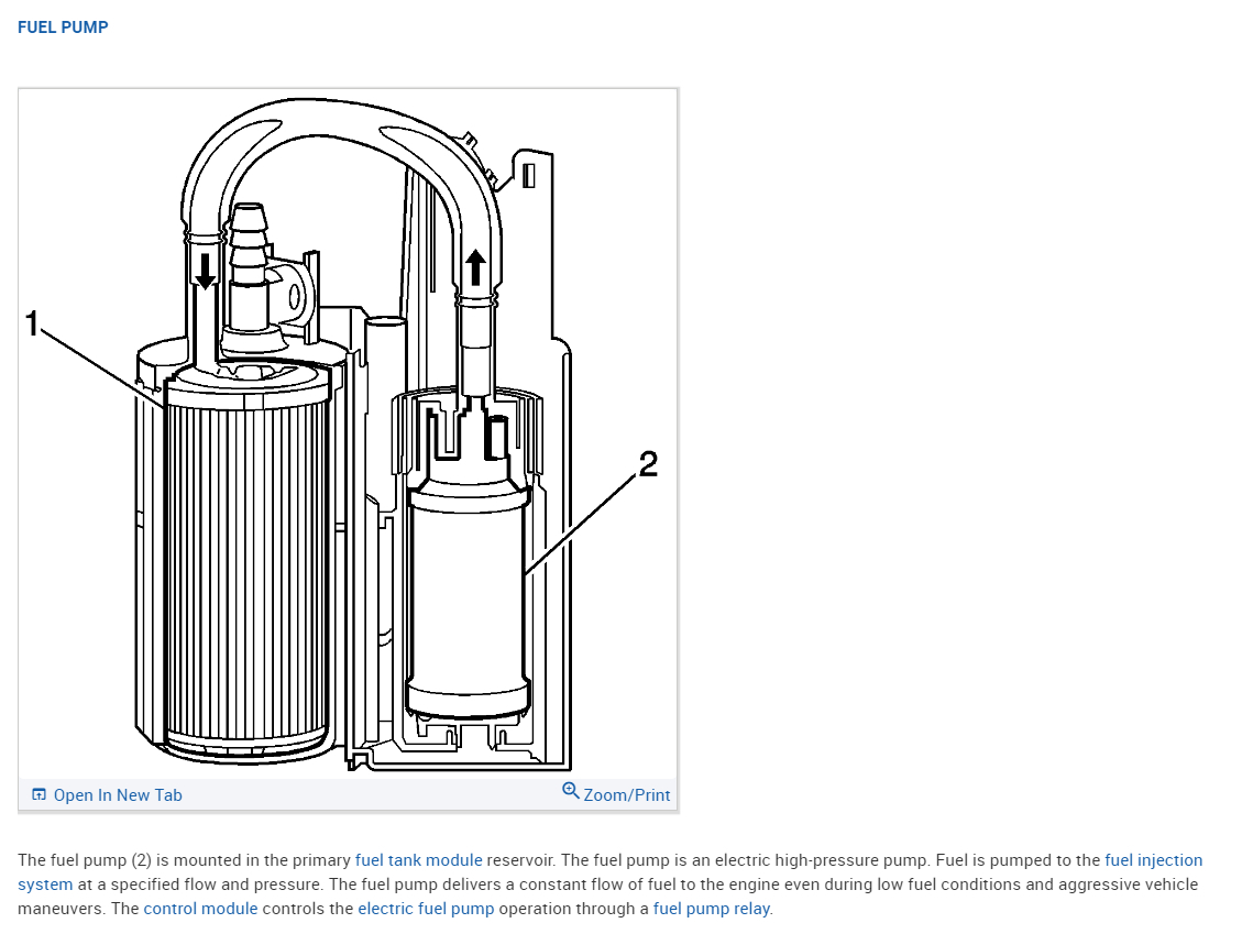

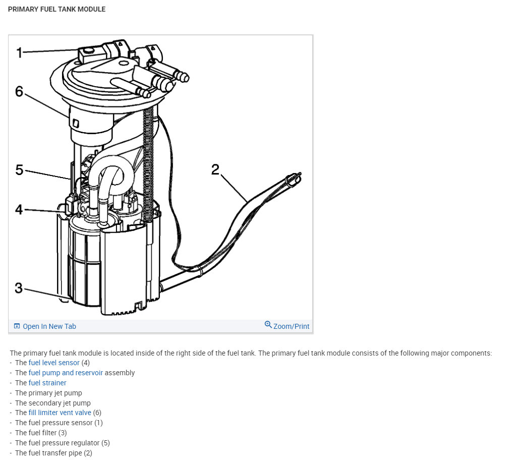

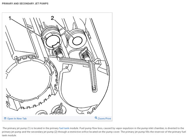

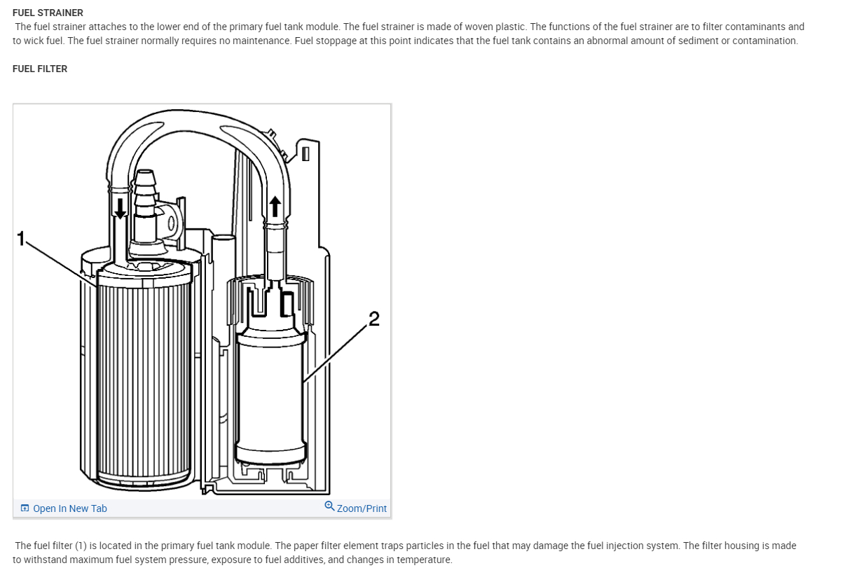

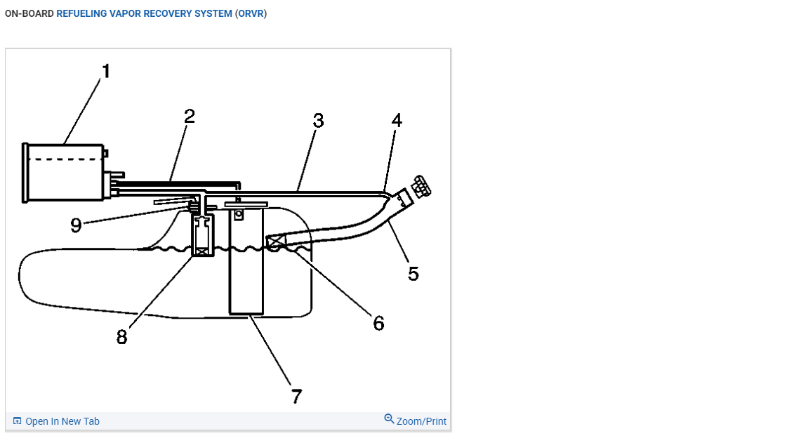

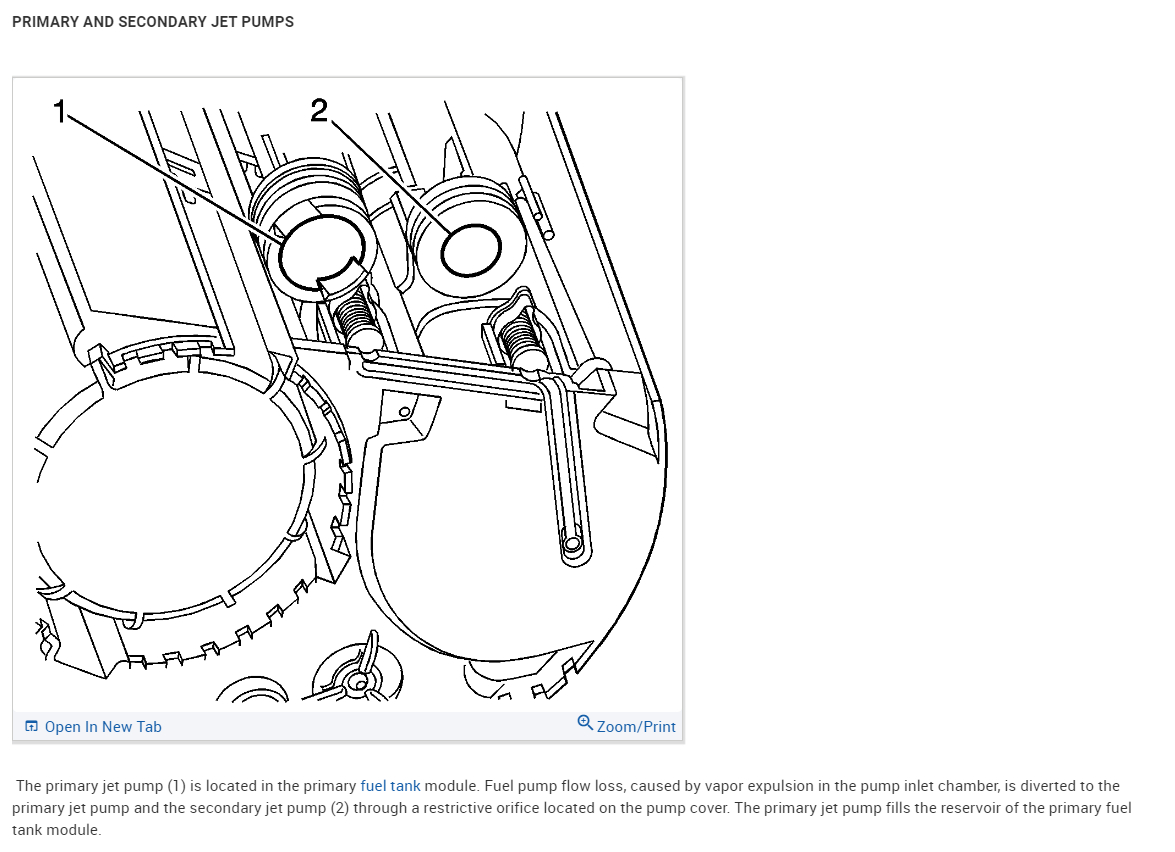

Hello, it looks like the pump assembly is one unit, it's a unique design. It is to ensure there is always solid fuel pressure "even during low fuel conditions and aggressive vehicle maneuvers". If there a reason you need to replace the pump assembly?
This is what service information is showing.

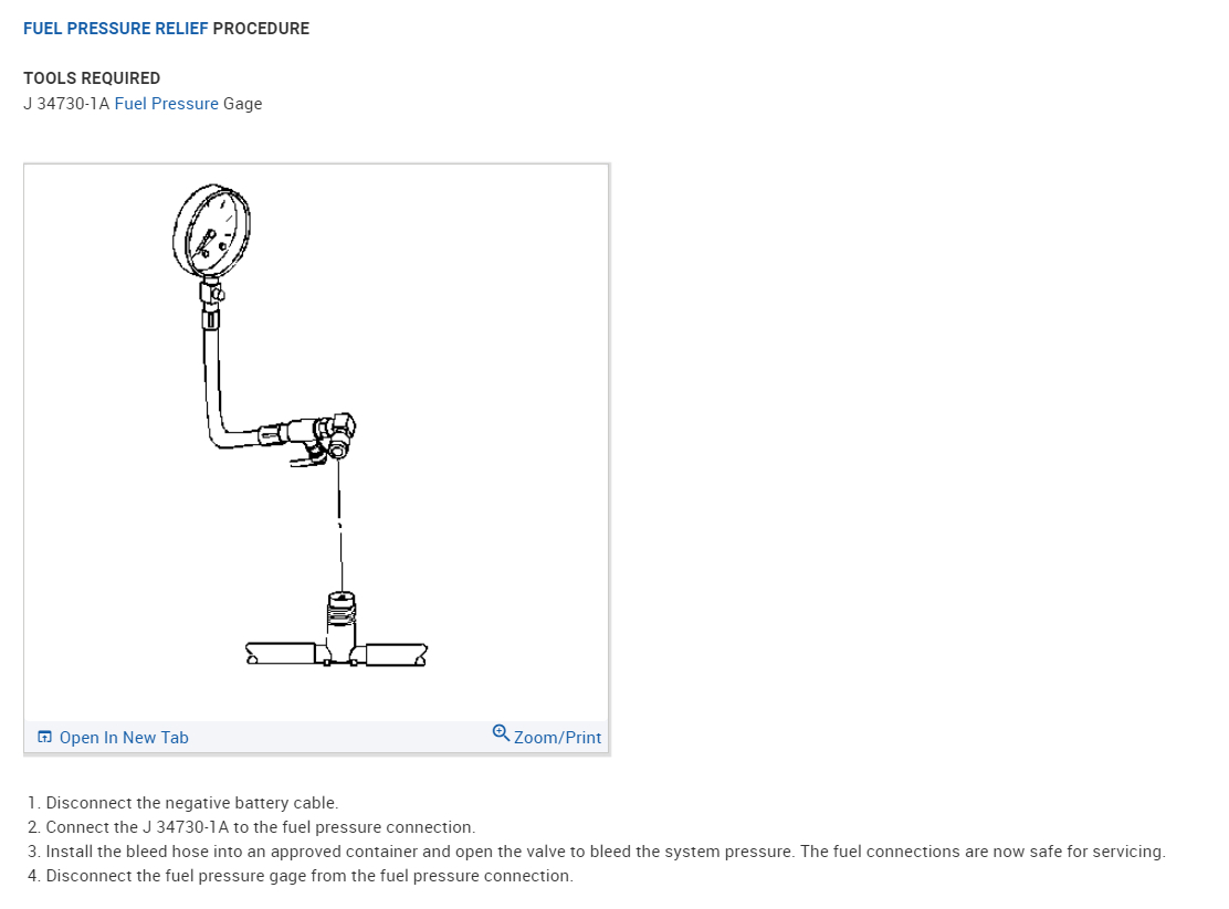

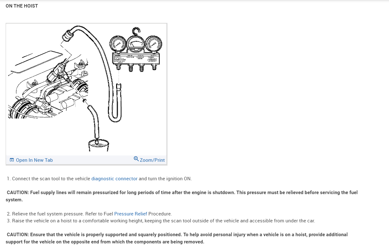

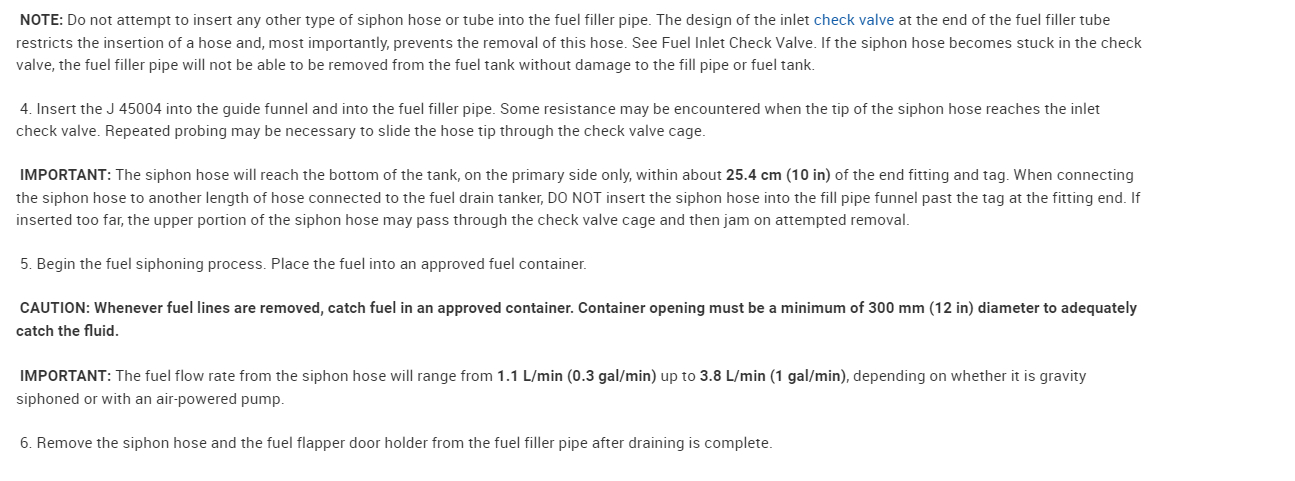

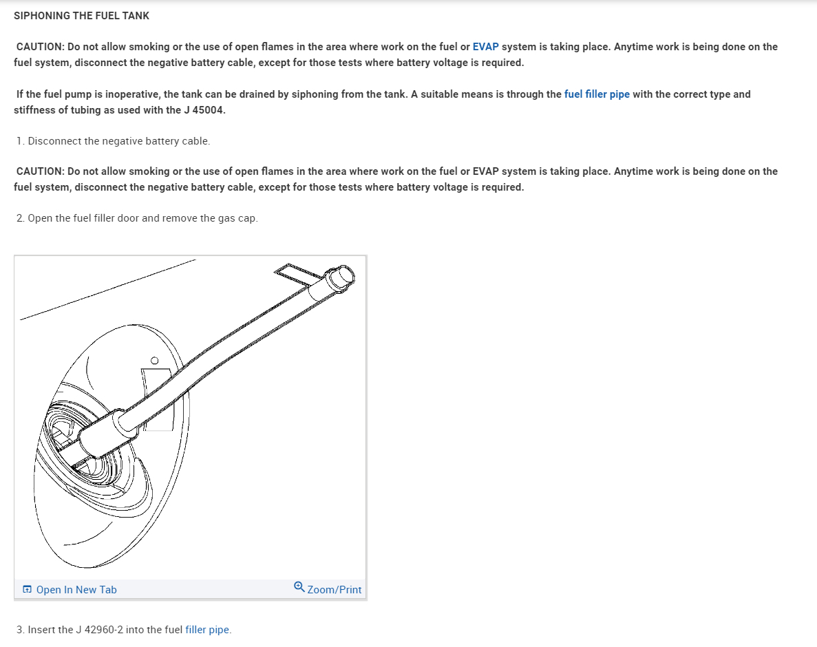

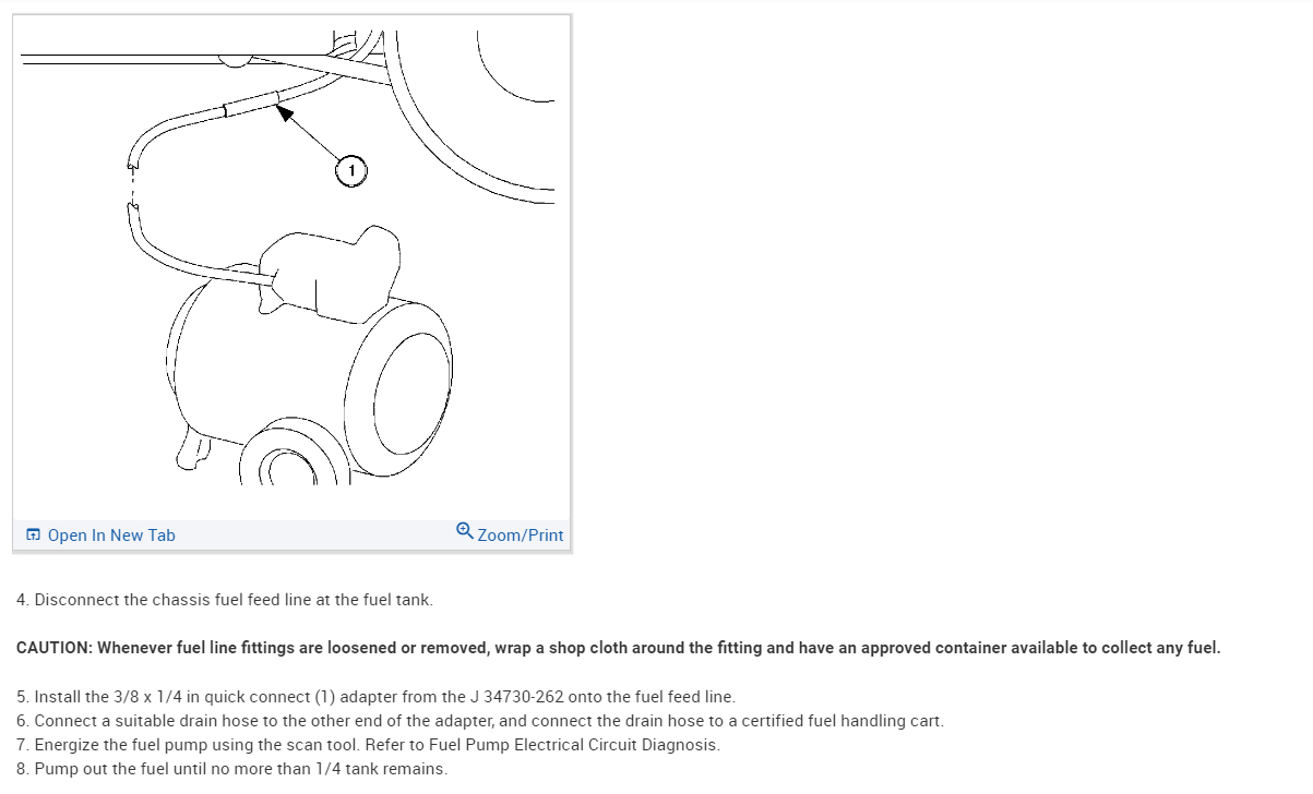

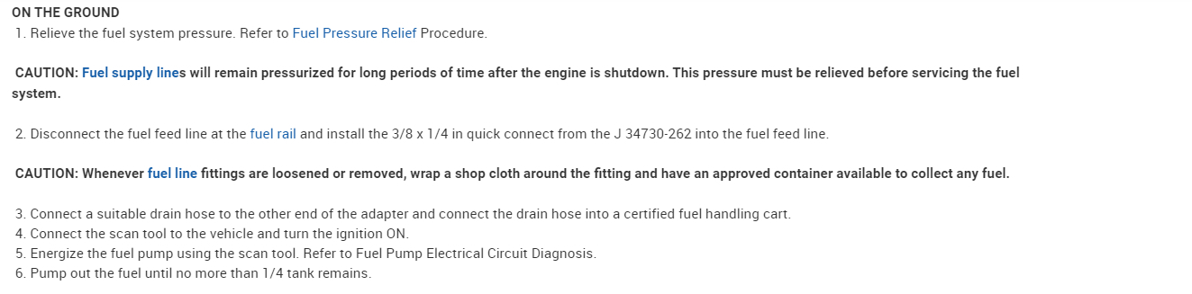

AL514
  • 5,464 POSTS

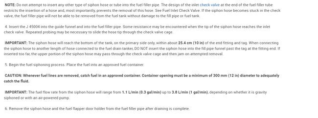

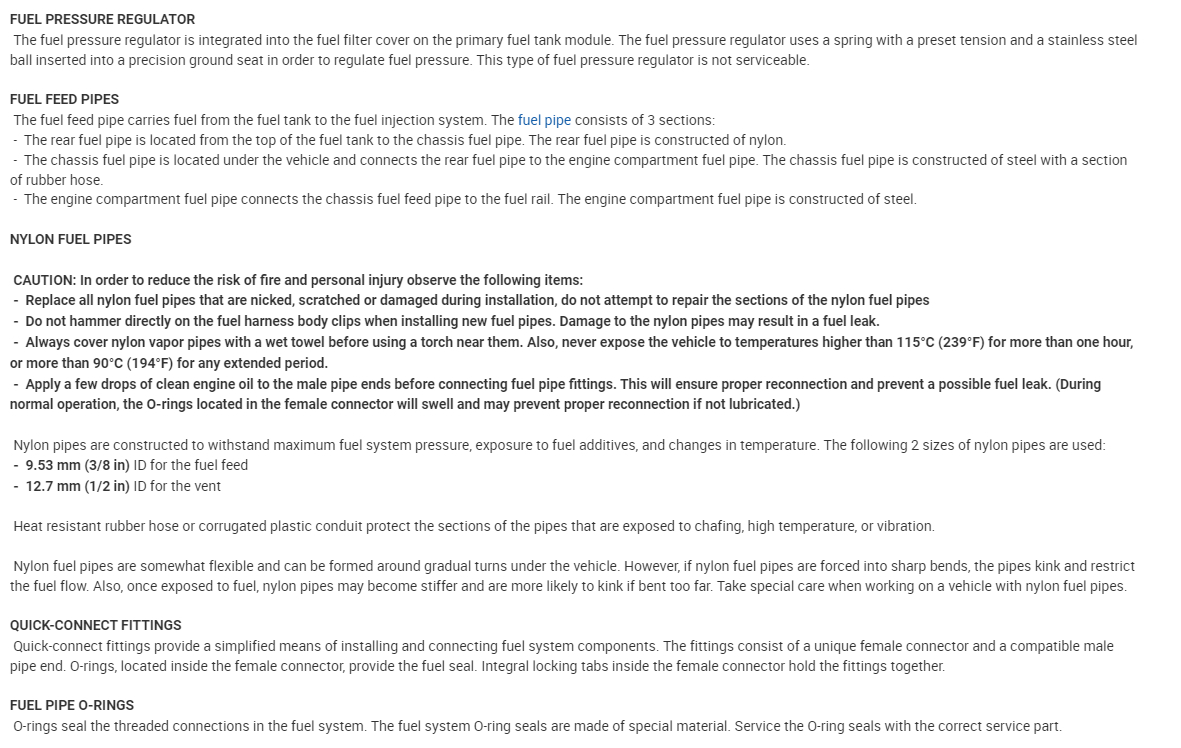

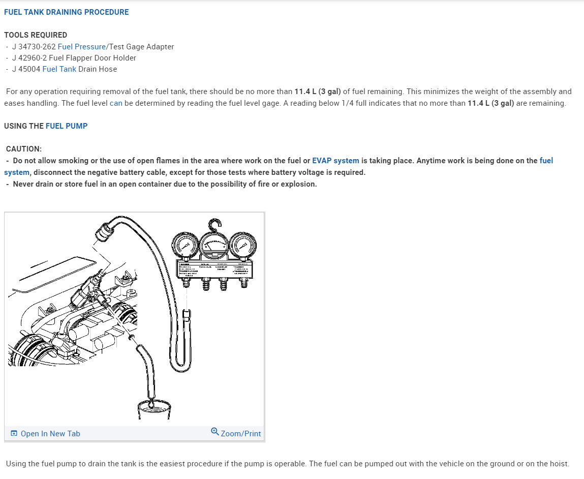

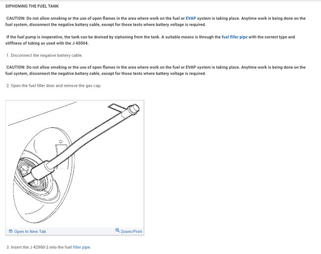

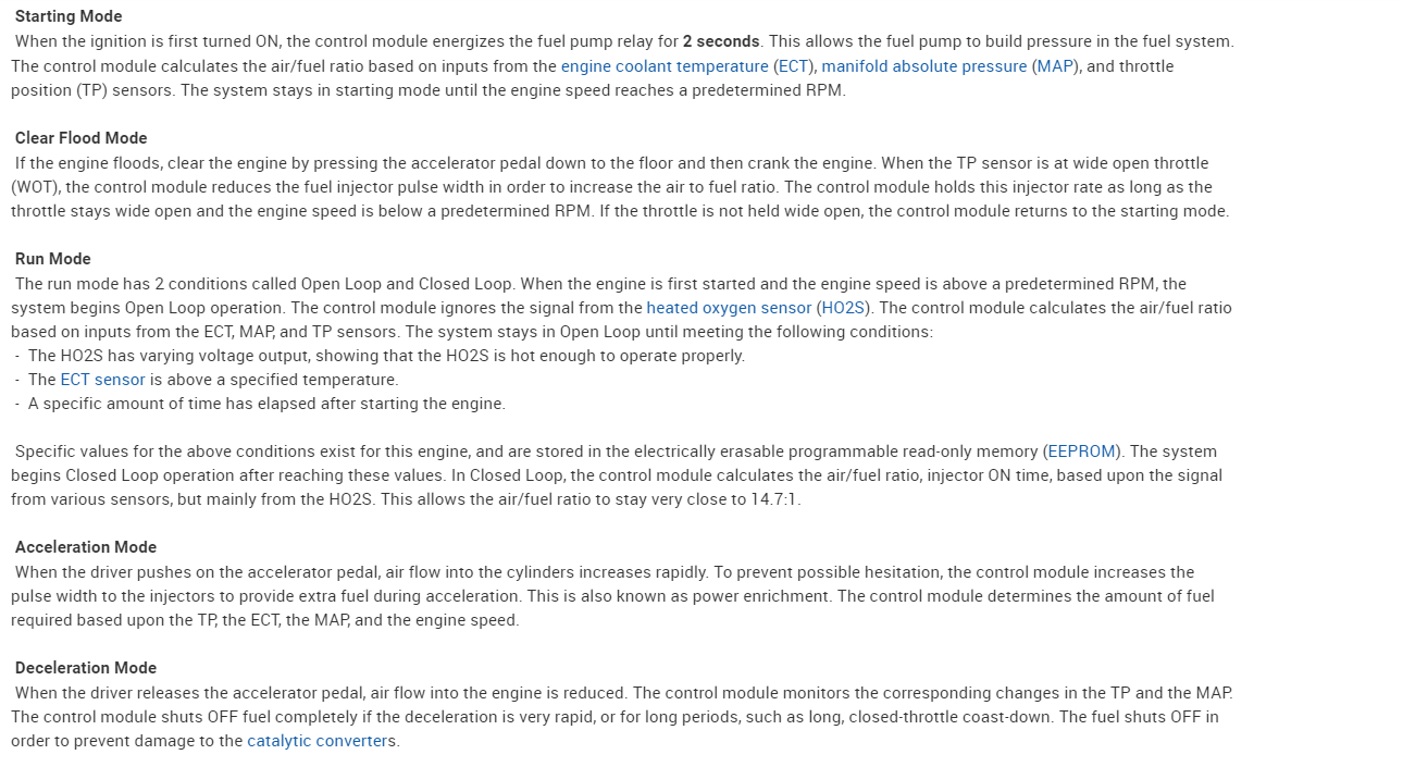

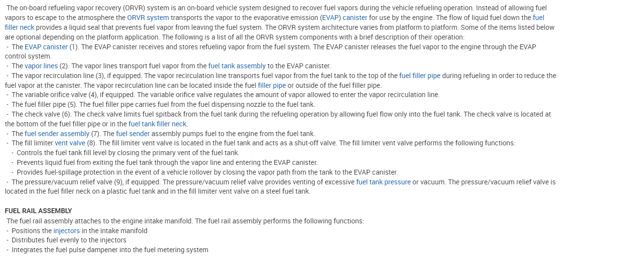

Here is the process for fuel pressure relief and draining the tank. And then pretty much all the service information on this fuel system and operations. I don't see any access to the fuel pump assembly, so it looks like the tank needs to be dropped.
There are quite a few Fuel System Technical Service Bulletins, so if you are having some specific issue, it would be good to look that up before dropping the tank.
