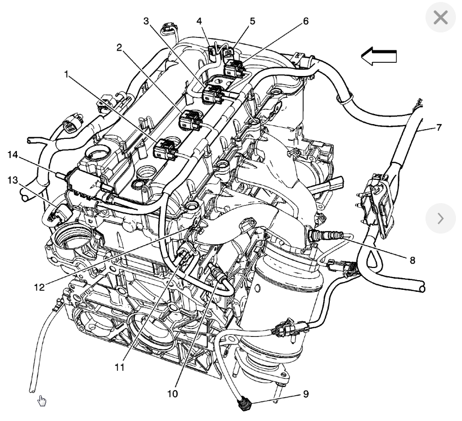

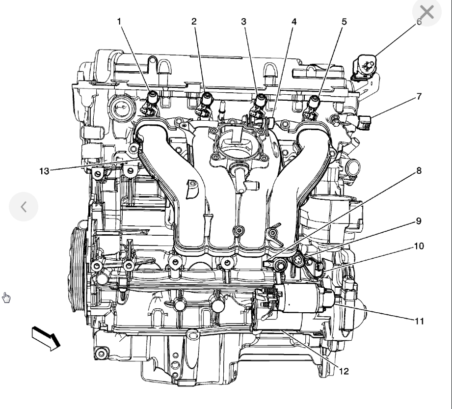

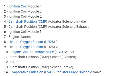

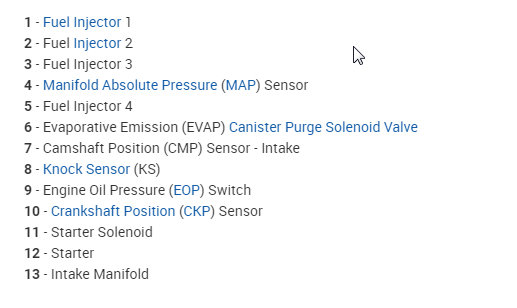

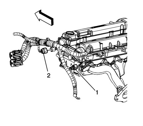

Assuming your vehicle is the same, here are some location diagrams. If you have more questions or can't find it, please start a new post and we will help with whatever you need. Thanks
