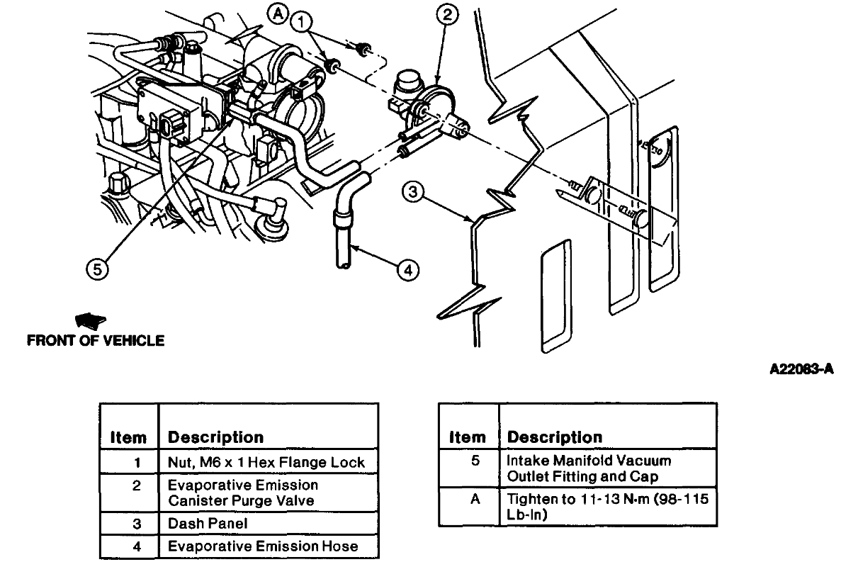

I need to locate and replace the purge valve/ solenoid on the van listed above made in February.
Jul 4, 2023 at 6:37 AM
Yes, the EVAP purge valve is under the hood near the IAC motor, here is the location and how to change it out. Check out the images (below). Please let us know if you need anything else to get the problem fixed.
