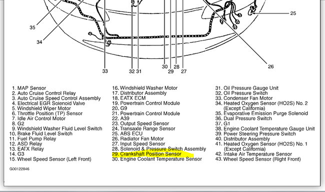

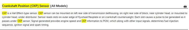

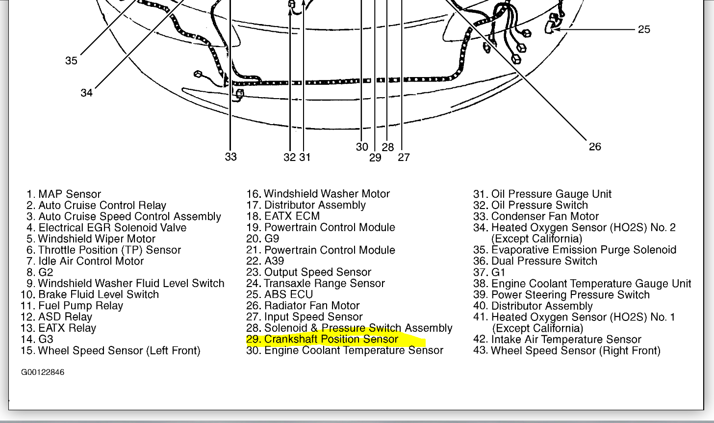

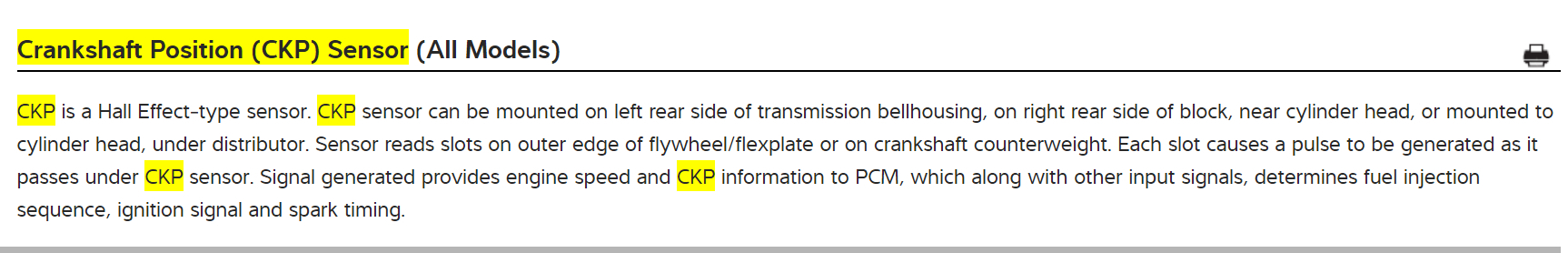

Hello again,
Okay, this is probably going to be a problem with your vehicle's Crankshaft Position Sensor (CKP). In the diagrams down below i have included a description of the CKP and where it is located on your vehicle. Please go through these guides and get back to us with what you are able to find out.
Thanks,
Alex
2CarPros

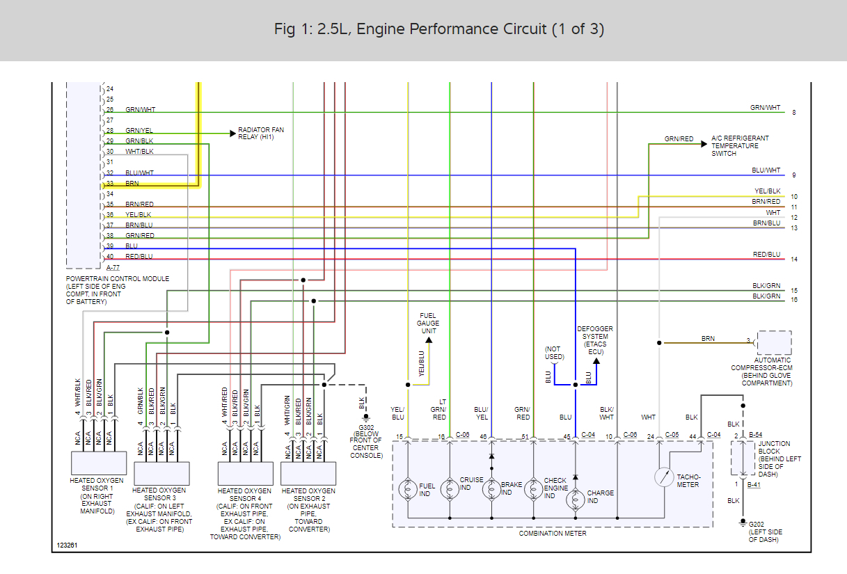

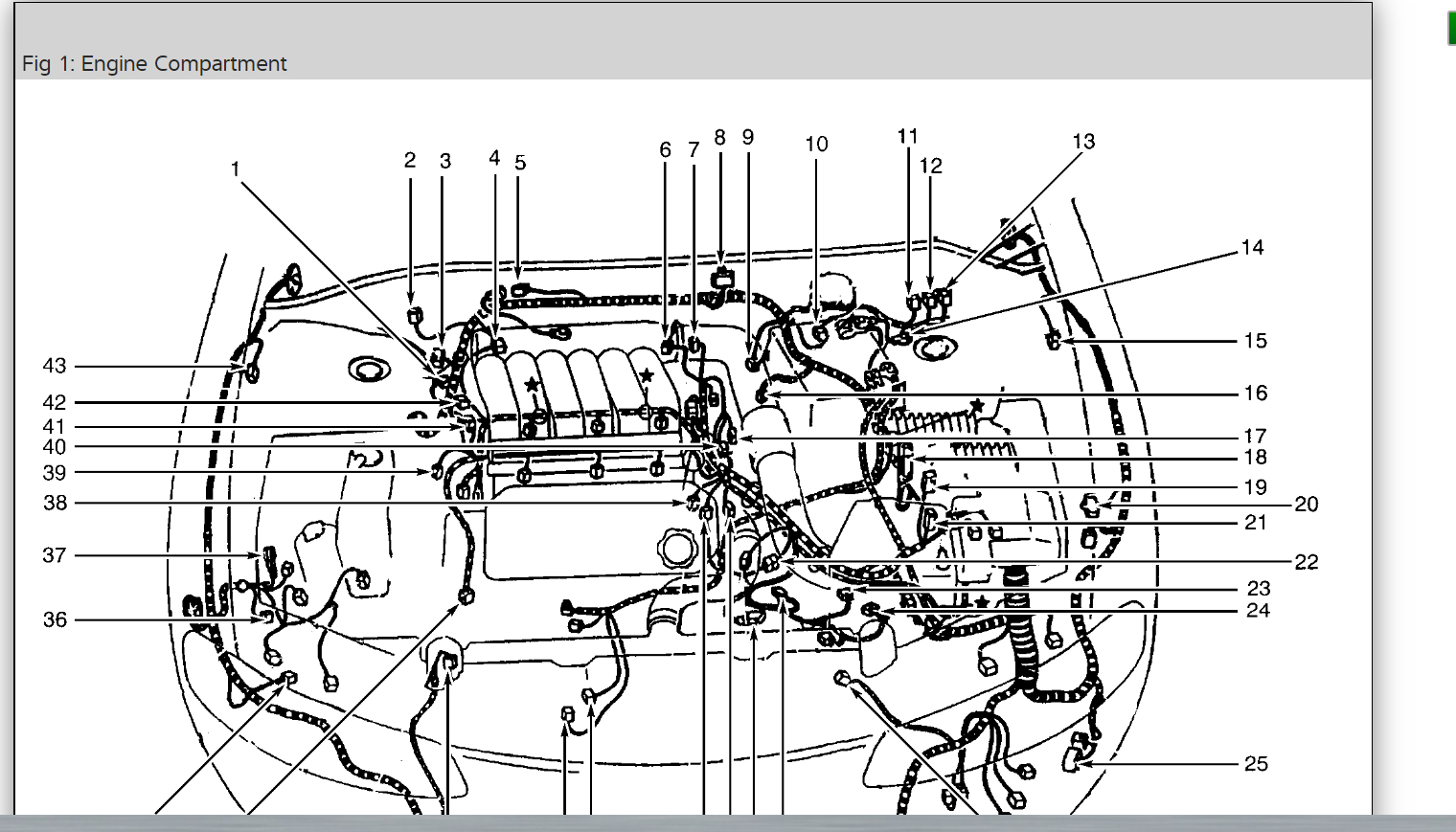

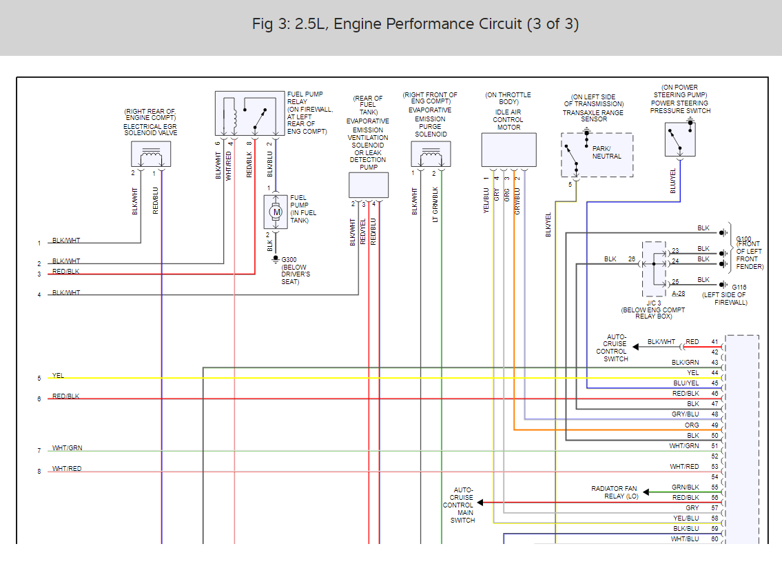

I checked the sensors and they work and engine shutdown relay works also still no spark and no fuel.
Jul 13, 2019 at 5:58 AM
SCGRANTURISMO
  • 4,897 POSTS

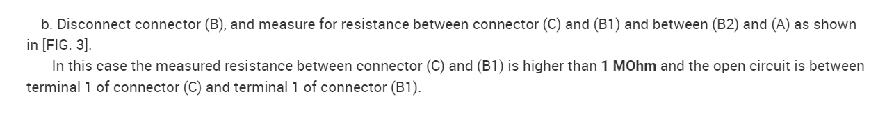

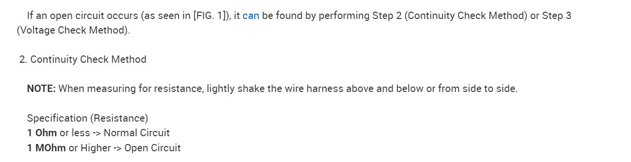

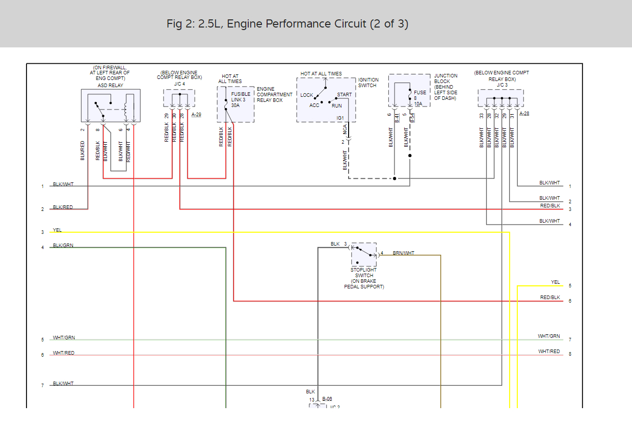

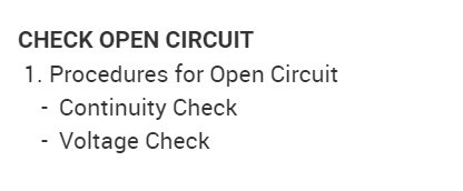

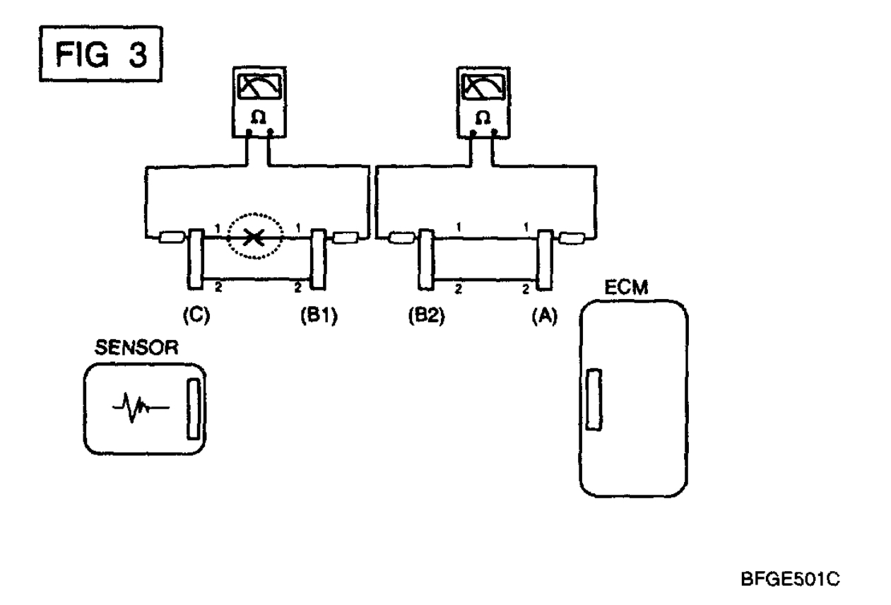

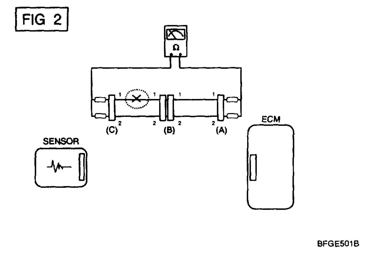

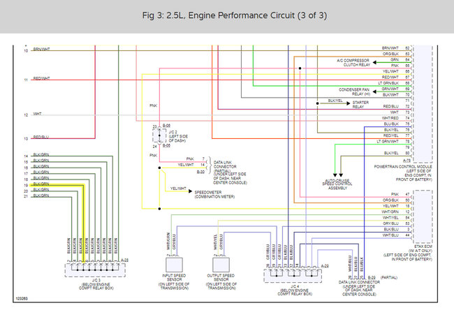

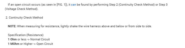

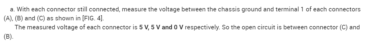

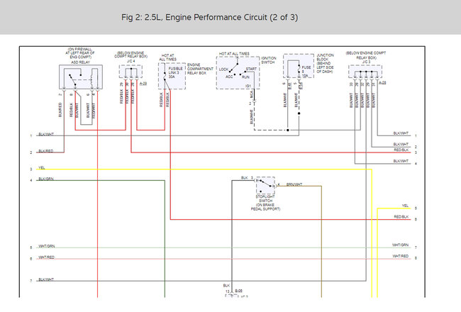

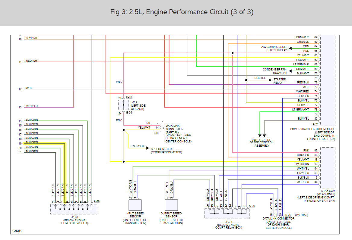

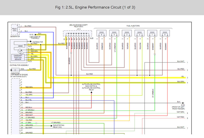

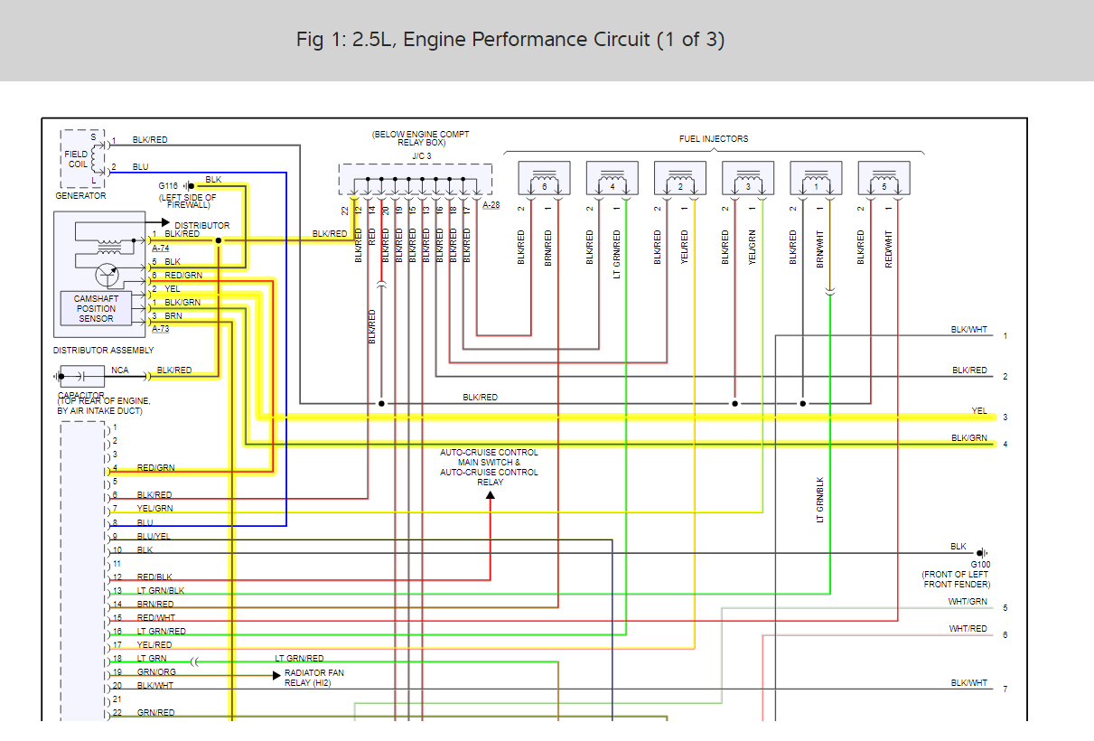

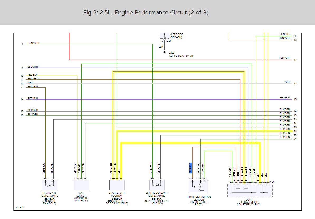

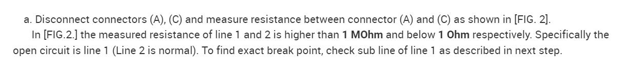

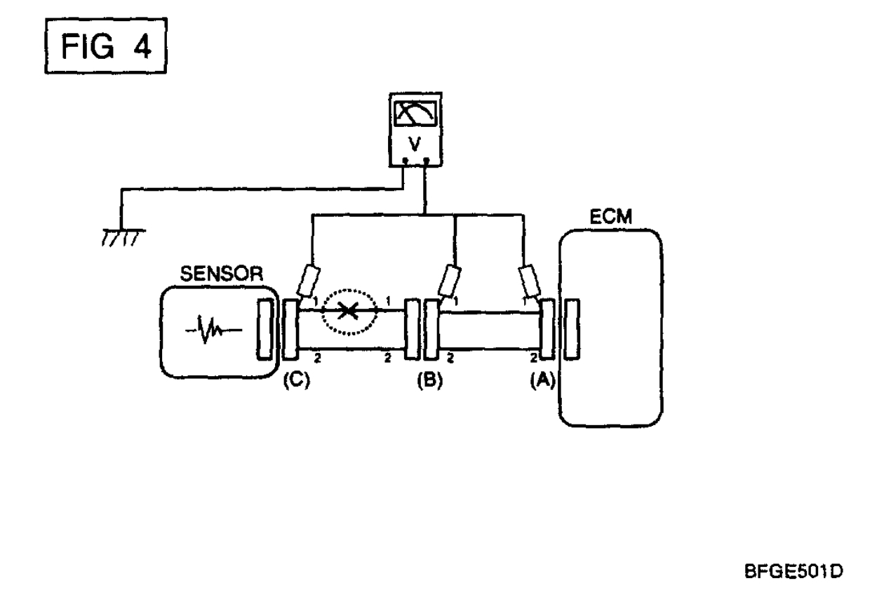

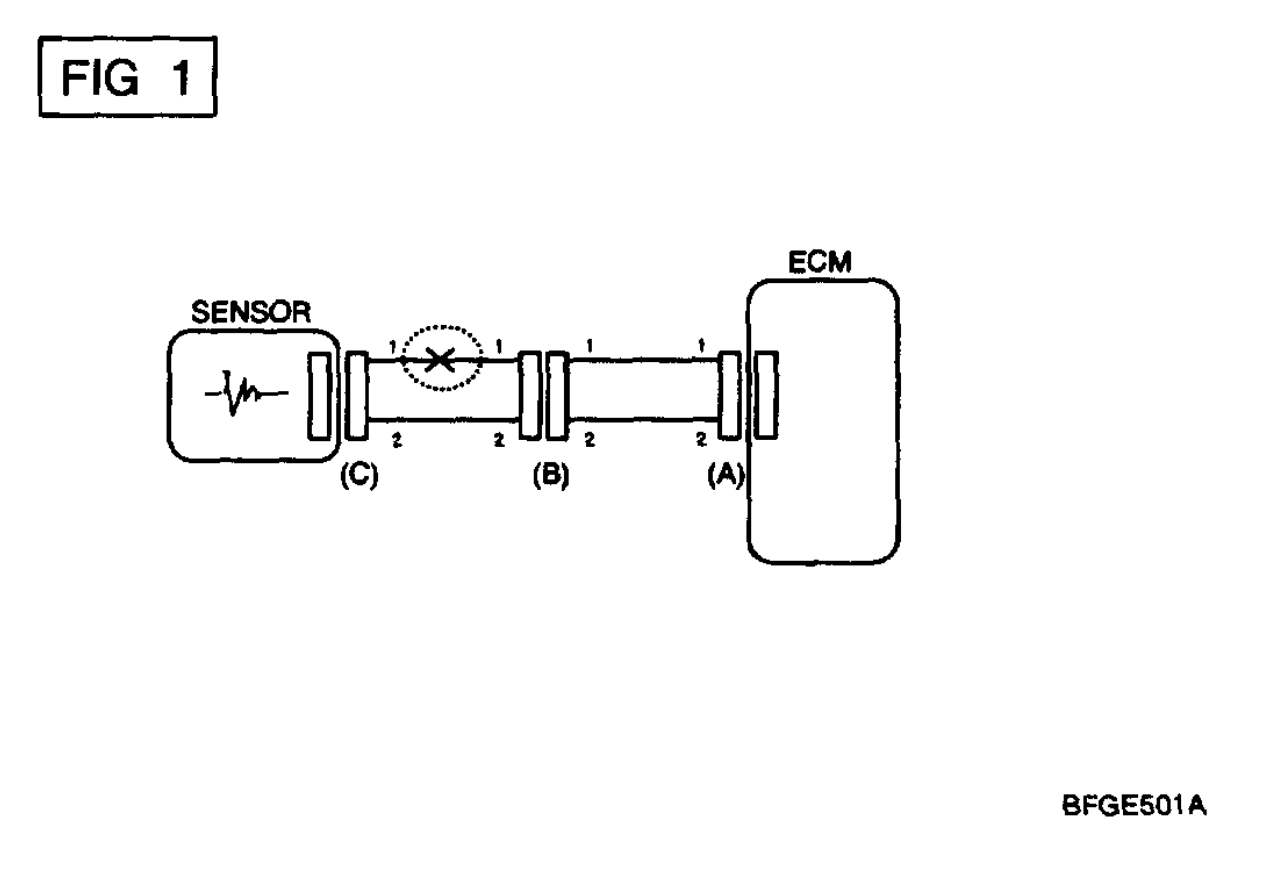

Hello again,
Okay, then you probably have an open or unwanted resistance somewhere in the CKP circuit or the Camshaft Position Sensor (CMP) circuit. In the diagrams down below I have included the CKP and CMP circuit's wiring diagram as well as instructions for finding an open in an electrical circuit. Please go through these guides and get back to us with what you are able to find out. You will need to use a multi-meter, so I have included this link for you below as well if you are unfamiliar with how to use one.
Thanks,
Alex
2CarPros
