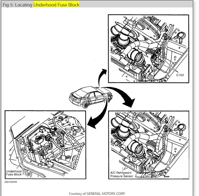

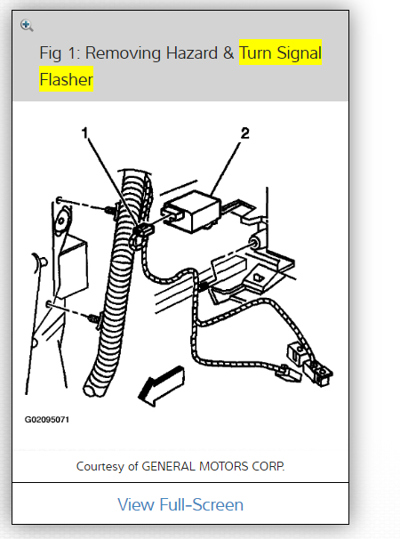

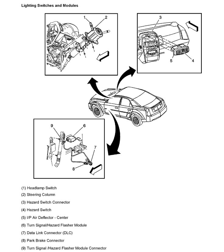

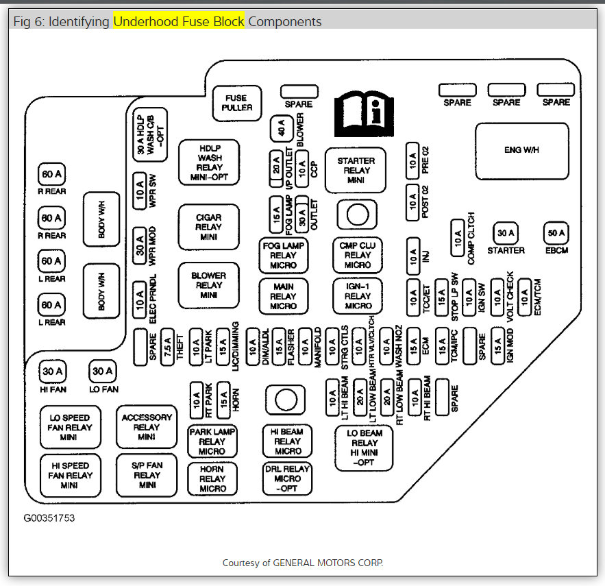

It sounds like you have a voltage surge which took out the flasher module. here is the location so you can replace it. Check out the diagrams (below). Please let us know what happens.
Jul 5, 2019 at 5:42 PM
AUTUMNLYONS23
That didn't work. We replaced it and they're still blinking.
Jul 16, 2019 at 11:54 AM

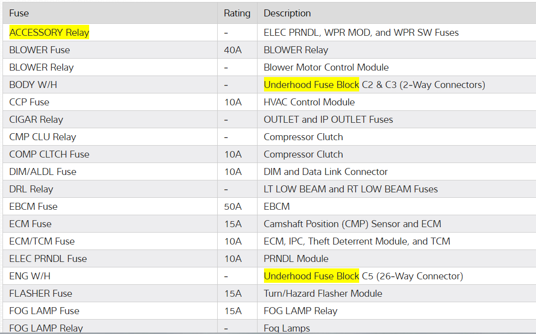

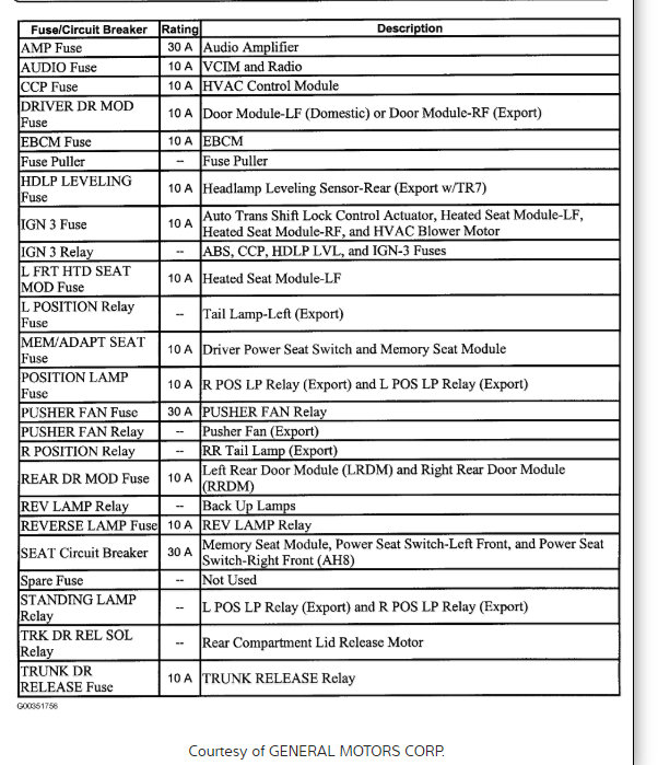

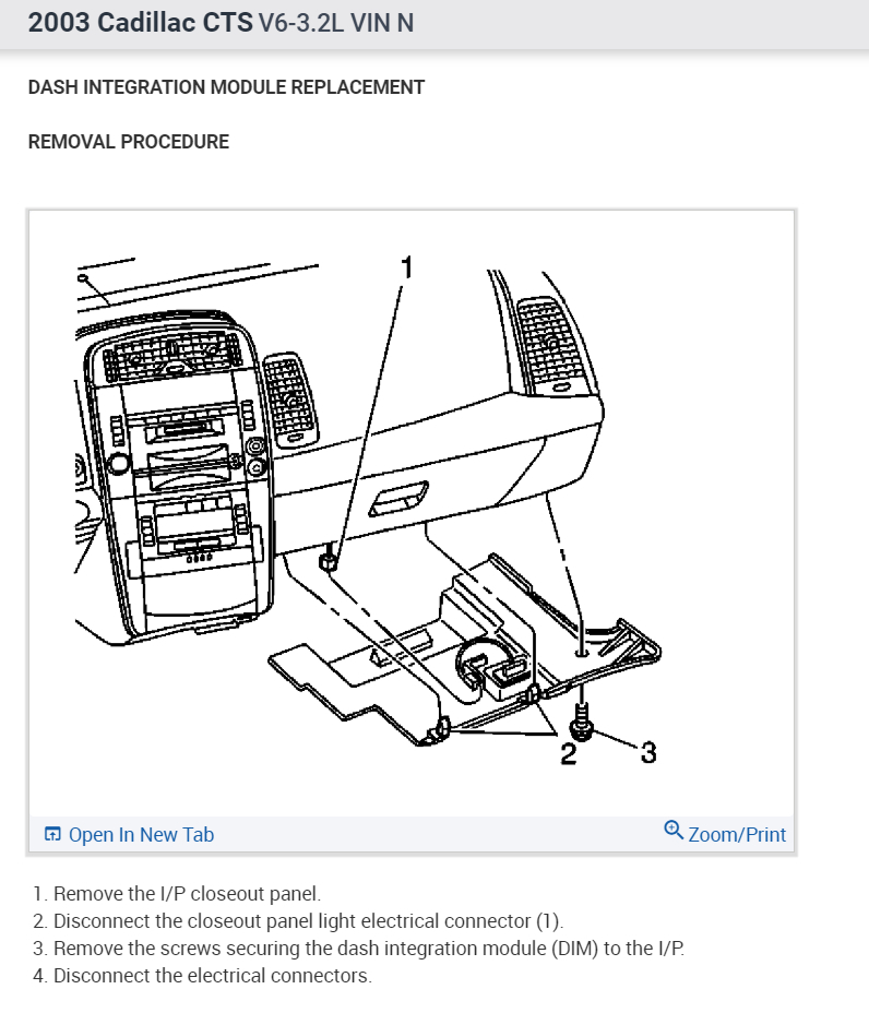

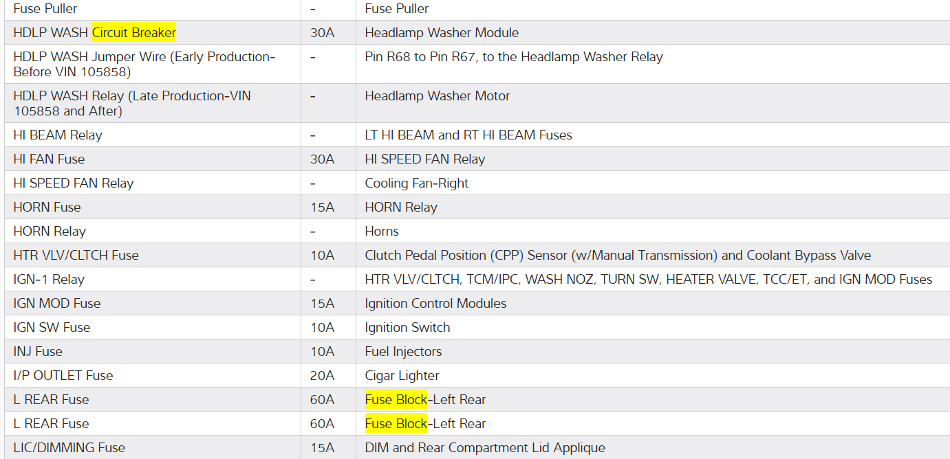

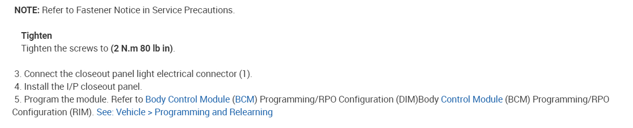

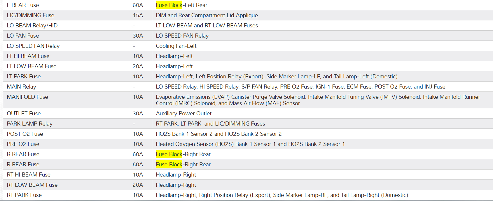

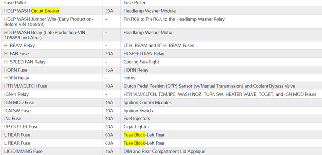

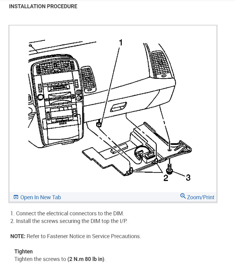

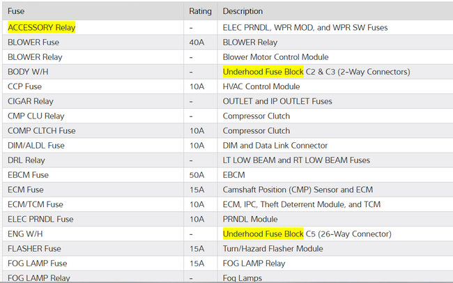

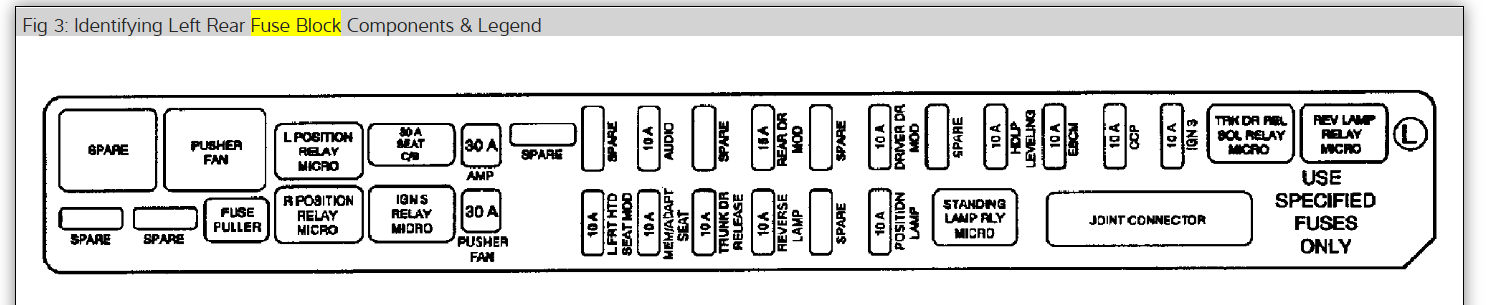

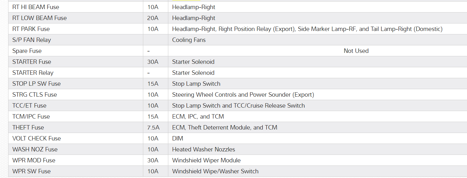

The other module is the DIM and a little more difficult, also I should have had you check the fuses as well my bad. Here is a guide and the fuse locations please check them all key on. Here is the DIM module location as well with instructions on how to change it out. Check out the diagrams below.
BODY CONTROL MODULE (BCM) PROGRAMMING/RPO CONFIGURATION (DIM)
PROCEDURE TO SET UP A DASH INTEGRATION MODULE (DIM)
IMPORTANT: The Air Bag Indicator light may remain ON after the DIM Module is replaced and during the programming procedure for the DIM until after the procedure is completed and the ignition key is cycled OFF and ON.

17. Cycle the ignition key OFF for 5 seconds, then ON to complete the procedure.
IMPORTANT: After programming, perform the following to avoid future misdiagnosis:
1. Turn the ignition OFF for 10 seconds.
2. Connect the scan tool to the data link connector.
3. Turn the ignition ON with the engine OFF.
4. Use the scan tool in order to retrieve history DTCs from all modules.
5. Clear all history DTCs.
Check out the diagrams (Below). Please let us know what you find.
