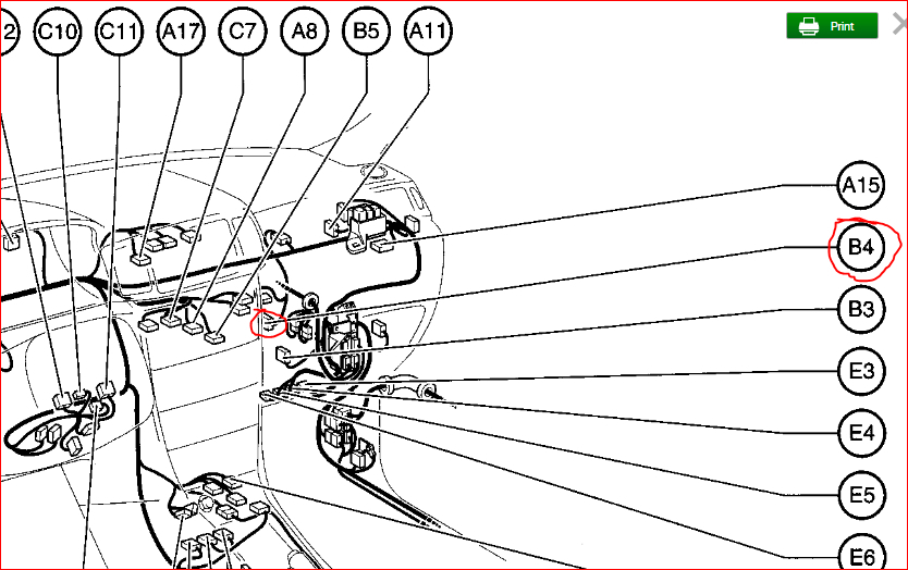

Hello, I'm Danny,
You might want to check the blower motor resistor. I've attached a picture of its location B4 on the picture and circled it in red. Check to see if the connection isn't frayed/burnt/loose/corroded. Here is a few tutorials for you to view as well:
https://www.2carpros.com/articles/blower-fan-motor-works-on-high-speed-only
Hope this helps and thanks for using 2CarPros.

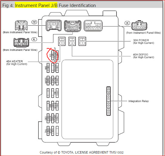

Hello again,
Did you check the Instrument panel I/B fuse location? Here is a tutorial for you on how to check:
I've attached a picture of the I/B box and its location. It's a 10 amp fuse. Hope this helps and thanks again for using 2CarPros.

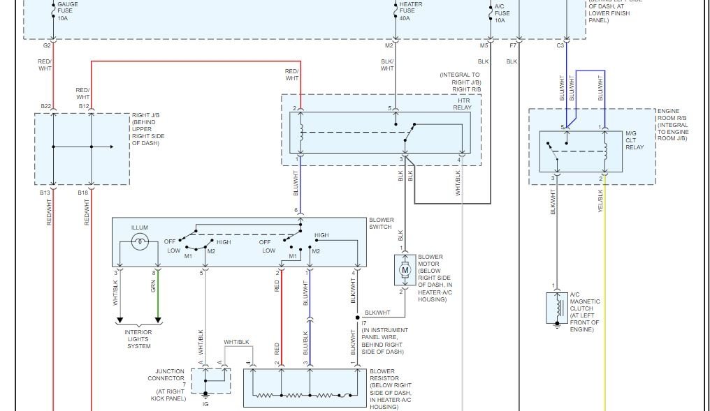

Good afternoon,
I attached a wiring diagram for you to view. there are three fuses at the top. check those fuses for power on both sides with the key on.
beyond that you will need to go to the blower relay to verify power at the relay itself.
