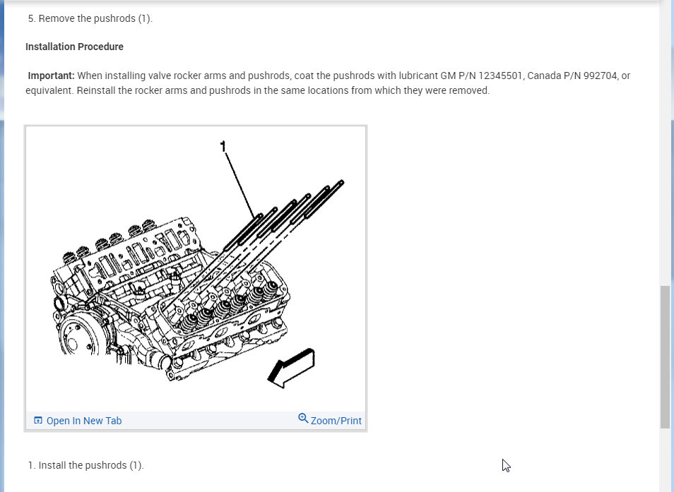

What’s the push rod order on these cars? I’ve replaced my head gaskets I don’t want to put the rockers in the wrong place.
Nov 4, 2019 at 12:08 PM

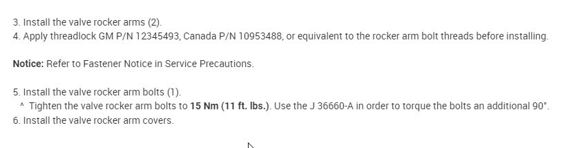

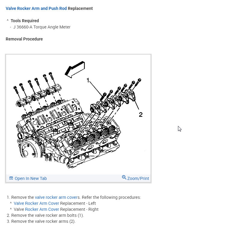

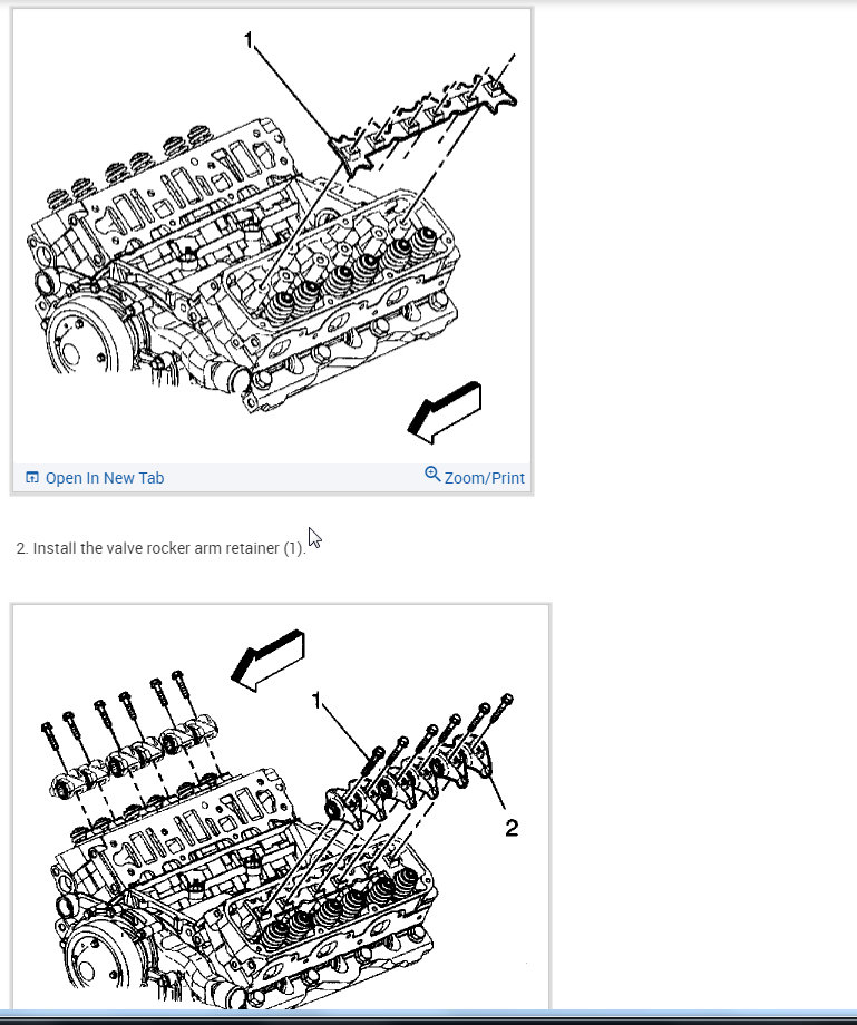

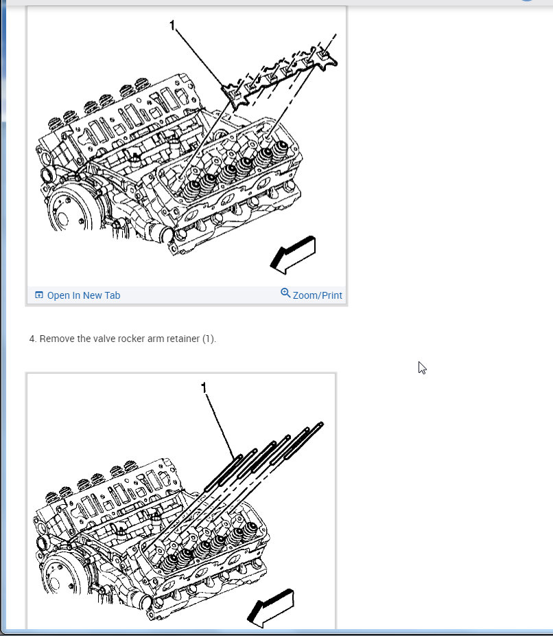

I am not sure I understand the question. The push rods should all be the same but it is always a good idea to reinstall them where they came out of. However, here is the procedure on how to install the rockers and push rods. Let me know if I am missing something. Thanks
