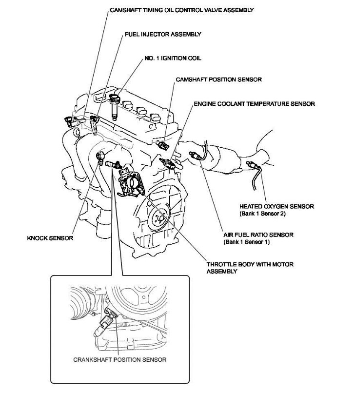

Here is a generic guide to help you step by step with instructions in the diagrams below to show you how on your car:
Check out the images (below). Let us know what happens and please upload pictures or videos of the problem so we can see what's going on.
