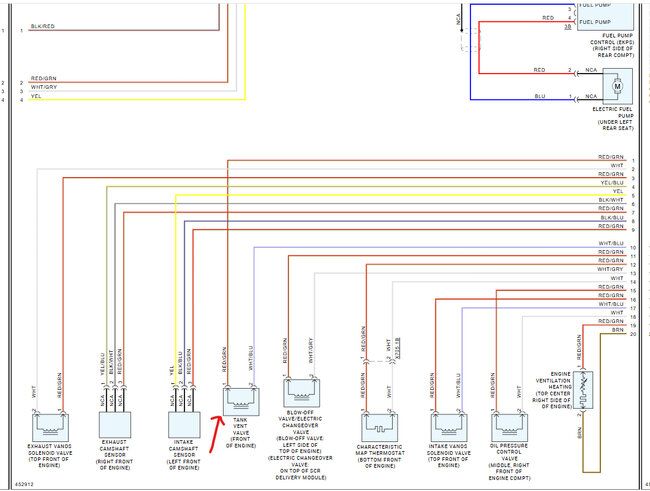

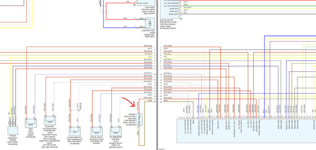

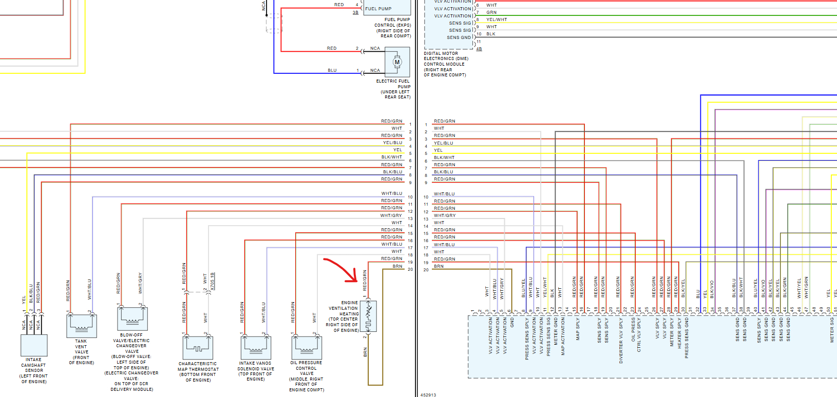

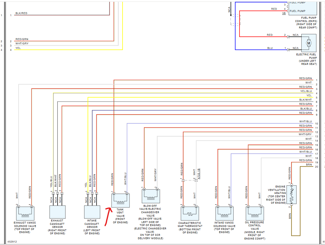

That would be the engine wiring harness. I would use a flashlight to help see where the connector was hidden. I think they call it an engine ventilation heater. Here it is in the engine wiring diagrams below.

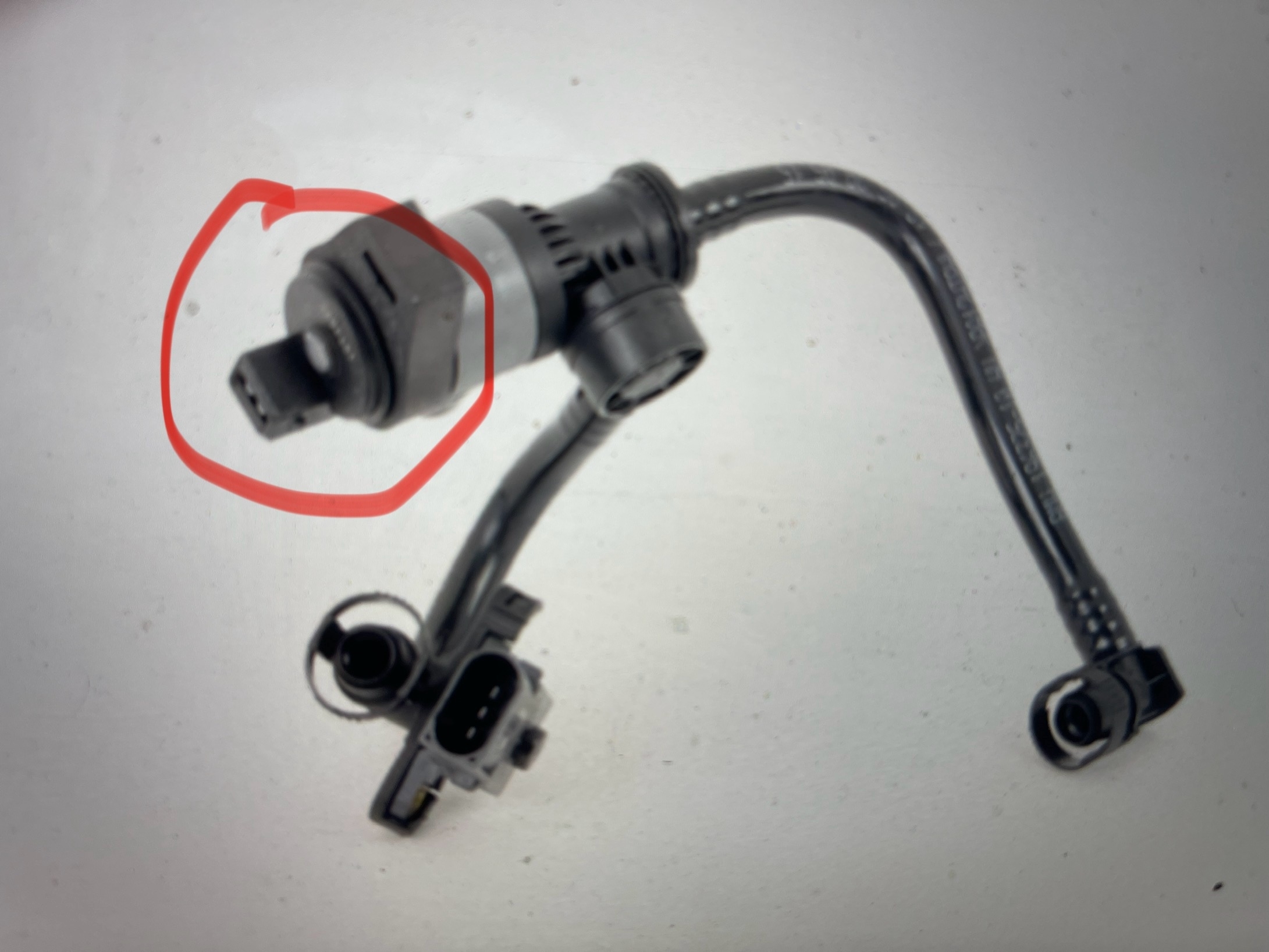

that's what I thought. I found this tank vent valve at the front of the engine so this can be it. Check out the images (below). Let us know how it goes.
