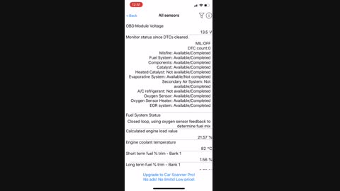

Just to confirm you have no stored fault codes?
Does the vehicle hesitate/misfire under acceleration?
If you have no fault codes i would carry out a power balance test and see if you have any cylinders not contributing.
