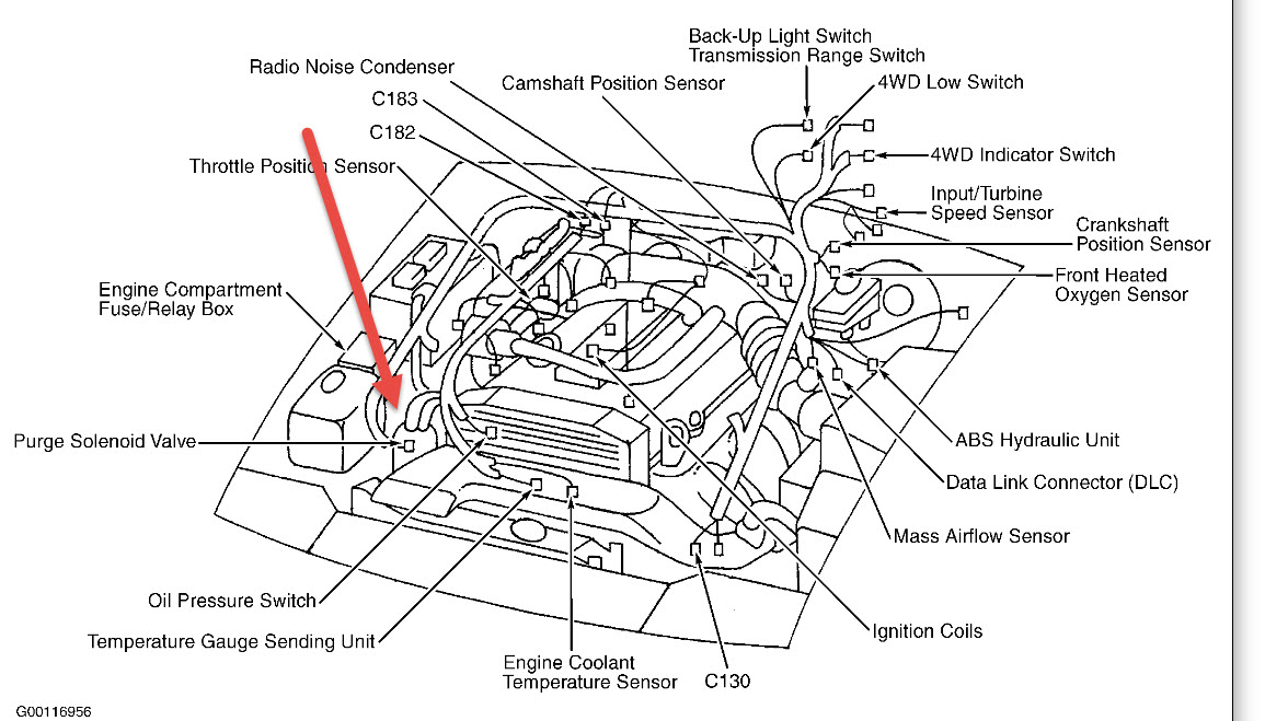

How to remove a purge canister.

see picture where it is mounted. disconnect electrical and vacuum lines. then should be a bracket holding it bolted to frame.
