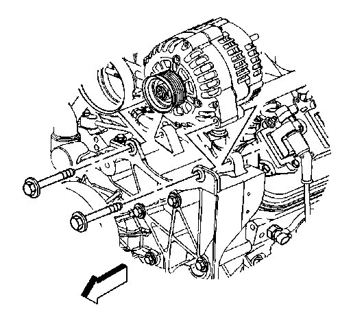

Hi and thanks for using 2CarPros.com. It sounds like the alternator/regulator is bad. Here are general directions for checking:
Here are general directions for replacement:
https://www.2carpros.com/articles/how-to-replace-an-alternator
Here are directions and pictures for replacement specific to your vehicle:
Disconnect the negative battery cable.
Remove the accessory drive belt.
If necessary, remove the engine sight shield.

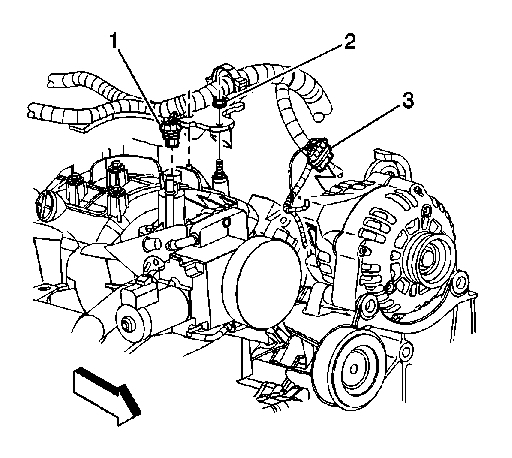

Disconnect the generator electrical connector (3).

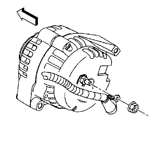

Remove the generator cable from the generator, perform the following:
Slide the boot down revealing the terminal stud.
Remove the generator cable nut from the terminal stud.
Remove the generator cable.

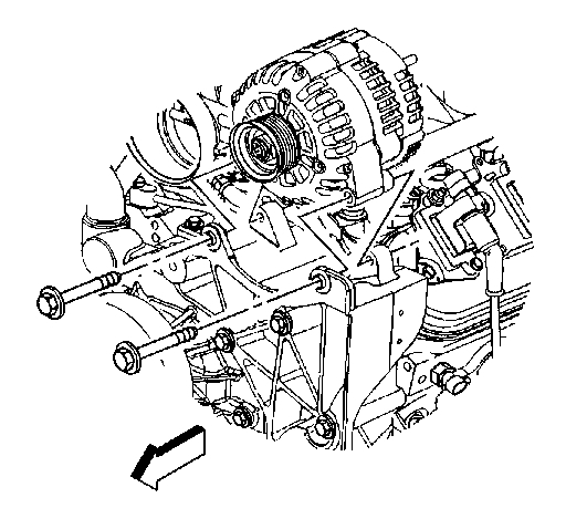

Remove the generator bolts.
Remove the generator.

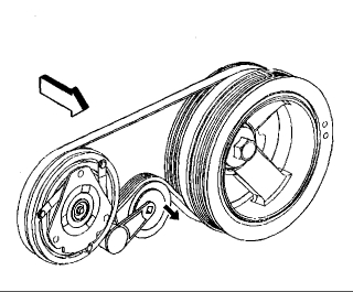

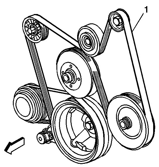

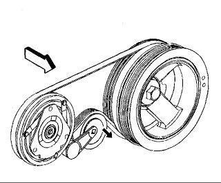

Install the accessory drive belt.
I've also attached belt routing diagrams for you.
If you are uncomfortable testing the alternator with the aforementioned directions, remove it and take it to a parts store. Most stores will check if for free.
