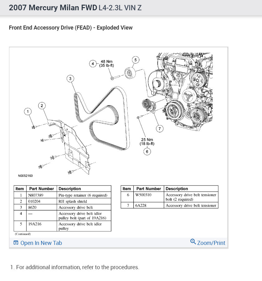

Hello, I want to know if you all have any diagram on how to change an idler pulley on my vehicle listed above.

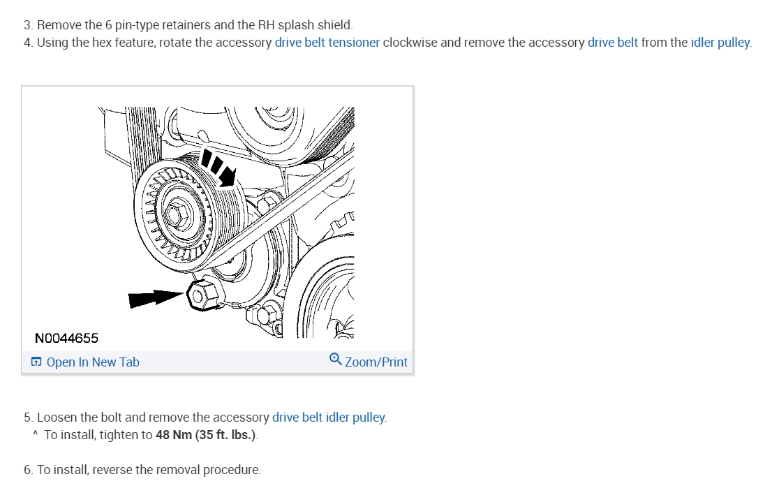

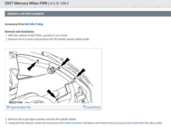

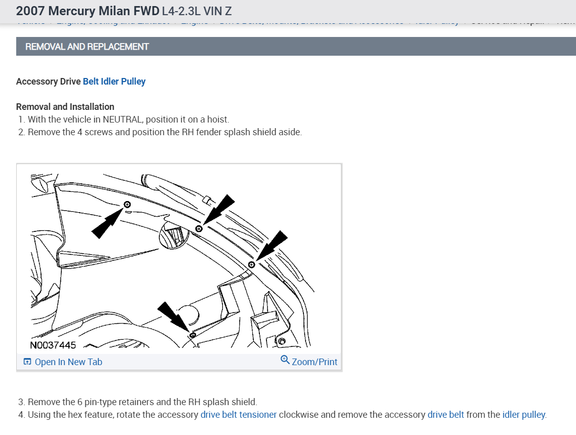

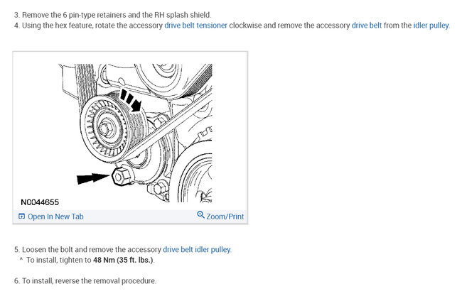

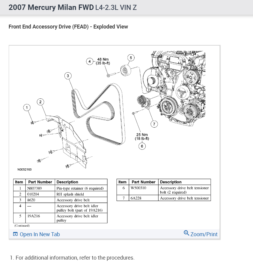

Sure, here are the instructions on how to change out the serpentine belt idler pulley. Check out the images (below). Please let us know if you need anything else to get the problem fixed.

i figure out what's shaking and it's the tensioner pulley.

any idea on how to replace that part?

Yep, check out the instructions in the post above. Let me know if you need any other help.
