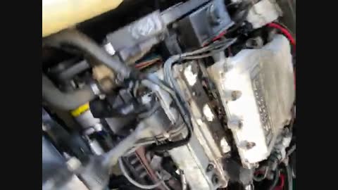

I have the car listed above Cutlass Supreme. It has injector problems at least I think. As I was taking apart the car to get to the injectors I found oil. It wasn’t a little oil it was a lot of oil. It was inside the tube connecting the throttle body and air filter. There was also some inside the throttle body. I cant find a PCV valve. So I’m not sure if I have one or what I should do. Is this even something to be concerned about? Any help would be greatly appreciated thank you in advance.

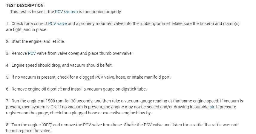

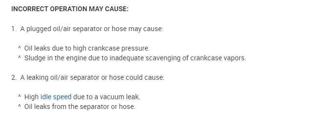

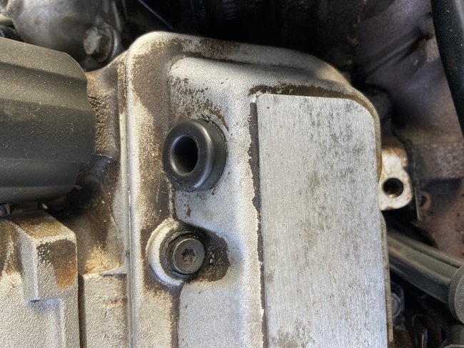

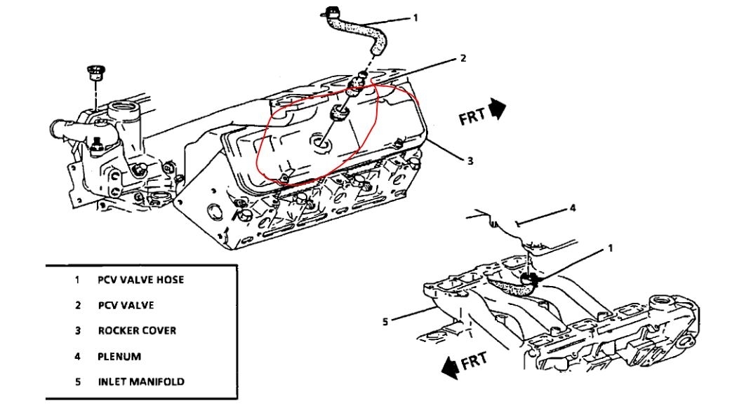

The PCV valve is in the back valve cover. I attached pictures for you.
It may be the valve but I doubt it. I think you have excessive blow-by from worn piston rings that send oil vapors back into the intake system.

I found the PCV it’s completely missing. I think I should buy one and put it in. Thanks again for the help.
Mar 10, 2020 at 4:31 PM
Okay, install the new one and see what happens.

Apologies I made a mistake. I was rushing and didn’t follow the diagram. Apologies for continuing to message you.
