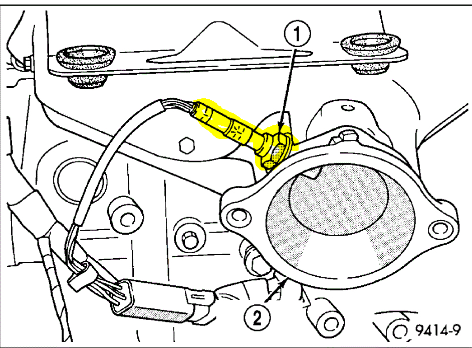

The P0164 is related to a high voltage signal from a third oxygen sensor which this vehicle doesn't have. You didn't indicate turbo, so I am looking through the info for a 2.4L non-turbo.
Did the problem just start after the plugs were replaced? Also, if you remove the oxygen sensor on the exhaust manifold (see pic 1), does the vehicle run any better? If it doesn't, then chances are it isn't a plugged converter.
The code you provided really isn't relevant for this vehicle, so I'm not sure why it's showing. Let me know if this existed before the plugs. If it did, I need you to check fuel pressure. It could be low.

See pic below.
