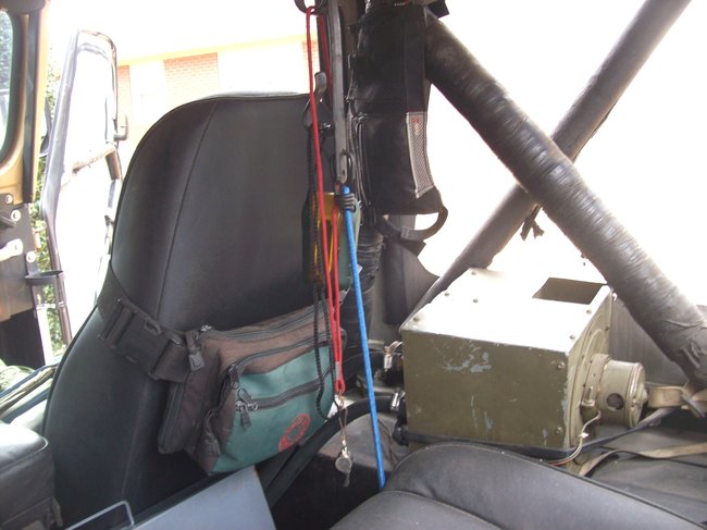

The 195 gives your heater/ defrost more heat, I have the OEM heater and my own "Sahara Breeze" (uses cooling system water too), two heaters are better than one and temperature is important!)
