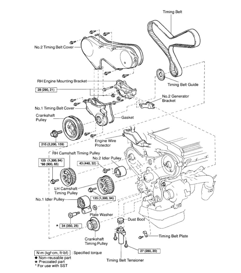

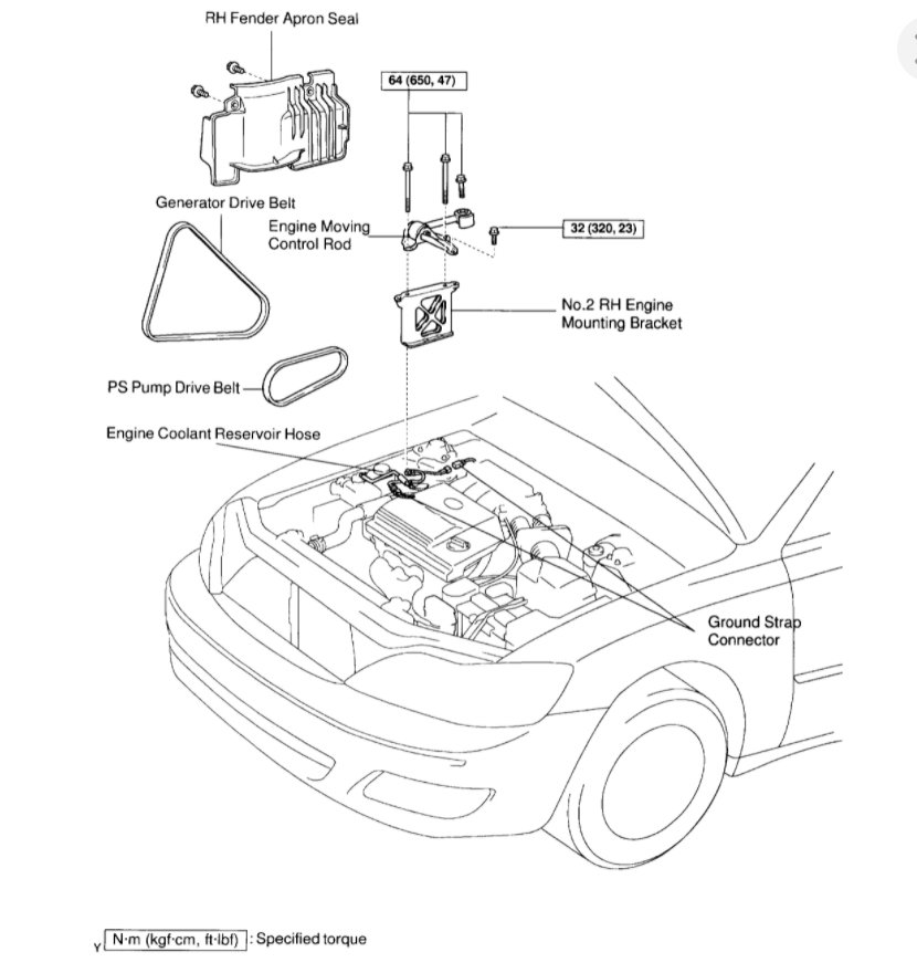

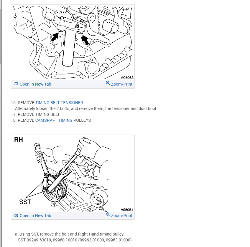

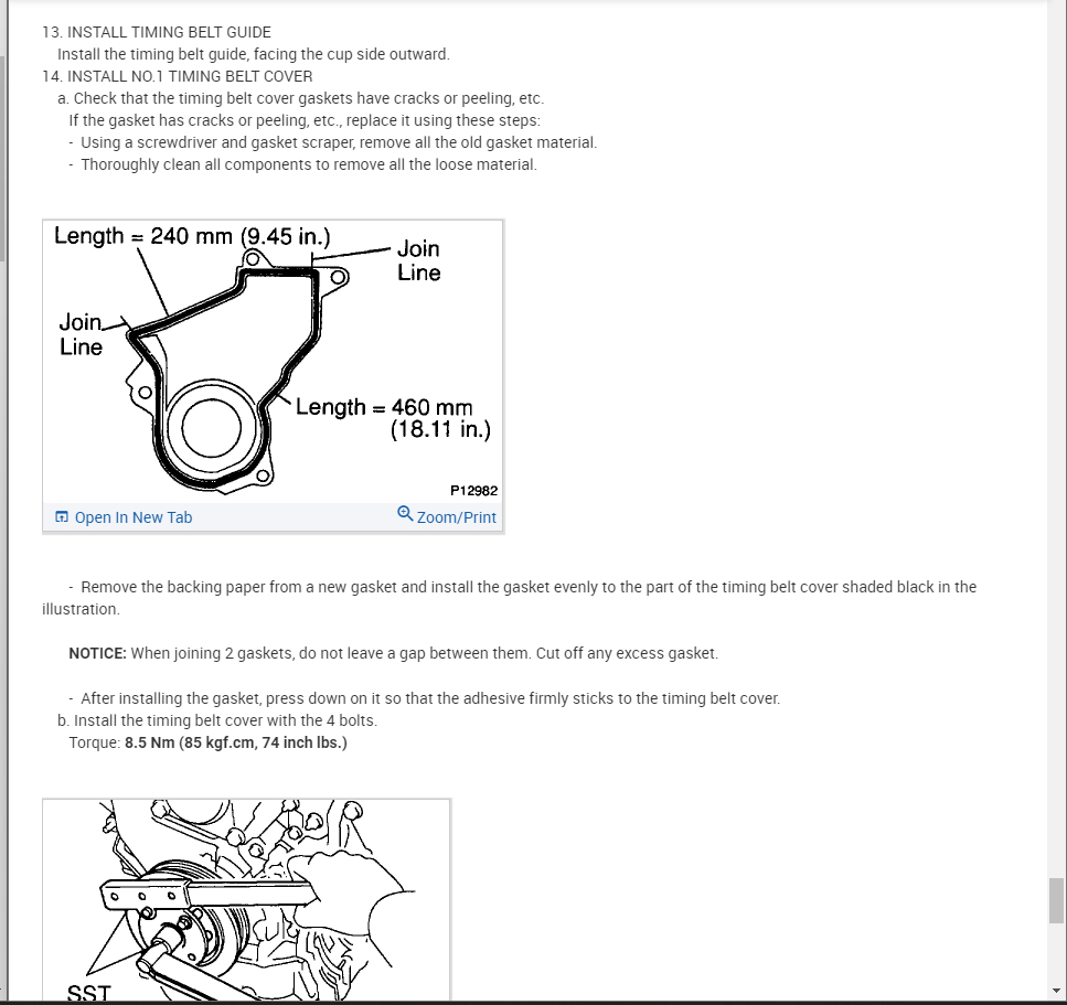

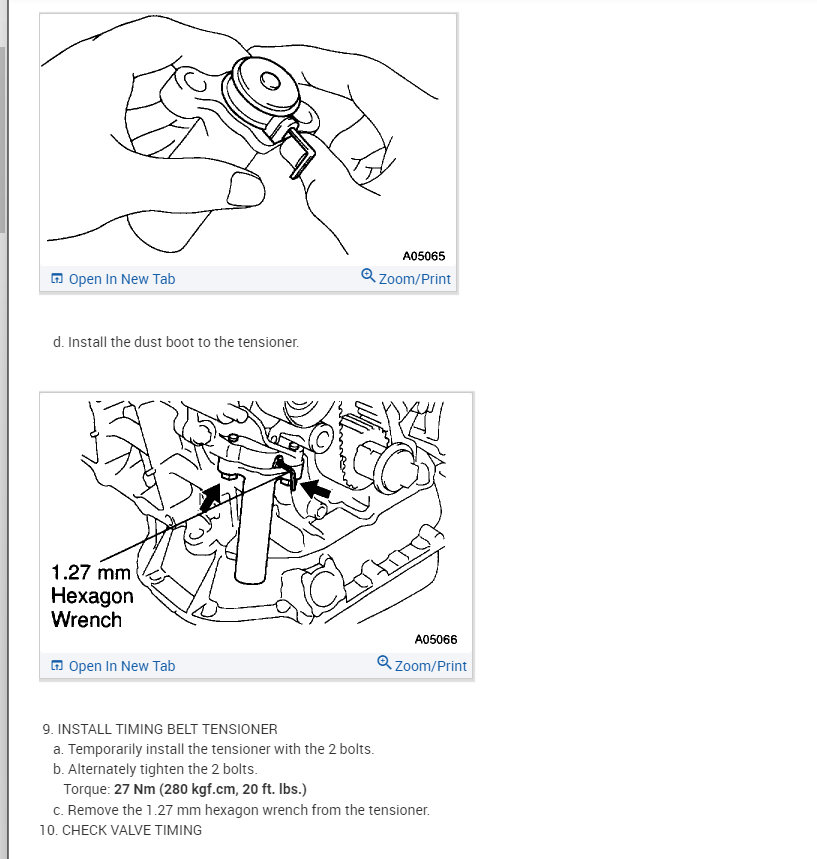

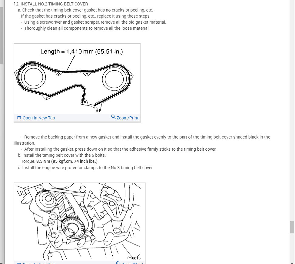

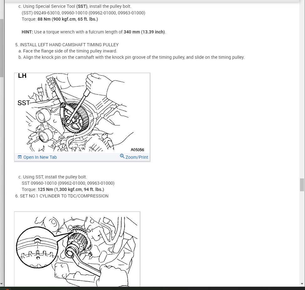

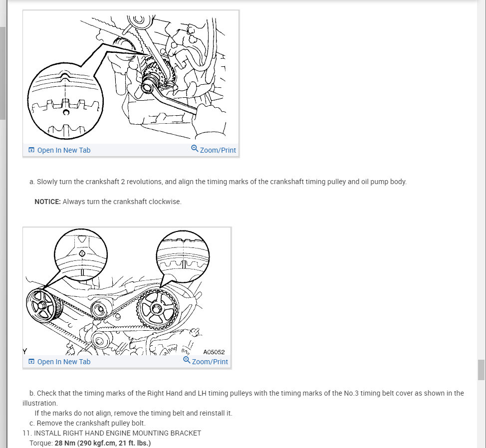

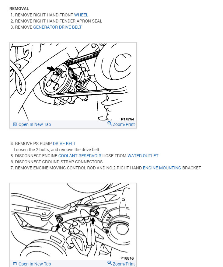

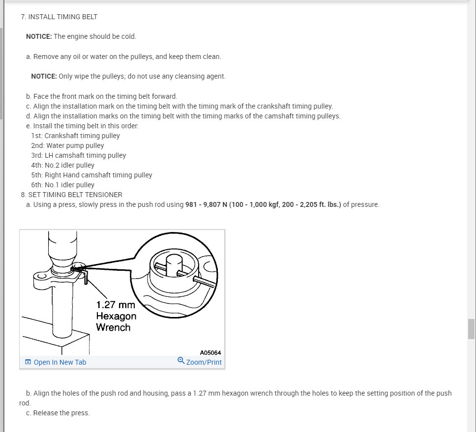

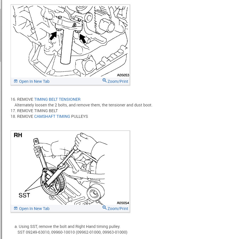

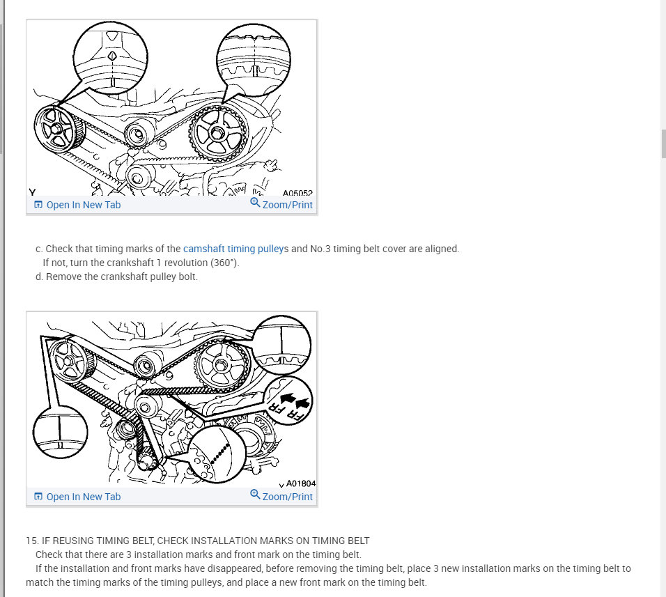

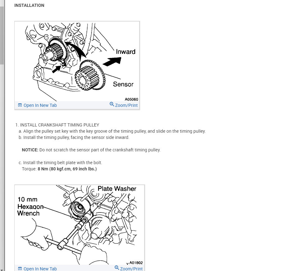

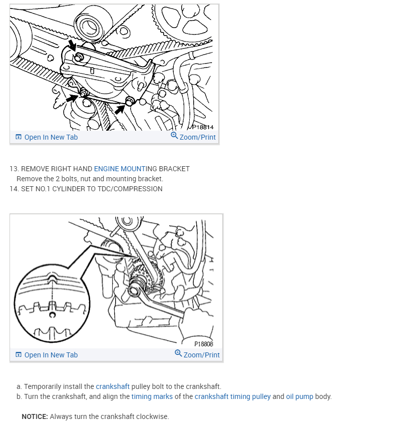

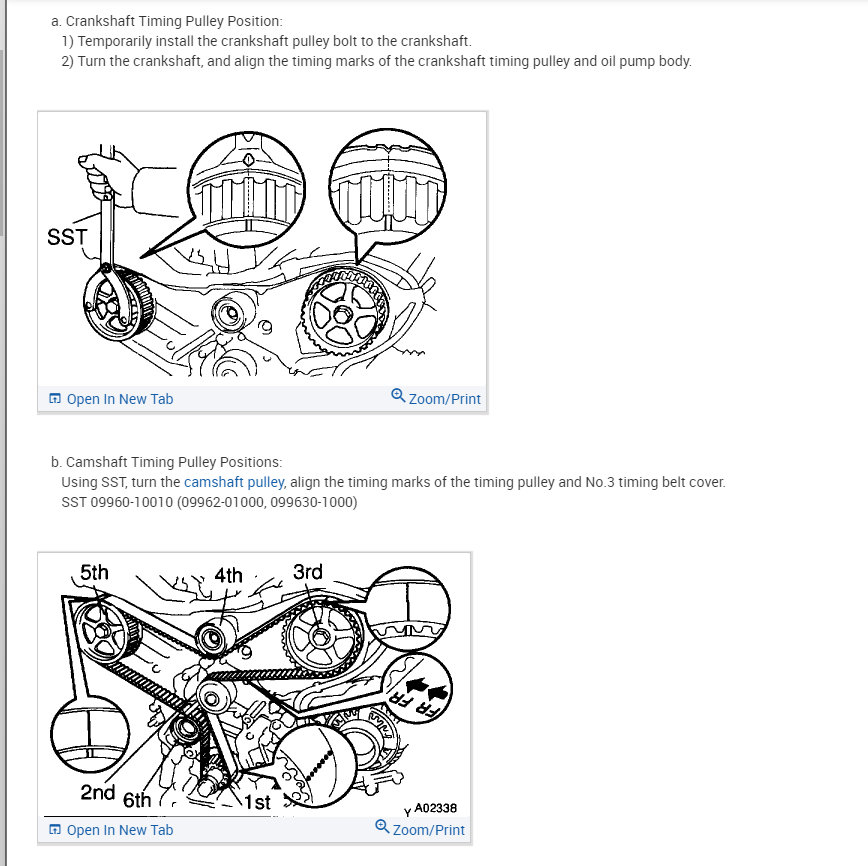

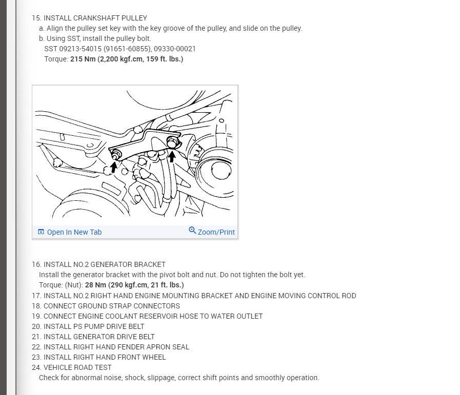

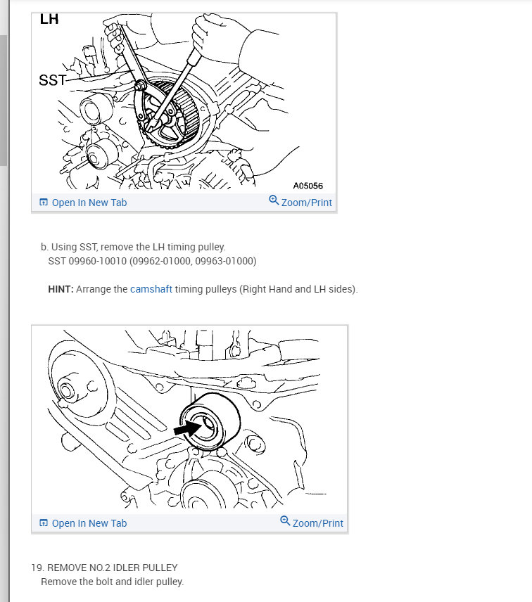

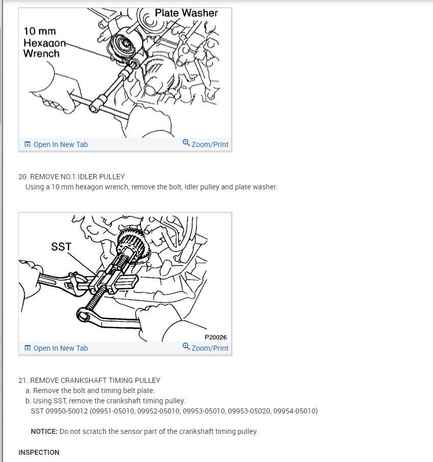

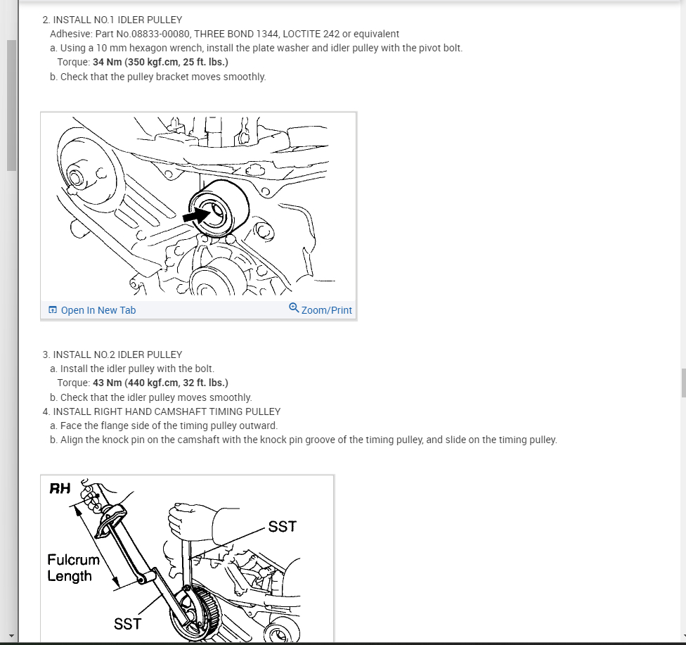

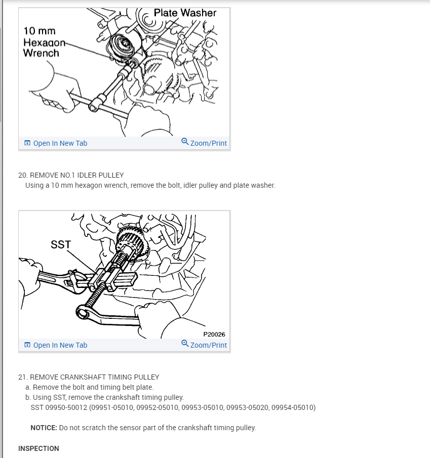

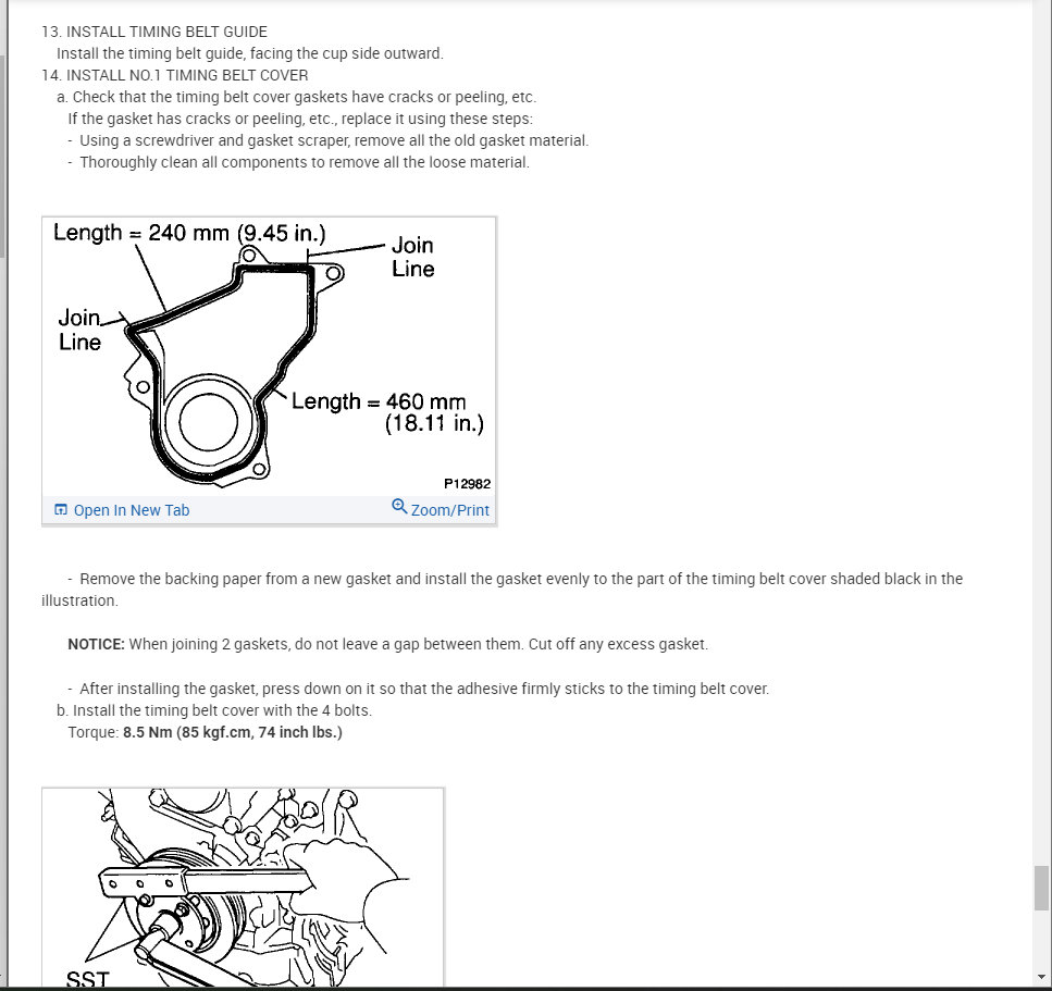

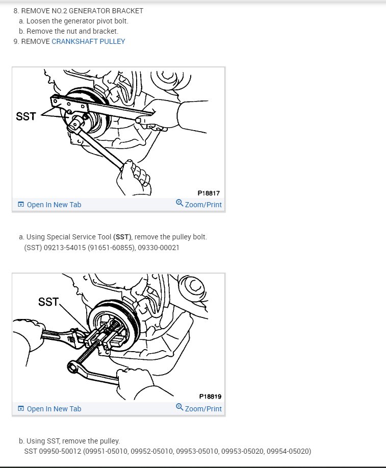

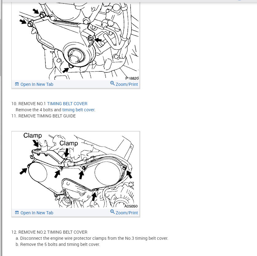

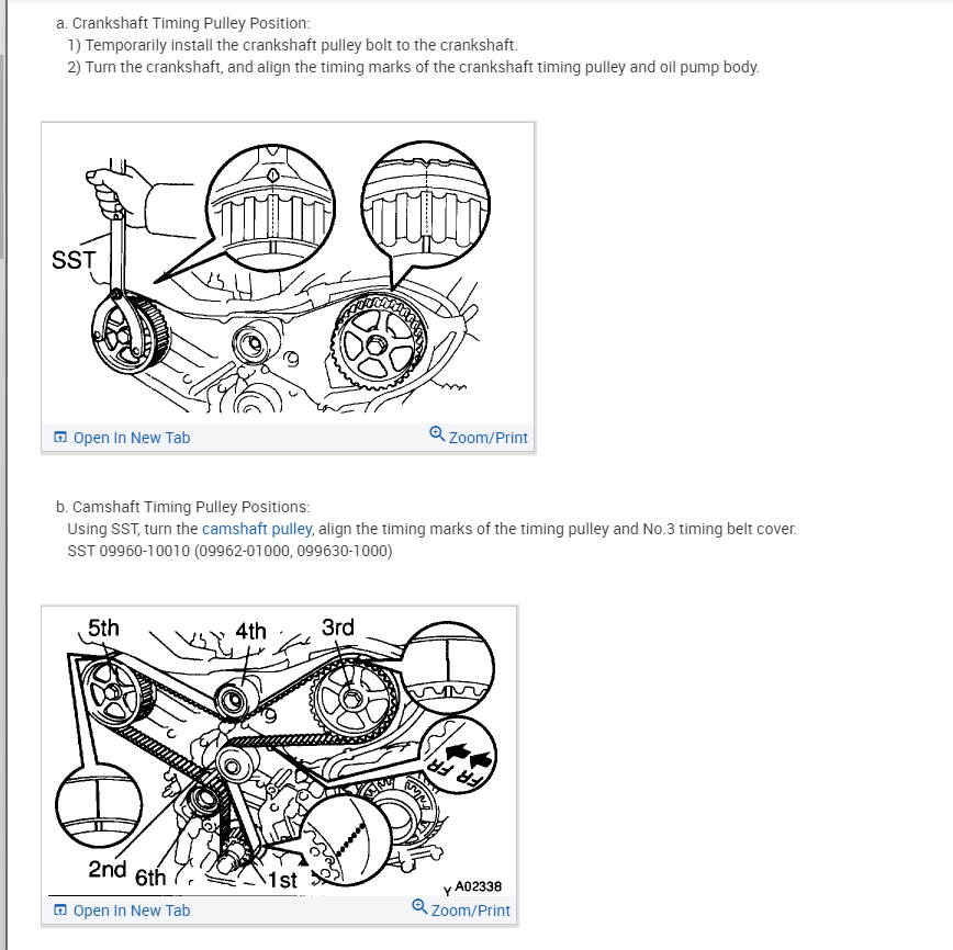

I am attaching the info below on how to change the timing belt. If it were me and you have not changed the belt, then it is past due, and I would suggest doing this and setting the timing correctly.
Please run through this and let us know what you find. Thanks
