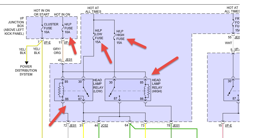

i want to ask you about the reason of projector light is not working. fuse problem or other reason. if fuse where is the position?
