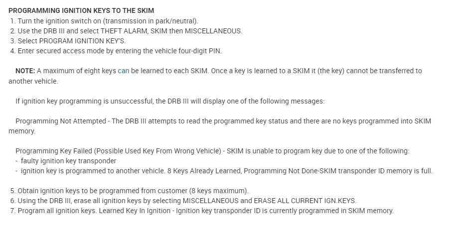

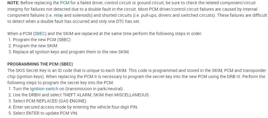

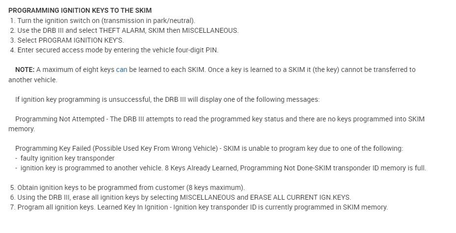

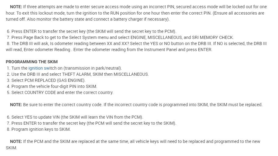

I attached the procedure for the process. You need a DRB scan tool to complete the procedure.
If you do not have one, call a locksmith and they can come to you and do the programming.

Hi Roy.I was reading here about a member turning his key to the on position for an hour then try programming it and I did that and it worked.I was able to program my new key to the car and now it runs.thanks again 2CarPros.
