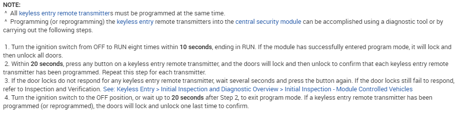

If the vehicle has an aftermarket alarm tied into the system it could cause an issue because the gem module needs to see an off and on voltage change in order to enter programming mode. If the vehicle does not have an aftermarket alarm tied in, the next course of action would be to retrieve codes from the gem module because there could be a fault that is not allowing the module to enter programming mode, like an alarm activation that was not disabled by a remote or a door ajar switch faulty. I attached the procedure just to be sure you have the same thing.
