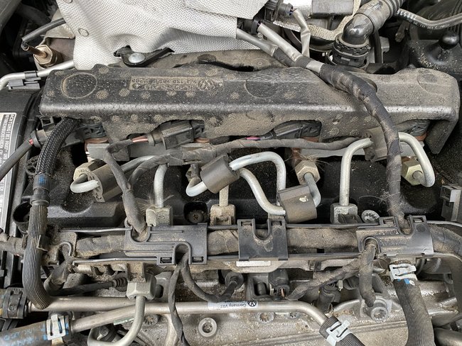

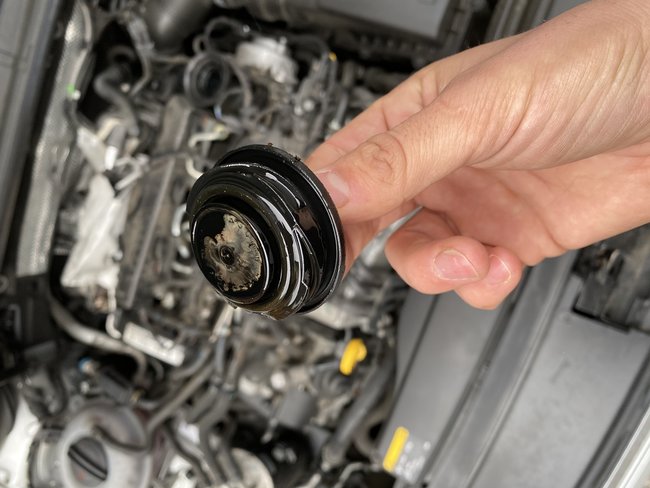

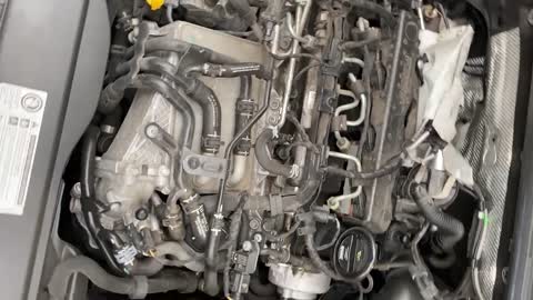

Hello all, i am looking to purchase the car listed above 2.0 diesel. The inside and outside of the car was spotless and very well taken care of. Under the hood i found a few red flags (to my knowledge) i think it's mixing either oil with water or diesel fuel. I will upload a few photos and please any suggestions will help. PS, notice the engine is a bit wet with diesel fuel.

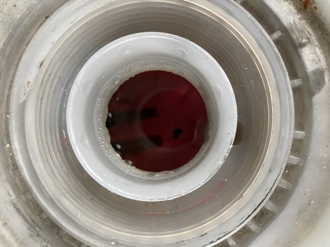

However, the picture of the coolant appears to be fine as it looks clean and red. The oil cap appears to have something on it which would give me pause. However, if we can do two tests that will put all this to rest. First is a head gasket test. Here is a guide for that:

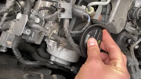

Hello, thank you very much for your reply. Unfortunately i do not have the resources to do neither tests! About the oil cap, i checked it while the engine was cold and it had absolutely nothing but then after about a 30 minute test drive the engine was warmed up, only then this appeared as shown in the photos. Were you able to notice the diesel fuel all over the engine? it's a bit difficult to notice on the picture!
Dec 7, 2020 at 9:51 AM
Interesting. Unless you are getting a good deal on it and without running those tests, I would pass. If it was not there before and the smoke started after it got hot. Then I would think it has a head gasket issue. I did not see the fuel on the engine but that is just another red flag. Again, if the price is right this is not anything that can't be fixed but I would not pay full price.
