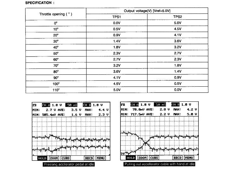

The Electronic Throttle Control (ETC) system is made of the components throttle body, Throttle Position Sensor (TPS) 1 & 2 and Accelerator Position Sensor (APS) 1 & 2. TPS 1 & 2 are sharing the same source voltage and ground The throttle valve opening is control by throttle motor which is controlled by Engine Control Module (ECM). The opposite position indicator shows inverted signal characteristics. TPS 1 output voltage increases smoothly in proportion with the throttle valve opening angle after starting. TPS 2 output voltage decreases in inverse proportion with the throttle valve opening angle after starting. TPS provides feedback to the ECM to control the throttle motor in order to control the throttle valve opening angle properly in response to the driving condition.(check pic1)

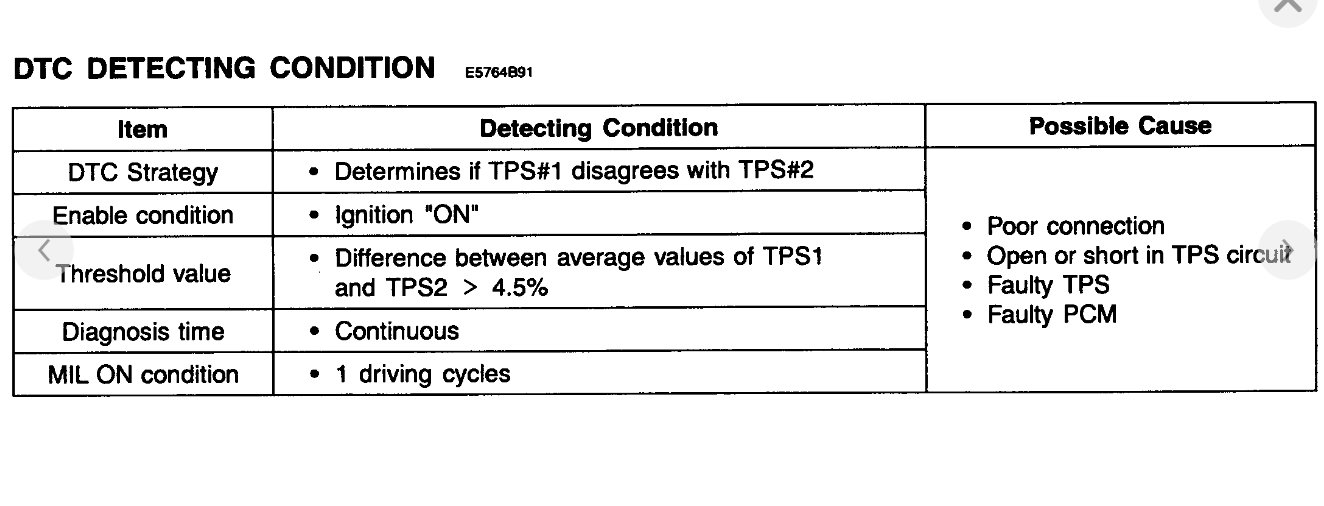

DTC DESCRIPTION
Checking output signals from TPS 1 and 2 under detecting condition, if output signals difference between TPS 1 and TP S2 are detected more than 4.5% for the specified number of times., PCM sets P2135. And then MIL (Malfunction Indication Lamp) turns on.(check pic2)

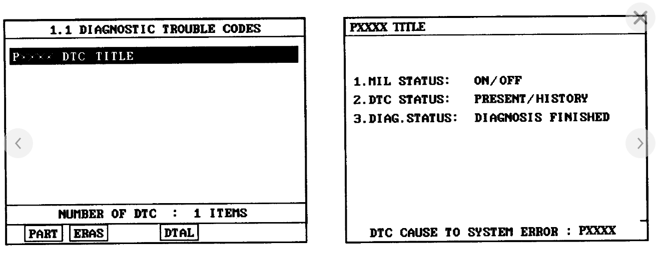

1. Check DTC Status
1. Connect scantool to Data Link Connector (DLC).
2. IG "ON".
3. Select "Diagnostic Trouble Codes (DTCs)" mode, and then Press F4 (DTAL) to check DTC's information from the DTCs menu
4. Read "DTC Status" parameter.(checkpic3)
5. Is parameter displayed "Present fault"?

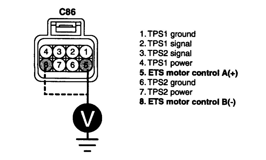

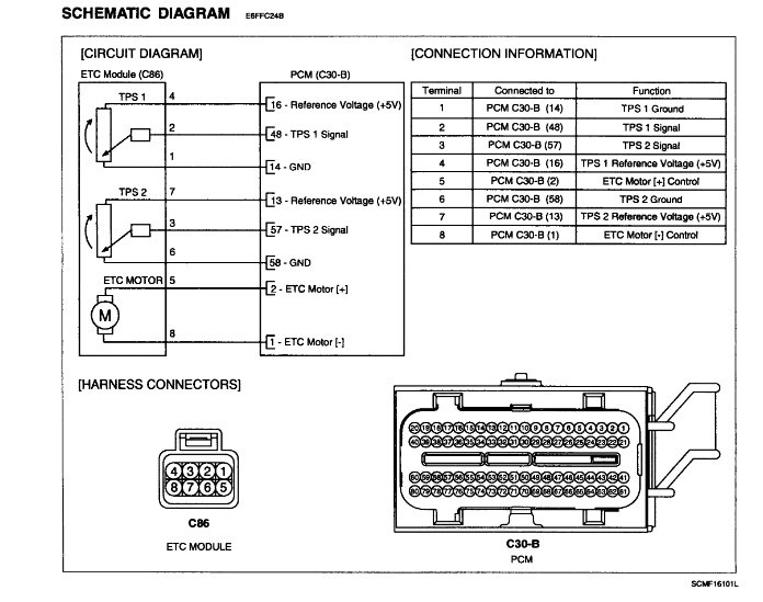

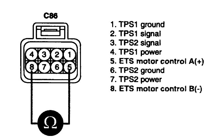

POWER CIRCUIT INSPECTION(pic4)
1. IG "OFF".
2. Disconnect TPS connector.
3. IG "ON" & ENG "OFF".
4. Measure voltage between terminal 4 of TPS harness connector and chassis ground.
5. Measure voltage between terminal 7 of TPS harness connector and chassis ground.
Specification : Approx. 5 V
6. Is the measured voltage within specification ?
YES - Go to "Signal Circuit Inspection" procedure.
NO - Repair or replace as necessary and then, go to "Verification of Vehicle Repair" procedure.

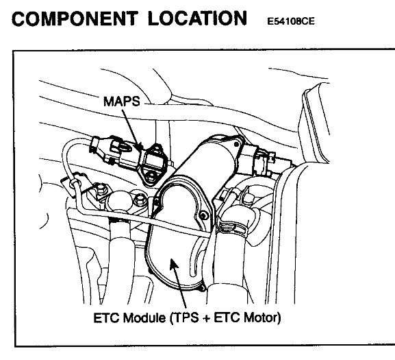

COMPONENT INSPECTION(pic5)
1. Check TPS
1. Ignition "ON" & ENG "OFF".
2. Monitor signal waveform of TPS by stepping on and oft the accelerator pedal on scantool
3. Is the measured signal waveform O.K?
YES - Substitute with a known-good PCM and check for proper operation. If the problem is corrected, replace PCM and then go to "Verification of Vehicle Repair" procedure.
NOTE: There is a memory reset function on scantool that can erase optional parts automatically detected and memorized by PCM.
Before or after testing PCM on the vehicle, use this function to reuse the PCM on the others.
NO - Substitute with a known-good TPS and check for proper operation. If the problem is corrected, replace TPS and then go to "Verification of Vehicle Repair" procedure.

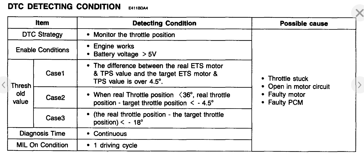

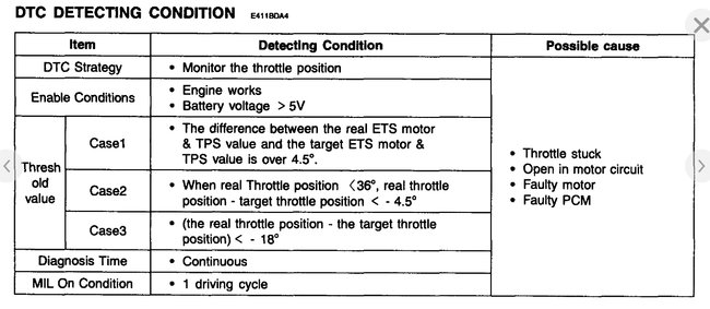

for the fault code p0638.
DTC DESCRIPTION
Checking output signals from TPS under detecting condition, if the difference between real and target throttle position is above the specified value, PCM sets P0638 and then MIL (Malfunction Indication Lamp) turns on.(pic6)

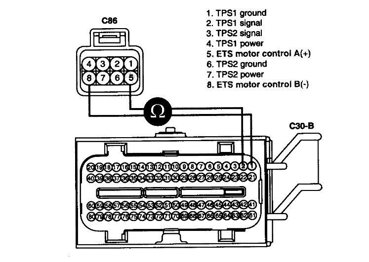

2. Check open in harness(pic8)
1. IG "OFF"
2. Disconnect ETS motor & TPS connector and PCM connector.
3. Measure the resistance between terminal 5 of ETS motor & TPS harness connector and terminal 2 of PCM harness connector.
4. Measure the resistance between terminal 8 of ETS motor & TPS harness connector and terminal 1 of PCM harness connector.
Specification : Approx. below 1 ohm
5. Is the measured resistance within specification ?
YES - Go to "Component inspection" procedure.
NO - Repair Open in motor harness and go to "Verification of Vehicle Repair" procedure.

2. Check ETS motor resistance(pic9)
1. IG "OFF".
2. Disconnect ETS motor & TPS connector.
3. Measure the resistance between terminal 5 and 8 of ETS motor & TPS connector (component side).
Specification : Approx. 1.275 - 1.725 ohms @ 23 °C (73.4 °F)

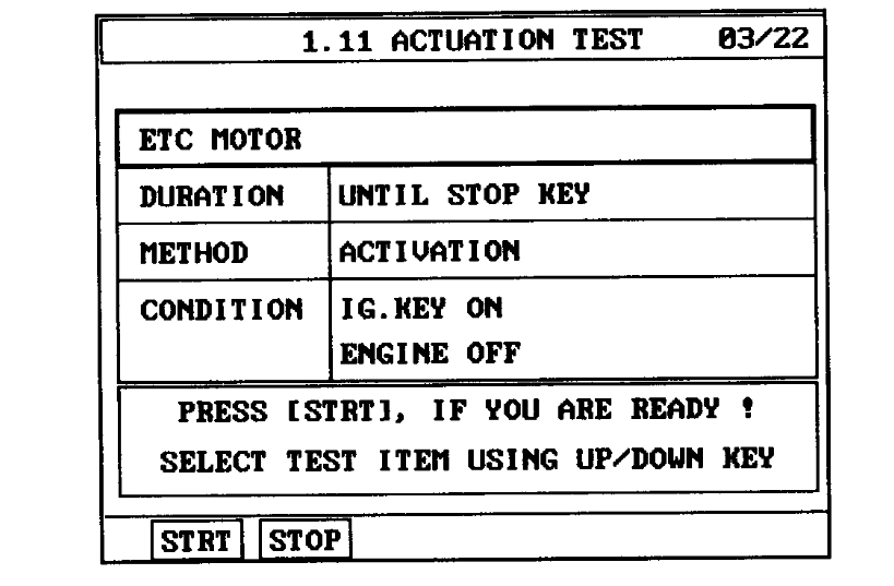

3. ETC motor actuation test(pic10)
1. IG "OFF".
2. Connect ETS motor & TPS connector.
3. After IG "ON", execute the "ETC motor actuation test" by Scantool.
4. Does the "ETC motor actuation test" execute normally?
YES - Substitute with a known - good PCM and check for proper operation. If the problem is corrected, replace PCM and go to "Verification of Vehicle Repair" procedure.
NO - Substitute with a known - good ETC motor and check for proper operation. If the problem is corrected, replace ETC motor and go to "Verification of Vehicle Repair" procedure.
