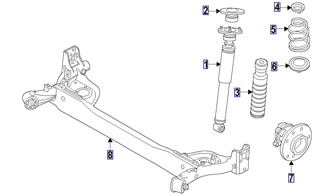

As far as replacing it, the manual parts are not really hard but the factory data assumes you are replacing the entire rear axle as an assembly with new hubs, brakes and all of that attached. In your case I would try to reuse all of that if possible which is why you need to know what is wrong. Wouldn't help you to replace the axle beam if the problem is really something else.
1. Remove the reservoir cap from the reservoir tank.
2. Remove the rear wheels and tires.
3. Loosen the flare nuts on the brake lines,
4. Remove the rear drum brake assembly.
5. Separate the parking brake cable (RH/LH) from the rear suspension beam and position the rear drum brake back plate (RH/LH) aside with wire. Refer to Exploded View.
6. Separate the brake hose (RH/LH) and the brake tube (RH/LH) from the rear suspension beam. Refer to .Exploded View.
7. Disconnect the harness connector from the wheel sensor (RH/LH). Refer to Exploded View.
8. Position a suitable jack under rear suspension beam.
Place the jack in the center of the suspension beam.
Do not damage the suspension beam with jack.
9. Separate the shock absorber (RH/LH) from the rear suspension beam and remove the coil spring (RH/LH).
Make sure the rear suspension beam is stable when using the jack.
10. Remove the rear suspension beam bolts.
11. Slowly lower jack, remove rear suspension beam from vehicle.
