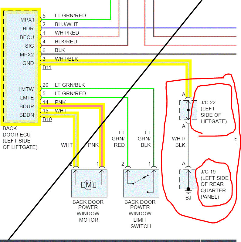

Rear lift gate window only goes up
2002 TOYOTA SEQUOIA
170,000 MILES • 4.7L • V8 • 4WD • AUTOMATIC
BLOCKWOOD
Key switch, remote and power window switch won't lower rear window. But rear window will lower if connected directly to -12V. Rear wiper is possessed. Turns on and off from the driver control but stops anyplace it likes. Shaft is bent and the splines are stripped so I've been testing it with the wiper arm off. I ordered a new wiper motor and arm but I don't feel confident I can get the window to go down with the controls.
Jan 29, 2020 at 5:37 PM

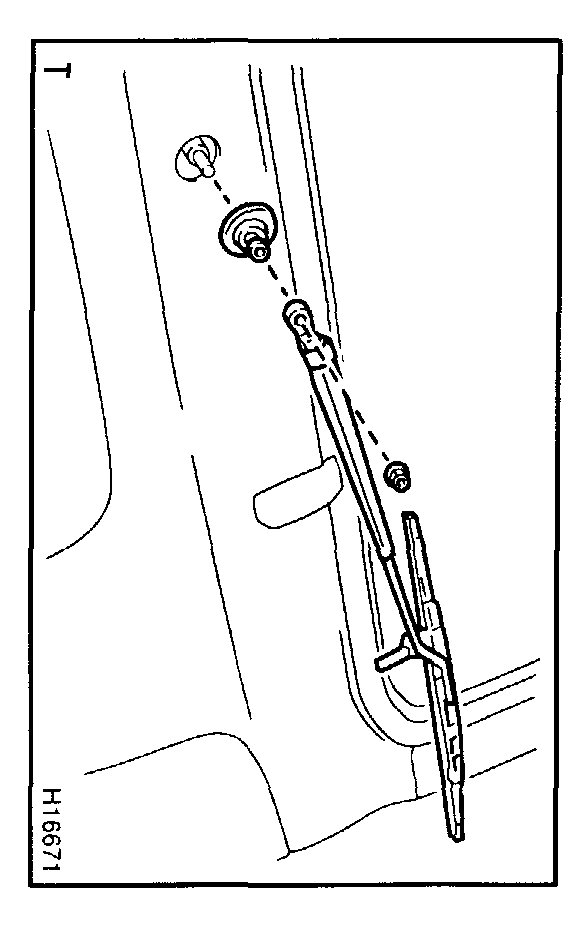

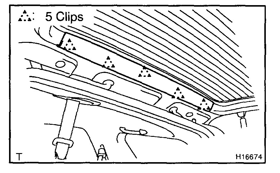

The window motor sounds good. So, the first thing I need you to check is to make sure the ground is good. I attached a pic from the wiring schematic which indicates two locations to check. Do this first and let me know what you find. (See Picture 1)

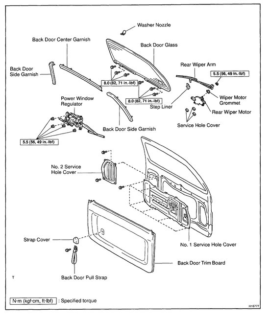

I don't know if you need them, but here are the directions for replacing the rear wiper motor. The remaining pictures correlate with the directions.
____________________

Pic
REMOVAL
1. REMOVE REAR WIPER ARM

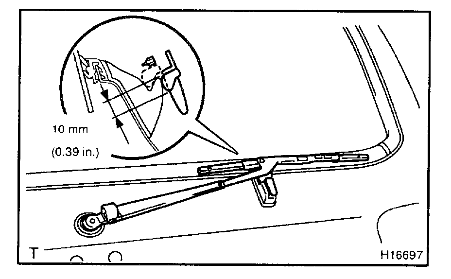

pic 3
a. Open the cover.
b. Remove the nut and rear wiper arm.
Torque: 5.5 N.m (56 kgf.cm, 49 in.lbf)

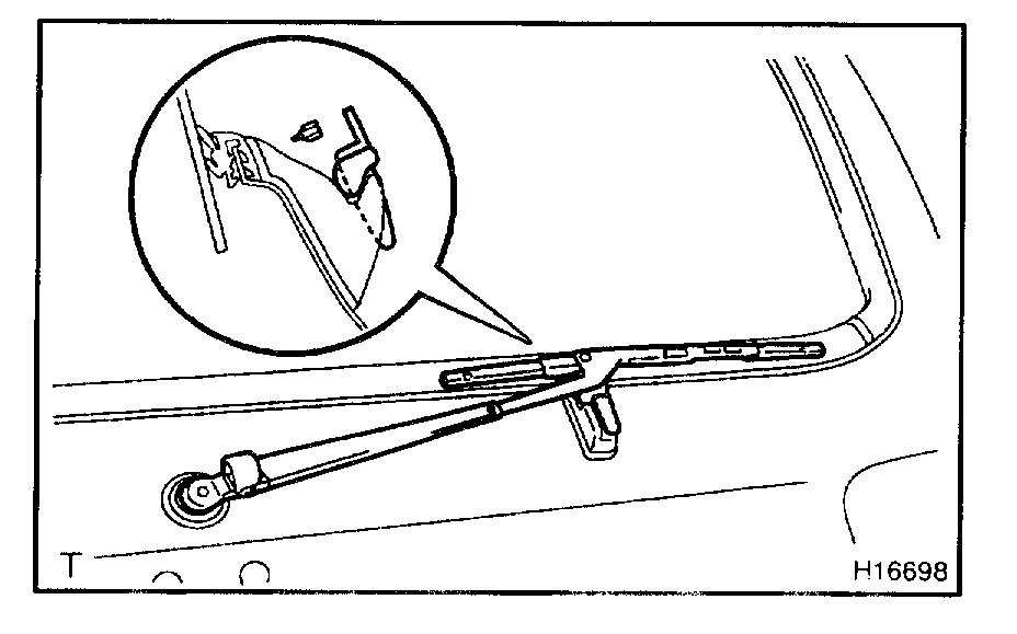

c. Remove the rear wiper motor grommet.
pic 4

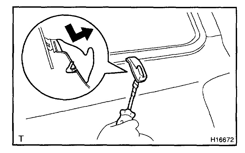

2. REMOVE STEP LINER
Using a screwdriver, remove the step liner.
HINT: Tape the screwdriver tip before use.

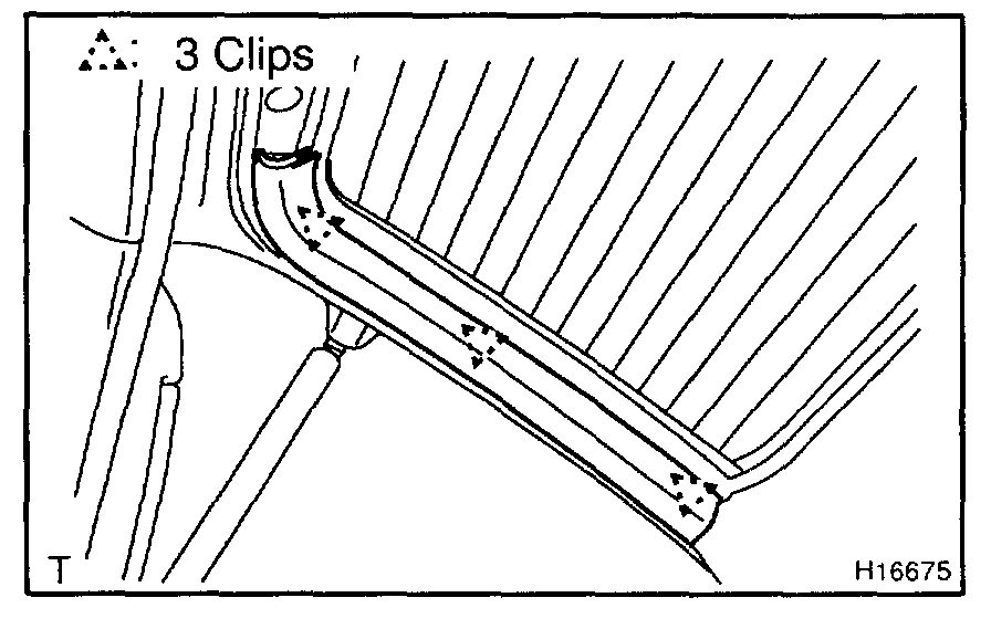

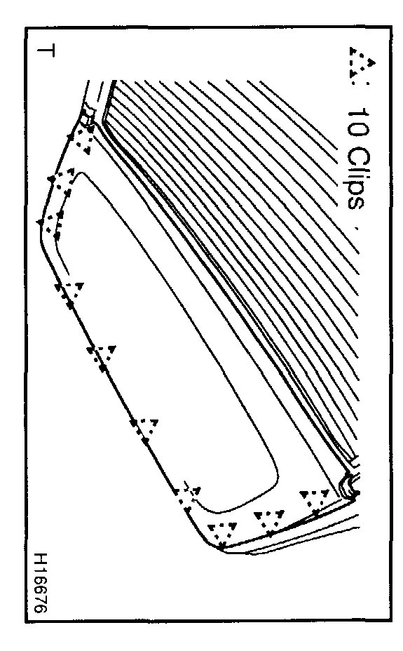

4. REMOVE BACK DOOR CENTER GARNISH
Using a screwdriver, remove the back door center garnish.
5. REMOVE BACK DOOR SIDE GARNISH
pic 6
a. Using a screwdriver, remove the back door side garnish.
b. Employ the same manner described above to the other side.

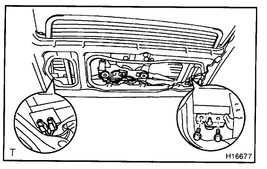

7. REMOVE NO.1 SERVICE HOLE COVER
8. REMOVE NO.2 SERVICE HOLE COVER

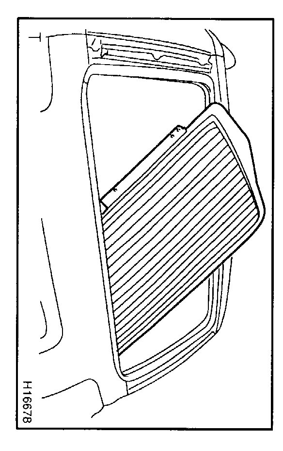

9. REMOVE BACK DOOR GLASS
pic 8
a. Open the back door glass until the bolts appear in the service hole.
b. Disconnect the connector.
c. Remove the 2 bolts and guide bracket.
pic 9
d. Remove the 4 bolts and back door glass as shown in the illustration.
NOTE: Be careful not to drop the back door glass.

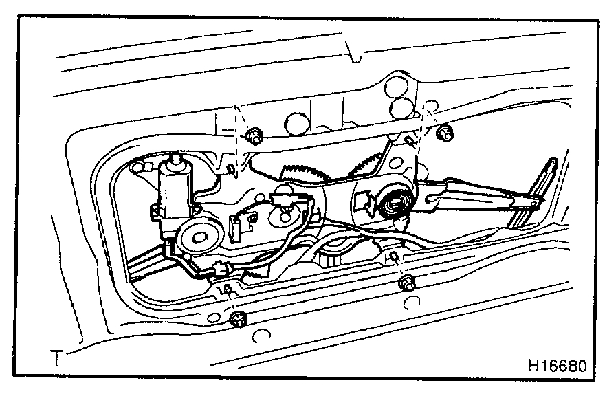

10. REMOVE POWER WINDOW REGULATOR
pic 10
a. Disconnect the connector.
b. Disengage the connector and clamp.
c. Remove the 4 nuts and power window regulator.
HINT: Remove the power window regulator through the service hole.

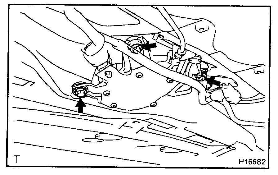

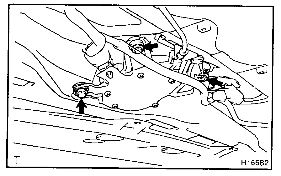

11. REMOVE REAR WIPER MOTOR
pic 11
c. Remove the service hole plug.
d. Unfasten the 3 bolts, then remove the rear wiper motor.

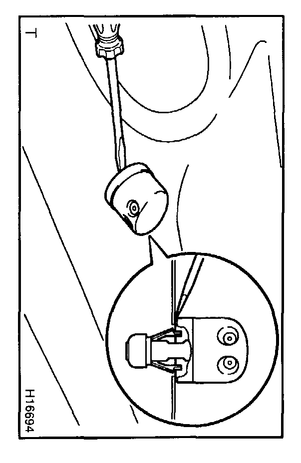

12. REMOVE WASHER NOZZLE
pic 12
a. Using a screwdriver, remove the washer nozzle.
b. Disconnect the washer hose.

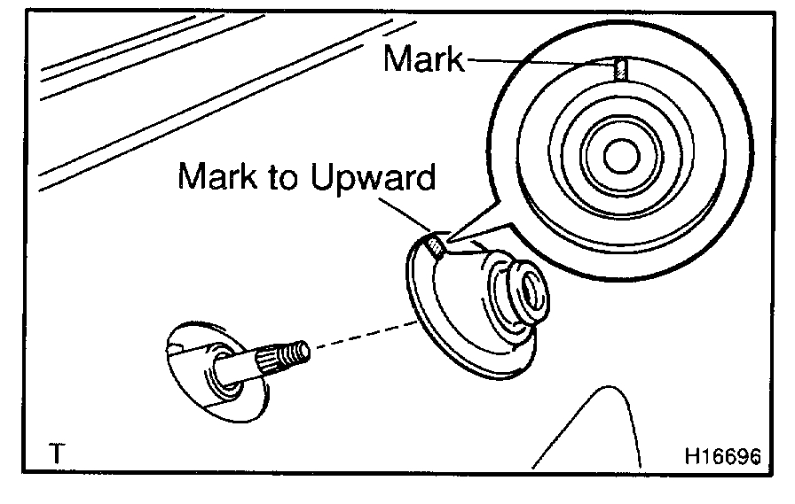

12. INSTALL REAR WIPER ARM
a. Install the rear wiper motor grommet as shown in the Illustration.
b. Operate the wiper once and turn the wiper switch OFF.
pic 14
c. Install the wiper arm as shown in the illustration, then torque the nut.
