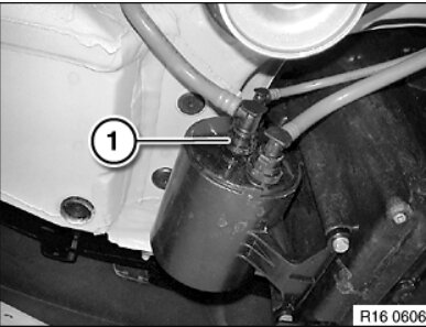

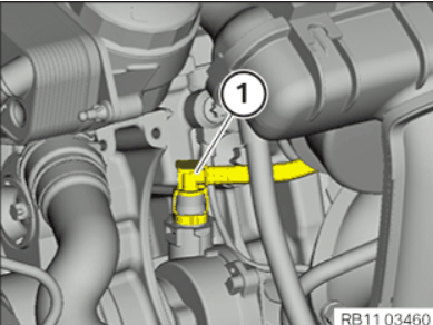

I have also seen the O ring at the 90 degree elbow leak, here is the location of both so you can check it out. Check out the images (below). Please let us know what happens.
