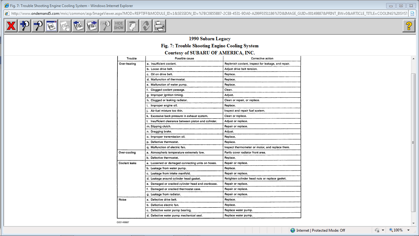

Car overheated, did a exhaust gas combustion test and it showed to be positive. Pulled engine removed heads had them leak checked surfaced and valves ground. Replaced all needed gaskets and seals, coated head gaskets with copper coat and torqued heads properly. Replaced engine, evacuated the cooling system with a vacuum coolant tool it held 30 inches of vacuum for as long as I wanted to let it, filled the system with the proper mix and it still overheats. New water pump new thermostat new timing set and a new radiator.
